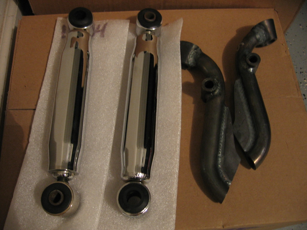

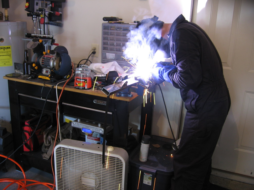

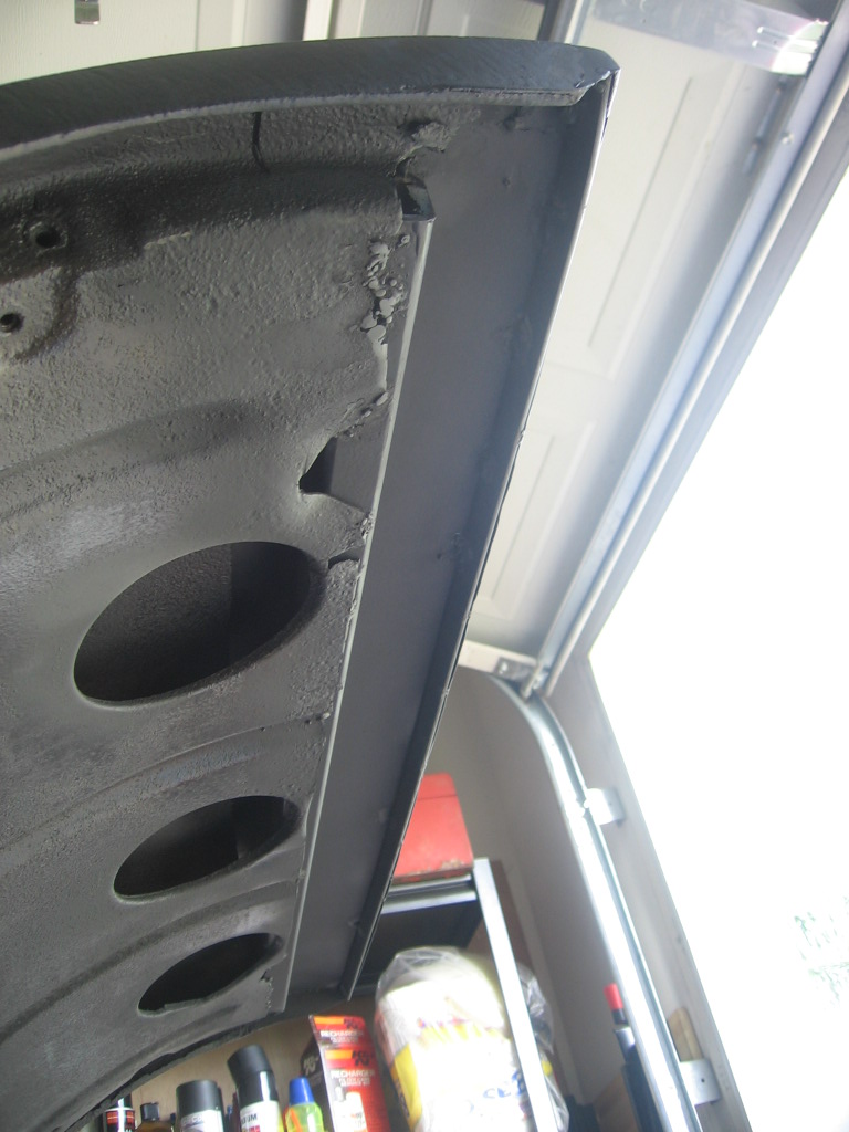

    Got some good work done on the coupe today...got the some strengthening done on the decklid too and while I was working the ups man showed up. Sweet! See if anyone can find the significance of the work bench picture?????
    Got my weld on front shock/headlight mounts "pete & jakes" and some chrome pete and jake front shocks! That should finish up the front suspension! Fire station tommorow and then saturday try to get some thrashing done!
    Still trying to find out how much a spring behind system adds to my wheelbase!!!

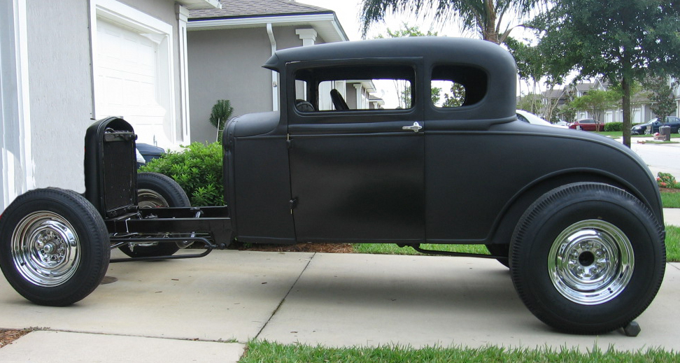

    Quick photoshop of the extra chunk of frame cut out at the firewall..[​IMG]

  22. skunx1964
    Joined: Aug 21, 2008
    Posts: 1,455
    skunx1964
    damn evel, that looks just about right! cept now he needs to get that front tire shaved back round ;)

    The rear suspension is mounted way back!!! I got to measuring last night and its like 116 inch wheel base YUCK! The thing is like i said the rearend is mounted way too far back. I dont think the frame is too long I just think that the "previous owner" mounted the rearend setup too far back. The frame can come back like 12 inches in the trunk if need be so thats no problem. My only question would be what should I kick it down to? 106 inch wheelbase and if so whats a good measurment to have firewall to radiator? I dont want to go too much but then again i dont want it to look like a ol rail dragster either! You guys have been such a big help already!

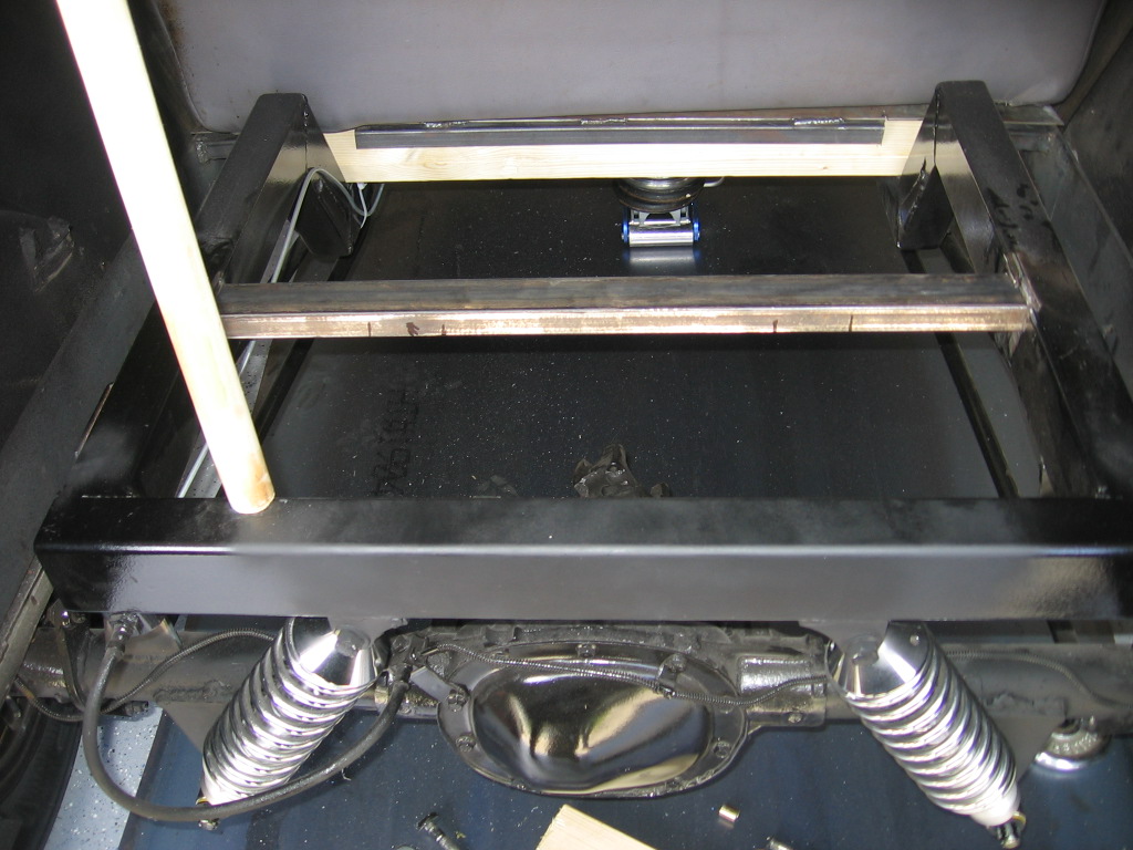

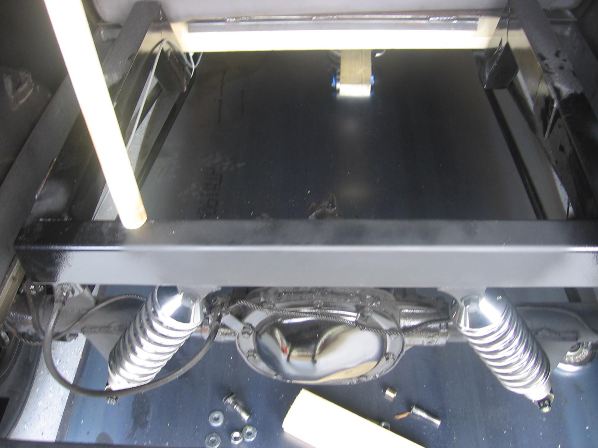

    Well just got in from the garage!!! Over 8 hrs of work today in the garage non stop...no food or anything maybe a couple beers. Dad came over and lent me a hand, much appreciated! Got sooooooo much done today!!!! Starting with
    1) upper headlight/shock mounts modified and welded on
    2) made lower shock mounts from scratch (Also welded on)
    3) got the frame all measured up (116 inch wheelbase YUCK)
    4) created new rear crossmember/shock mount from scratch
    5) got all coilover tabs welded up to new rear crossmember
    6) cut rear hairpins and moved up and rewelded to frame
    7) cut mount for panhard bar and moved it up to new location on frame
    8) all rear suspension/rear cut and moved to new location and rewelded
    9) new wheelbase=106 inched and looks bad***!!!!!!
    10) got body moved up to new location!!!!
    Got so much stuff done today with help from my pops....long long long day but well worth it. Now I can start work on my floors etc. Body is sitting on piece of 2x4 so the body doesnt touch so these pics ARE NOT the ride height the car will be at....but overall when my wife and mom came outside she said wow is that the same car? Exactly what I wanted to hear!!!! Let me know what you think! This project is REALLY coming along! (Ribs and a special beans recipe waiting when I got out of the shower!)

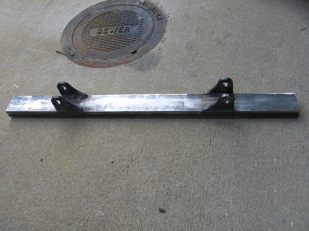

    New rear crossmember....
