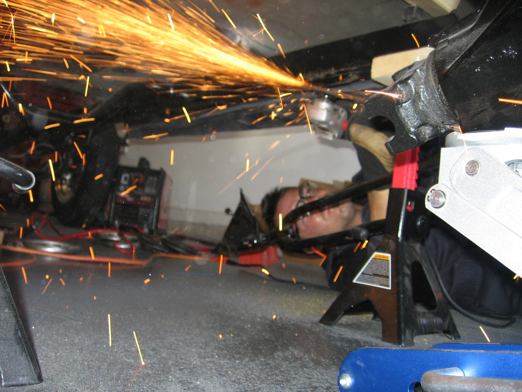

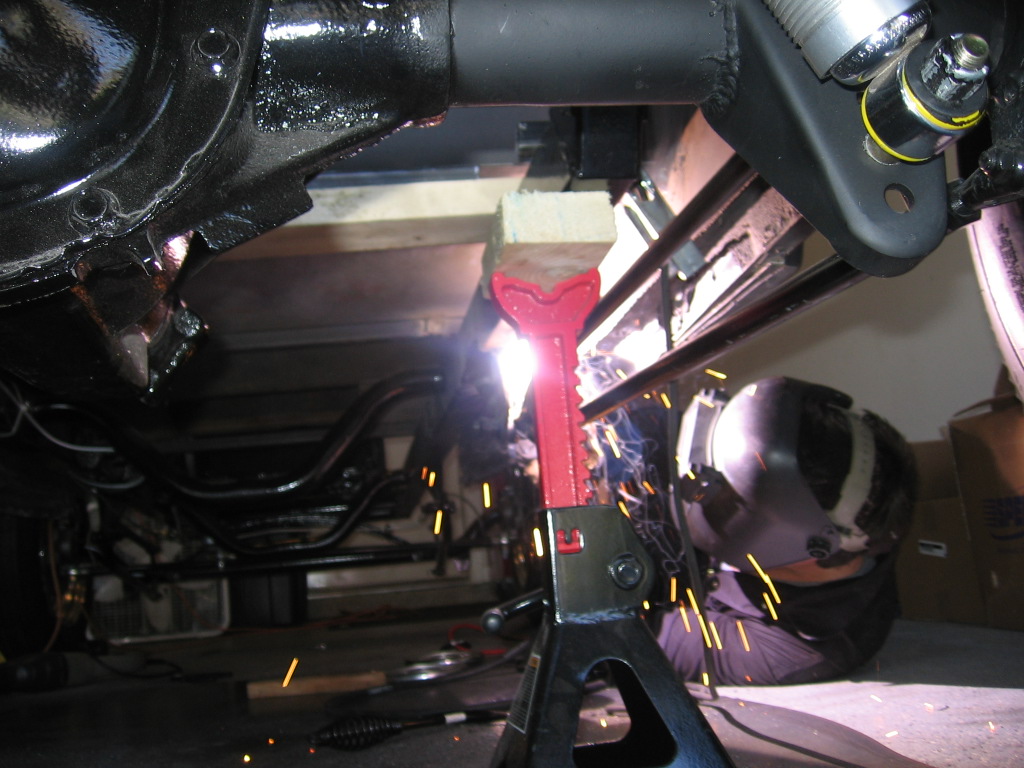

    Changing wheelbase from 116 to 106! Lot of work but worth it!

    Oh and next is off to start floors, fix channel and remount radiatior and grill shell for body move!
    Couldnt do any of this without my pops

    Alot of work....but very very very worth it. The new look of the car is very inspirational for my build! Next its off to floors/fix channel and moving the radiator. What kind of clearance do I need with or without electric fan? 32" I have heard numerous times for sbc.....what are your guys clearances for the engine compartment with fan and with electric fan.....THANKS again for all the help guys!

    I have about 1/2" to 3/4" clearance for my mechanical fan...

    tried to get you a pic, but the motor is a *********** of accessories and bs, so its kinda hard to see. this 1973 307 is 32in from trans mating surface to the tips of the fan. it has a long pump setup, and a 1.5in spacer on the fan to keep from tickin the pulleys and alt/powersteering junk. with a short pump setup and simple pulleys you could prolly cut 2 or 3in from the whole length. ill try and get a pic and measurements of my 58s motor setup, its prolly closer to what youll be running..... ill be back later

    ok, heres the simple measurements. you can shave more than i thought! the 355 in the 58 is about 28.5 from the trans surface to the fan bolts. its a short pump, single groove pulley setup, and no spacer on the fan. whens the social d show, didnt hear about it? they not playin orlando?

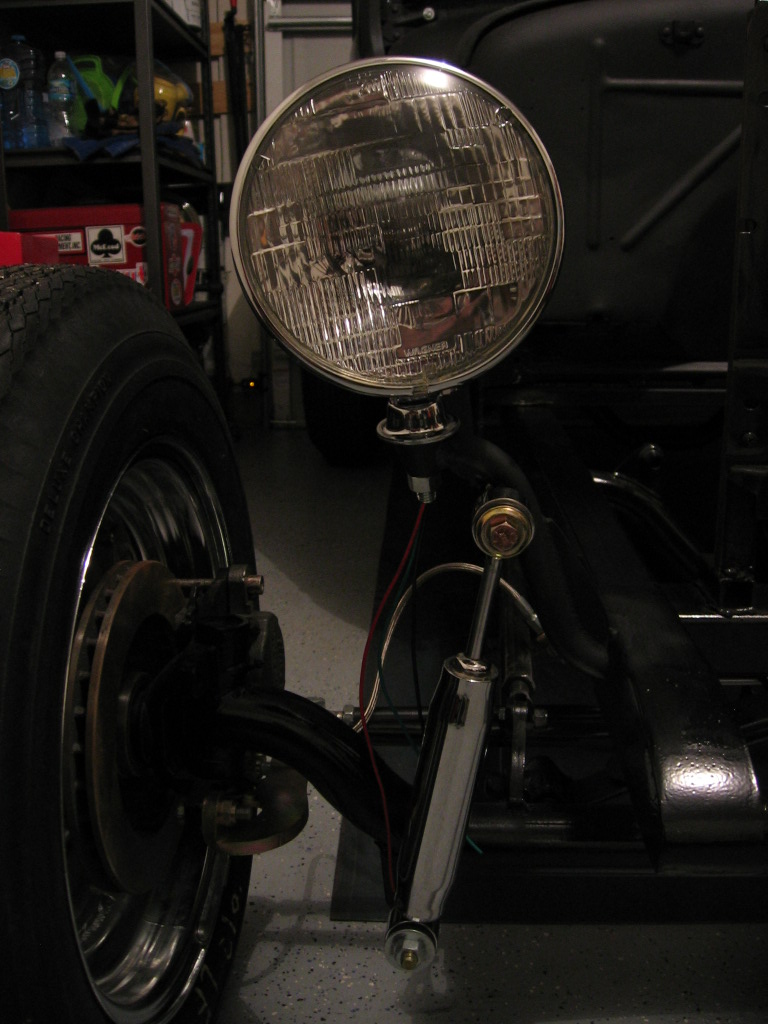

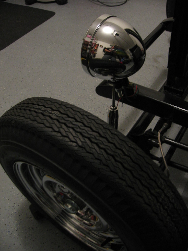

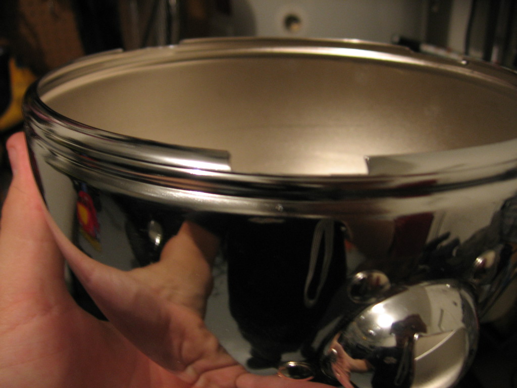

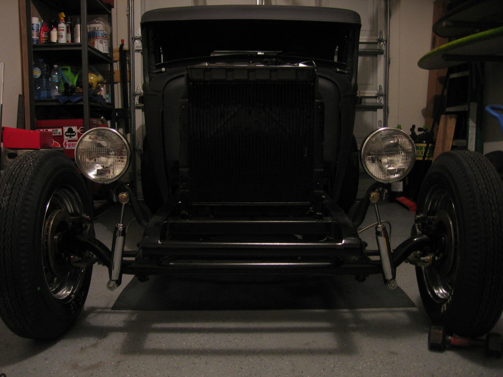

    Well just got in from the garage! Got some small stuff done tonight with the little time that I had. Got the front shocks all bolted up and the headlights all finished up. First pic is how the headlight turned out so I had to take it apart and modify them a little bit to get the light face straight on the weld on upper mounts but well worth it. Its all in the details people may not have noticed but I deff. would! Also got the steering column and wheel together for you to see. Saturday should be another big thrash day...try to get the body sitting right and much more:D

    Where did you get these headlights from??
  27. WhiteDevil
    Joined: Jun 22, 2009
    Posts: 707
    WhiteDevil
    The headlights are from speedway....yeah works coming along should have alot more pics this weekend
