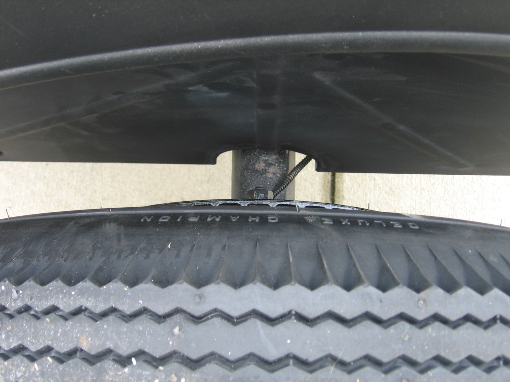

    Well just got in from another half day in the shop "1 car garage" :D Didnt get as much work done as last weekend but got some stuff that needed to be done. Formed and bent a piece of metal and got the front firewall patched in a spot that needed it badly. Got started added strength in the truck. Also got my rear fender cutouts done so the car could sit at the height I wanted. My dad then hand shaped two U shaped metal strap to do the rear cutout right. One all formed up got em both welded in and really helped the strength and looked great too!!! Lowered the car to where I wanted and I said OH **** thats it!!!! Have to now finish the channel in the rear and get it all ****oned up but the ride height is level and exactly where I wanted which took alot of time to get right. Now the suspension travel also is great and doesnt hit the body thanks to the new cutouts! Doesnt seem like as much got done as last week but the wife had some stuff for me to do this morning like move furniture in the rain gotta love it. Well let me know what you think of the new ride height! I think its perfect with the new 106" wheelbase from last weekend.
    Pics 1 and 2 are before and after on the firewall patch
    The rest are getting the rear cutout done and how we made it look and work good

    Did you just grind the arc of the cutouts?? or did you use any fancy tool to do this??

    The pic of the cutout is not after it was totally grinded smooth. Forgot to take another picture "was ready to be done, florida's HOT" It looked great when it was all finished. I was just using a grinder to clean it up no fancy tools

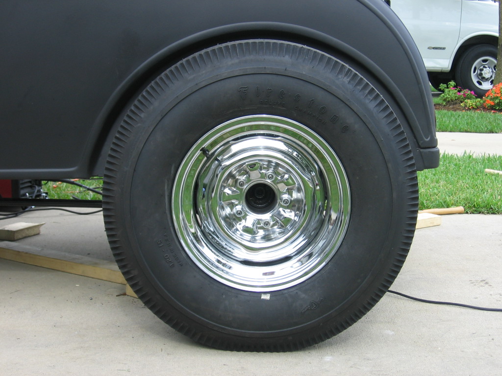

    Looking pretty sweet. I dig the blackwalls and Ford OEM chromies. I'm liking it so much, that I just might use those on my '31 coupe too.

    Thanks! It took me a while to decide on the wheel/tire combo but it was something you dont see alot or at least I didnt oem chrome with firestone blackwalls deff worth all the research.....look that I love...I have only seen it on the b*** coupe and I think a coupe others but mostly with piecrusts....

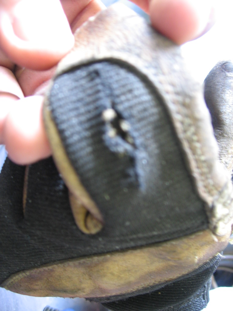

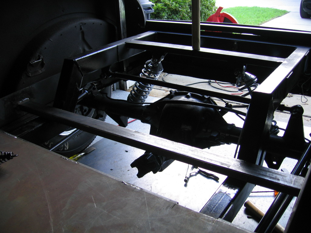

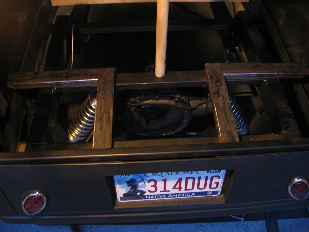

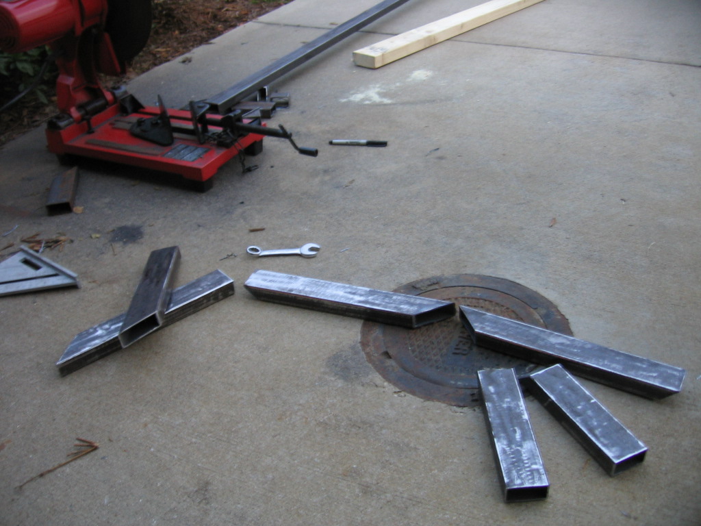

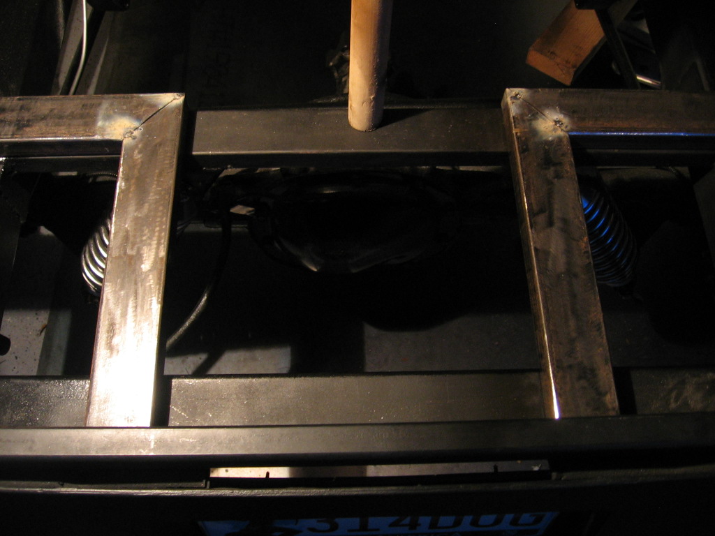

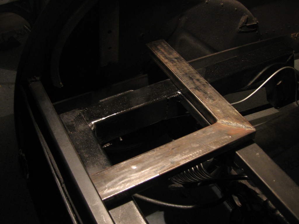

    Well got some work done tonight. I spent about 4 hrs in the garage and boy does it feel good to make some headway. I got the body final sitting at ride height on new 2x1 member all welded up. Also started getting really into the rear subframe with 2x1. Im going a route that I havent seen before so I will have room for my weld in battery box. Like I said its a little different and kind of a pain with ALOT of measuring and cutting...then cutting all the 45 degrees and making sure everything is square and level. So far im really proud of it though got alot of it welded up just need to finish welding it to the body.
    About halfway through the work my grinder turned on me and jumped up and bit me...felt really good! Good thing my wife thinks scars add character..and yes I was wearning gloves that now have a nice gash in em. Well heres some pictures.....

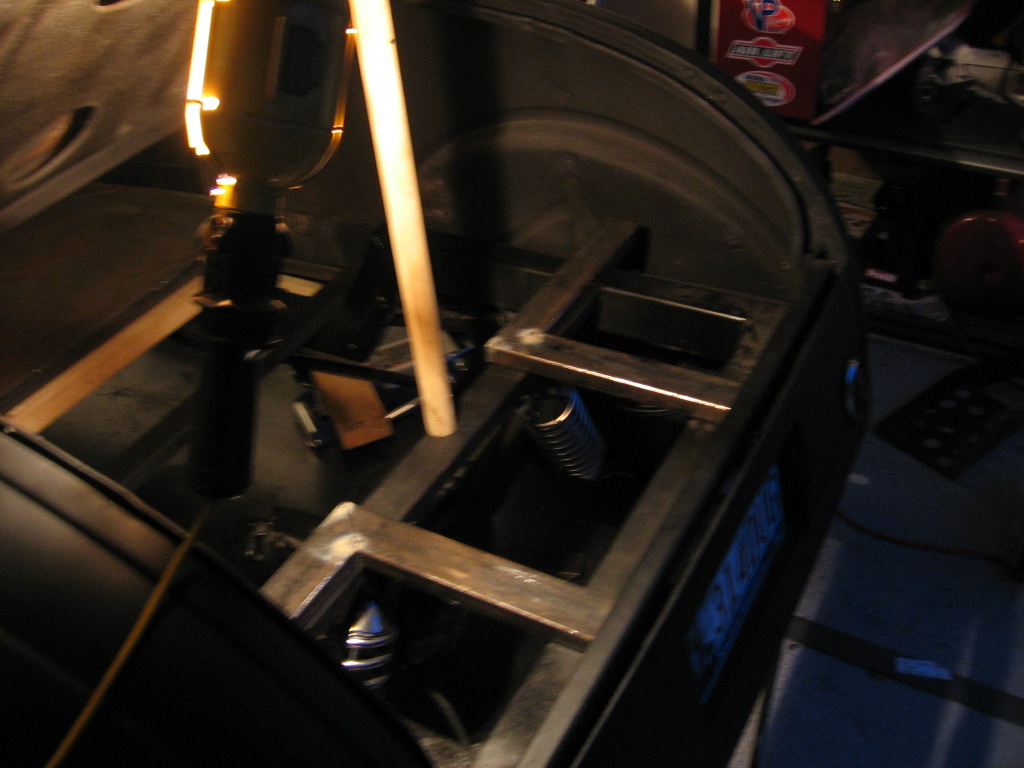

    Now to the pics of the work I got done on the rear "almost finished...

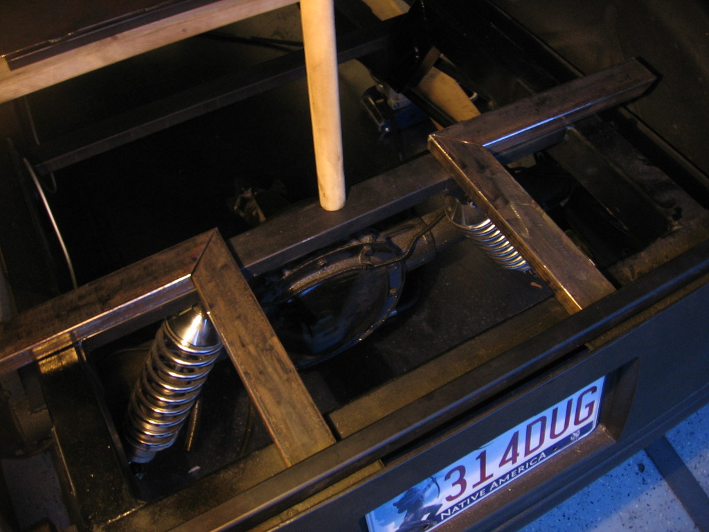

    Last ones...:D

    So you're putting the battery in on of the holes in the floor??
    What about the other side??
  25. I SMELL SMOKE

    The floor is coming out...its what the guy had in it before and its WAY too heavy....have to redo the front supports etc. The battery will be going in the back "the space that I left right behind the rear end where the open square is...thats why I did the rear open like that at the rails...for it to be layed out where I can put the battery down in there with a weld in box and the rear trunk floors can be flat......
