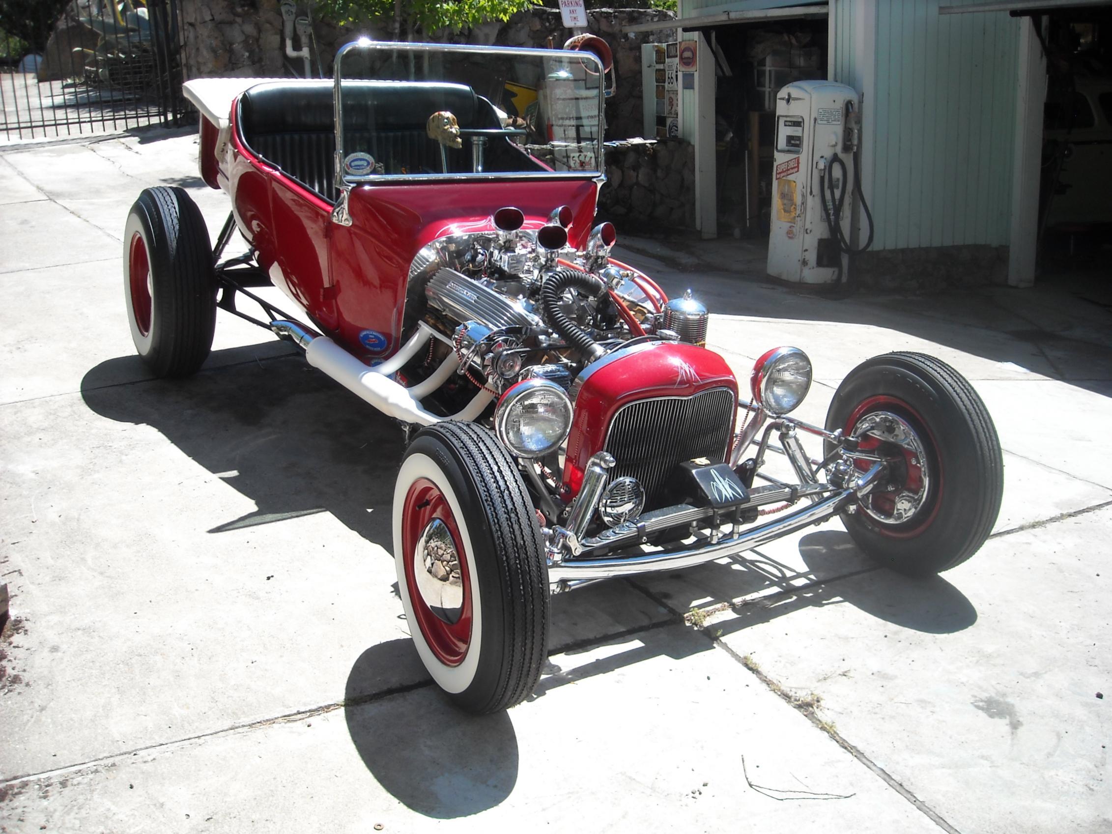

    Is there any place doing still doing alumaspray like in the '60s.? I'd like to have mine done like the orange one in the 65 photo,

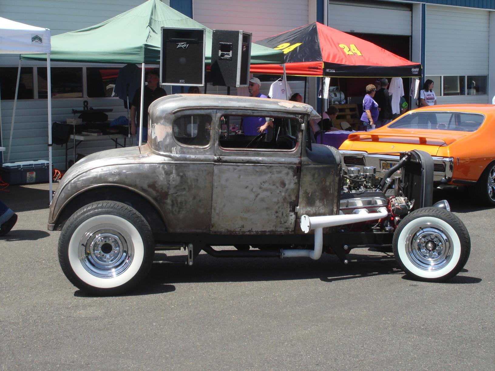

    Like many here have already stated high temp spray paint like VHT is the good old cheap and easy way.
    Another option that's not as expensive as a ceramic coating would be to have them aluminized. I had a set done in white 19 years ago and they've held up pretty well.
    Here's a picture and a link to a place that does it.
    http://www.pugetsoundcoatings.com/Metallizing/Metallizing.htm

    Thanks I was going to chrome them and I ran out of time before LARS and sprayed them white. I think I like the white better.
    There used to be a place in Oakland that did it. I think by the airport. I'll have to check.

    Rolleiflex
    Steel rebel,
    I like the white headers on your car as well, it looks really good. I think the white headers balance out well with your white top and tires.

    Thanks. The paint was new there. It burned off pretty soon, especially where I had used braze to smooth out the welds.
