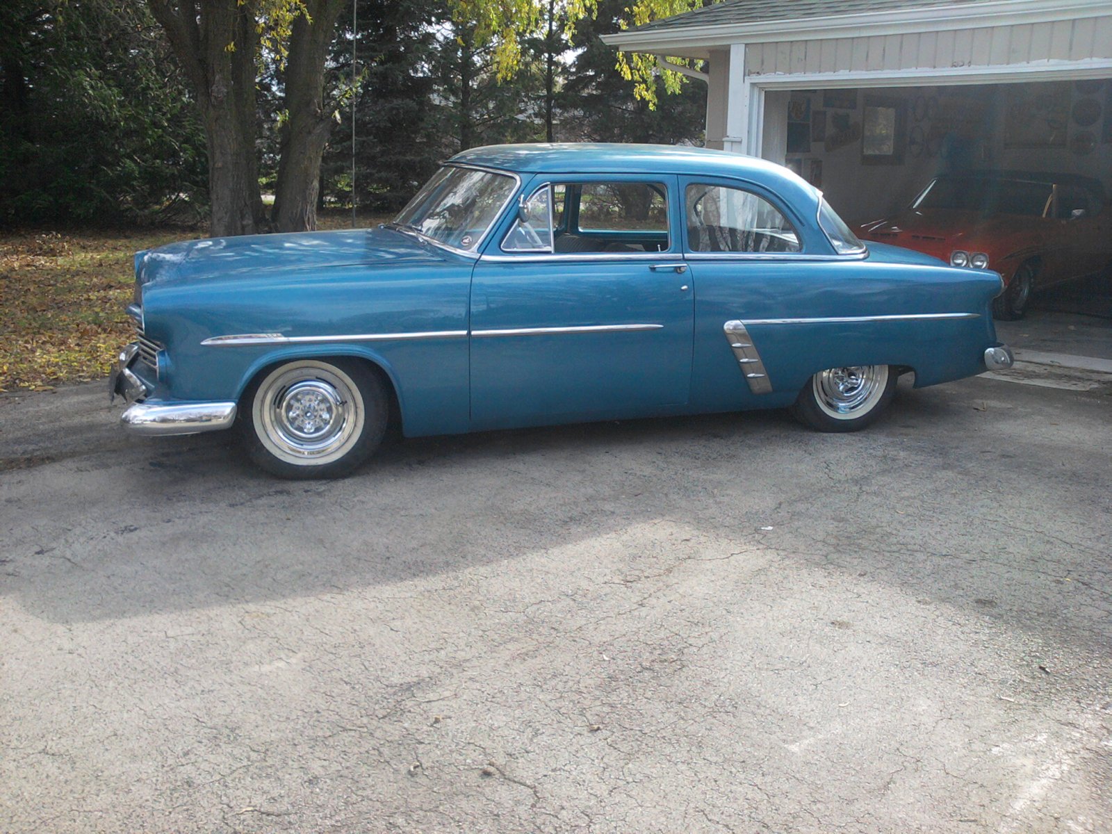

    I used to do this a lot, I used SealBest white elastomeric roof coating, for trailer roofs. I'd sand all the lettering down on the tire sidewall to smooth it out and I'd pick tires that had some kind of raised line to paint up to. Brushed it on. Takes a lot of coats, helps if the coating product is really old (it gets thick when it's been in the can for years), also helps if it's really, really hot outside and you do it in direct sunlight. Holds up way better than Porta-Walls.
    The result looks like a radial wide whitewall. The bias tires are more attractive for sure, but if you're broke and building on a shoestring budget it's OK. Tires on the '52 Ford were probably 6 or 7 years old when that pic was taken, tires on the '55 Dodge were more fresh. '52 is getting a set of "real ones" soon, '55 got sold years ago, but it worked for a while.

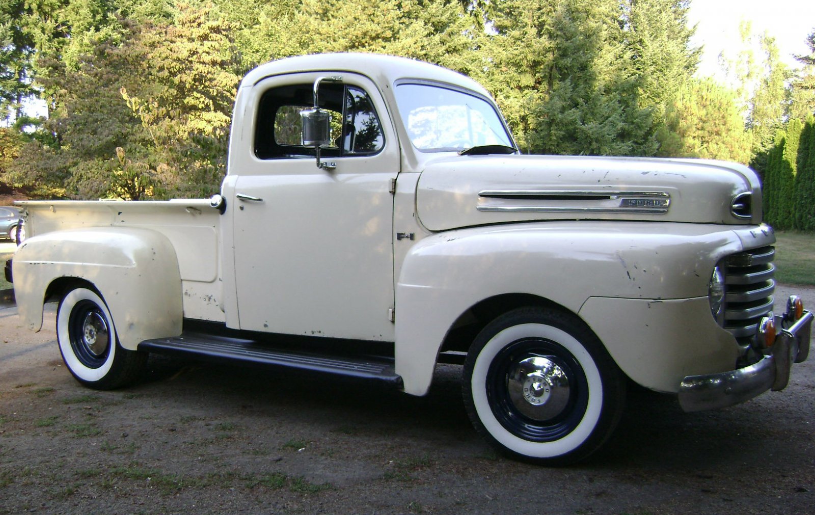

    I wanted a set of WW for my '48 Ford but just couldn't step up for them as they were more than I paid for the truck. I've "sanded" a few sets to make WW. Any tire that has white letters or a whitewall have more white that what's showing. Normally the underlying white doesn't make it all the way to the rim as seen.
    Threre's old threads on the HAMB how to do it. The biggest drawback is it's a messy job. The sandings become static charged and want to stick to everything. Mine always turned out well though.
    First set were 215/75/15 and originally a 1" whitewall
    Ended up being 2-1/4"
