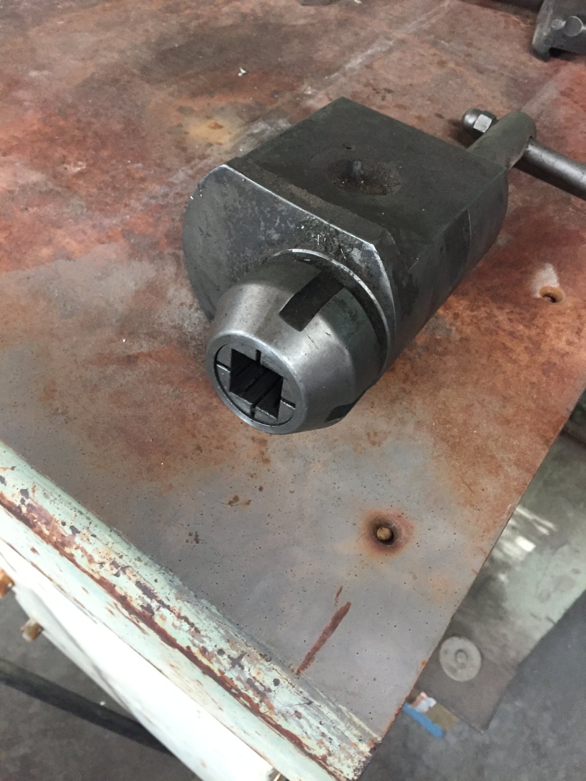

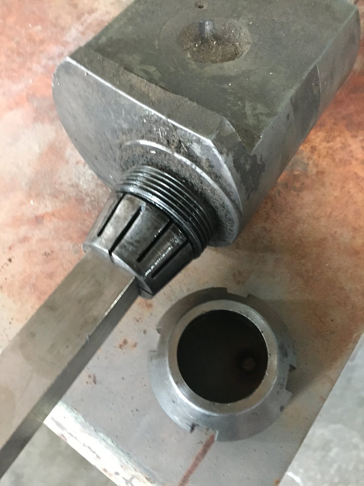

  1. What do the guts of the lower tool mount look like ?
    What’s under the spanner nut ?
    What’s in there?
    Thanks
    41CD7BD6-9394-43FF-8C22-F190D51E4664.png 705B3A0D-446B-41B9-934E-49F134E6E571.jpeg

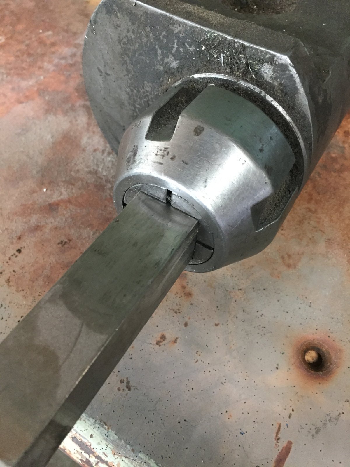

    Mine looks like the one on the right.
    Under the big nut there is basically a wedge that puts even pressure on all 4 sides of the lower tool, so it stays centered even if you tighten it.

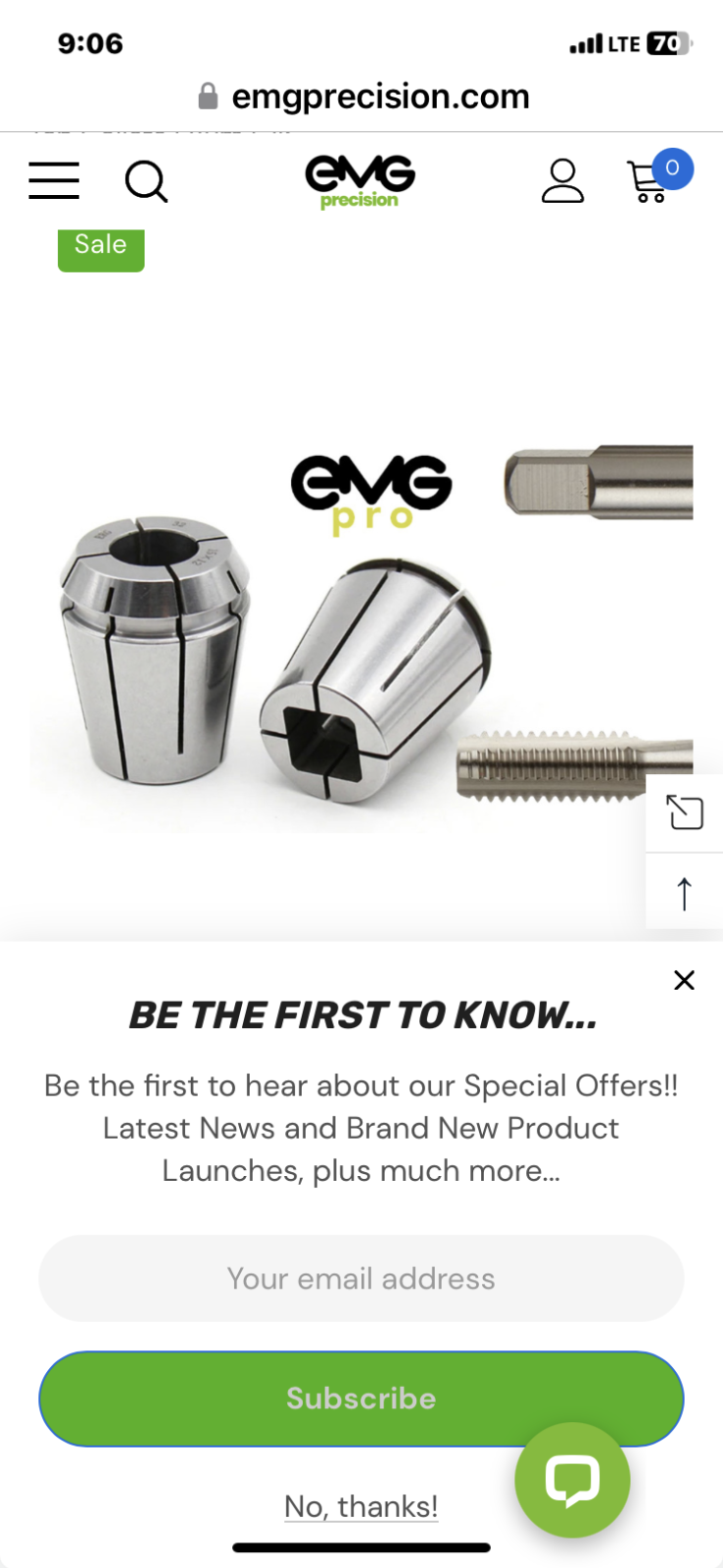

    ER40-G square drive collet.
    31Vicky with a hemi likes this.
  8. Looked at those,
    the TAP collets are round on top to hold the shank and square on the bottom .

    Machine corners into the round.

    Those are for tool holders in a CNC mill.
    Most collets are hard. If you can find the holder like a 5c block and a local shop with a wite EDM, you could have what ever sized square you want burned into them.
