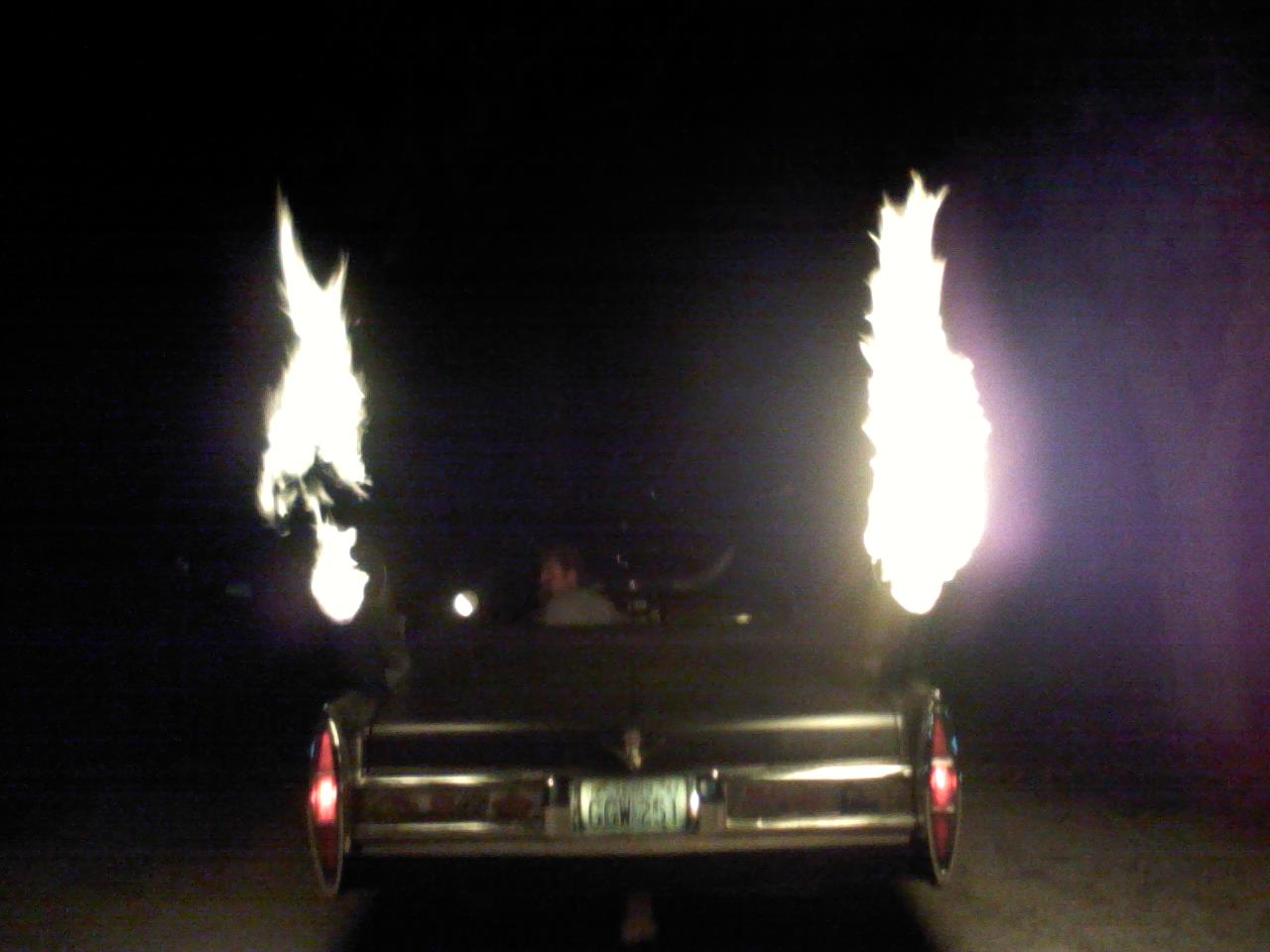

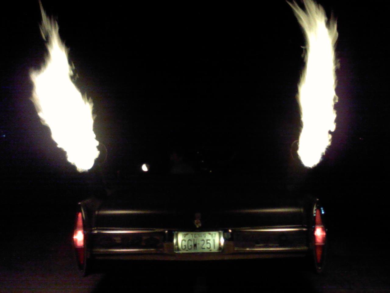

  28. 60 Belair
    Joined: Feb 19, 2006
    Posts: 747
    60 Belair
    Homemade
    by my crazy redneck friend Wes
  29. BigFinCad
    Joined: Apr 10, 2005
    Posts: 167
    BigFinCad
    I too, have a 60 Caddy with flamethrowers. I can help with a kit that is very reliable. Send me a message with your phone number and I will call.
