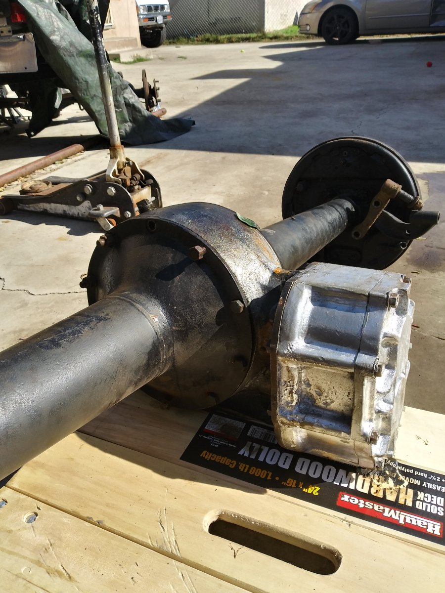

    2003-12-31 23.00.00-58.jpg I have one in my 39 Hudson oval track car. Speedway Motors cover.

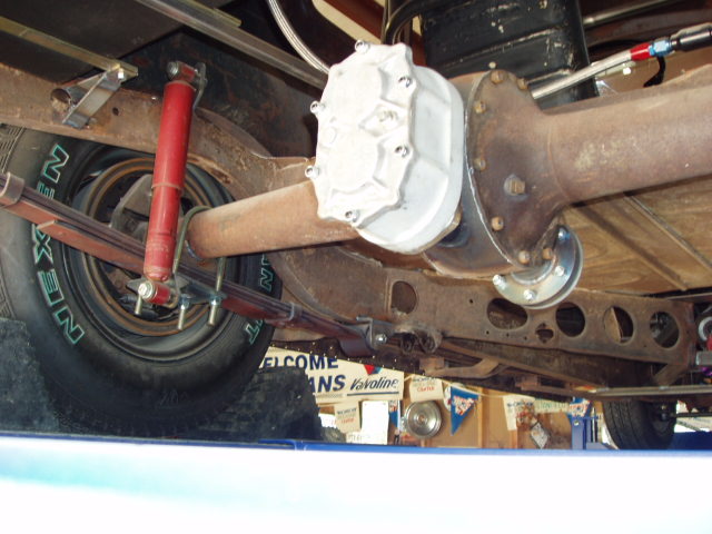

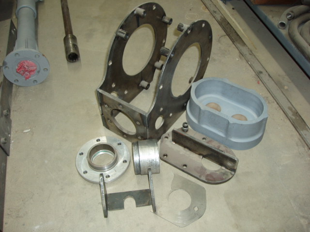

    Parts for someone that wants to fabricate their own QC. IMG_3928.JPG IMG_3929.JPG IMG_3930.JPG IMG_3931.JPG IMG_3932.JPG .
    I believe these are Kolstead (or Kolstadt) from Ohio. The bores are 3 1/2" on center which would enable a guy to use a 10 spline pinion and Champ size change gears. Not for the faint of heart. I would consider selling the castings outright or building a rear up with these pieces, on a time and materials basis.
