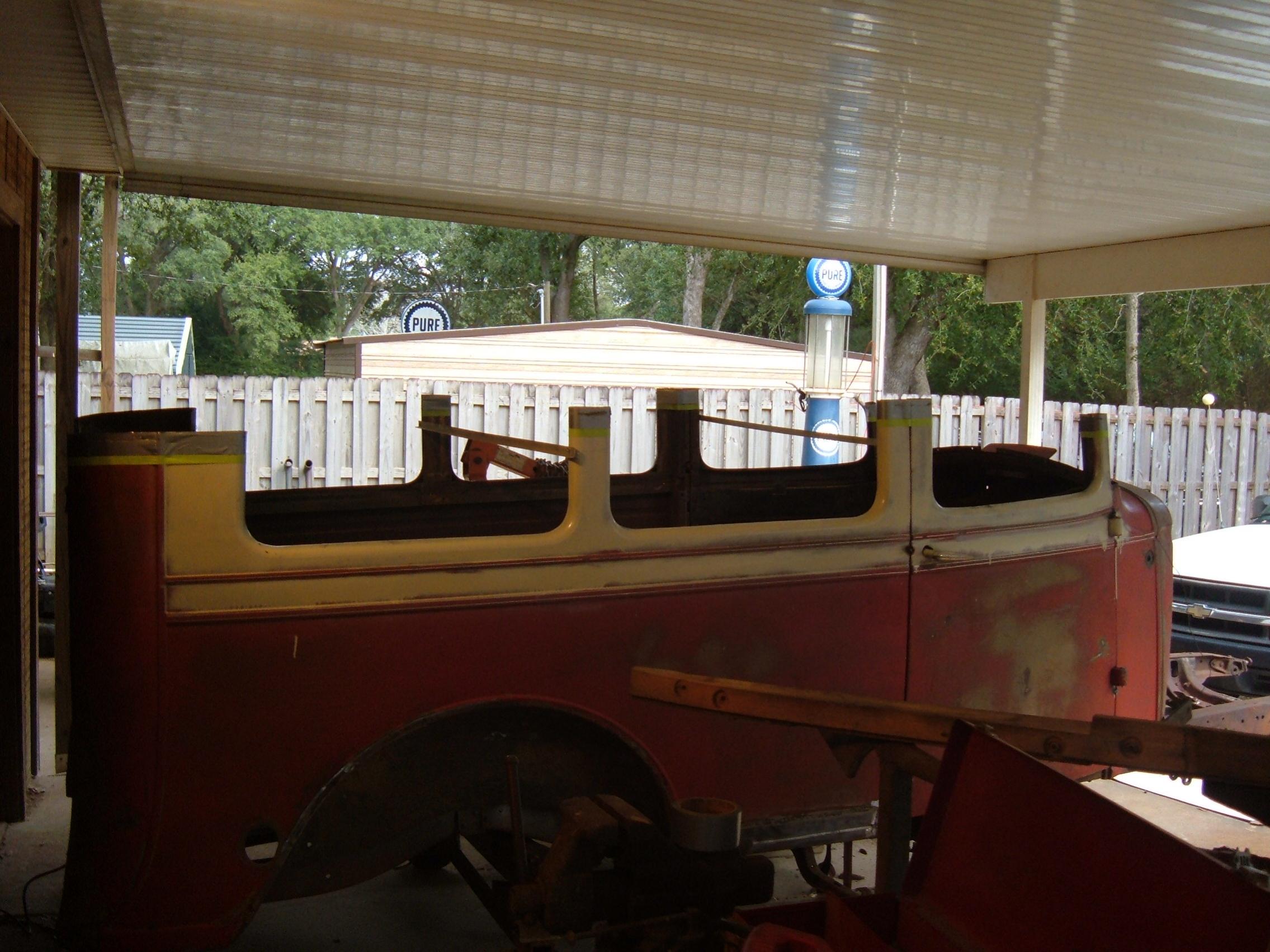

    A friend helped me to do the chop on my 49 COE. 4 inches F and R, but kep the rear window stock height by taking 2 inches above and below it. I wanted to keep all the stock pillar angles the same, so the roof was quartered. Used a spare donor roof for the splice pieces. I would do another chop now with the knowledge gained from this one. Have a 52 GMC project that would be a great next chop candidate.
    I think anyone with some welding and fabrication skills can do it, just think ahead and consider what you want the final outcome to be. Don't just cut away without a plan. Flat gl*** is a whole lot easier than curved.

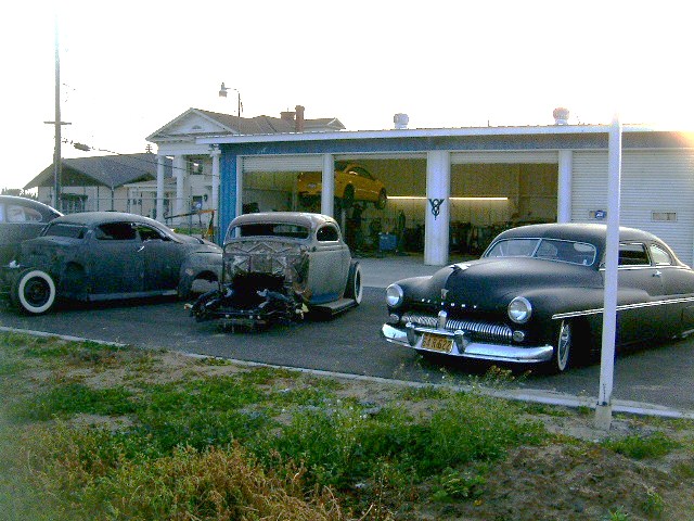

  10. 345winder
    Joined: Oct 27, 2010
    Posts: 1,059
    345winder
    thanks,, the truck,,i cant rember excallty,,,but i think it was like 6" or so,,and i did cut it across the center,.,,,i understand ya on chopping the bug that way,,as most vw people make ya wanna belive you have to cut them that way,,,,you dont though,,,i cut mine the way the very first chopped VW was cut( a 56 oval cut when almost new) :D,,,
