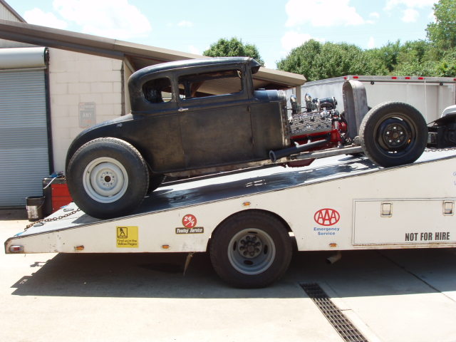

    Getting closer to making the dream reality:

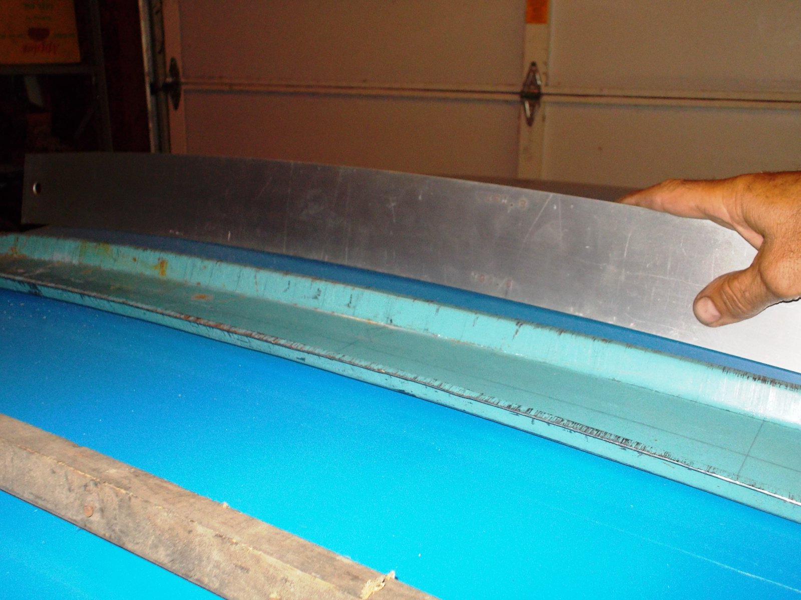

    I did this F 100 aluminum valance by eye. Would have liked to have a body sweep. It is 1" narrower top to bottom than a stock valance that's why I made it. Some say it turned out OK. I hate that phase. Sounds like what you did was an accident. F100 012.JPG

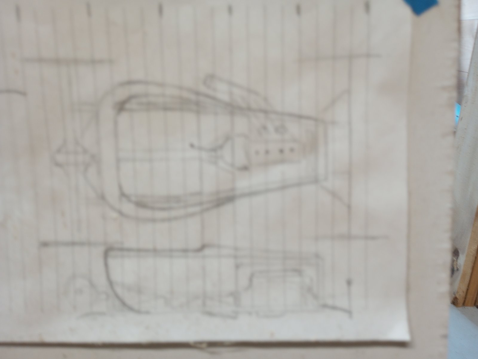

    At 81 now,it's been a bit of a gap,from last time I needed to draw a neat n clean type blue print.
    Did years ago for customers,but not much more then napkin scrible for my self,having things in my head.
    I just look,but seems I've lost most all of good drawing from the 60s,70s n 80s.
    I did find a scrible of a EV racer that I designed, used to build battery power, that maybe fun to see. I built it way back,won every race for 2 years> Funny thing was,I never compleated the aero body*,after we won the first event with out any aero body,in what we thought was only test it out form ,with no body , won a number of laps ahead of P2. A write up from AUTOWEEK. FullLeanTrikeSparky.JPG Autoweek.jpg

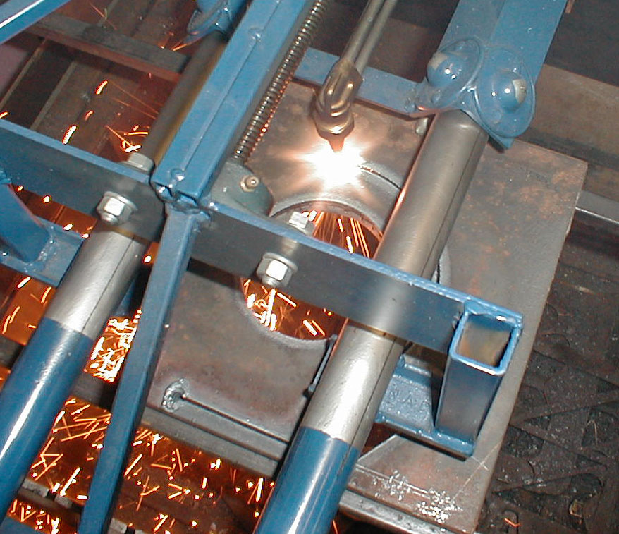

    Anymore, I rarely do any actual blue prints, but on even simple parts I like to sketch one or two views with the critical dimensions. I sometimes add a perspective drawing, just to help remember all the details I want to include, like this battery tray / switch mount I made recently. It is not uncommon for my finished part to diverge slightly from the initial concept drawing.

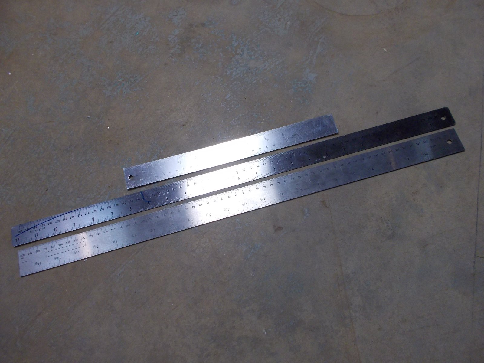

    I'd be remiss if I didn't mention these clever scales, called "Zero Centered Scales" that have the zero mark in the center. Often used in picture matting and framing, they are extremely useful for speeding up making measurements off of, say, a ch***is centerline. I have a yardstick I also marked up as zero-centered.

    Good idea !

    Good tip. Lufkin also have a tape ruler with double markings on it. Normal full size and another at half scale sort of. Full scale reads 23 1/2 inch. Half scale reads 11 3/4. So if you want to know the center of the stock being measured, no math gymnastics. You know it's 11 3/4 inch is the midpoint.
