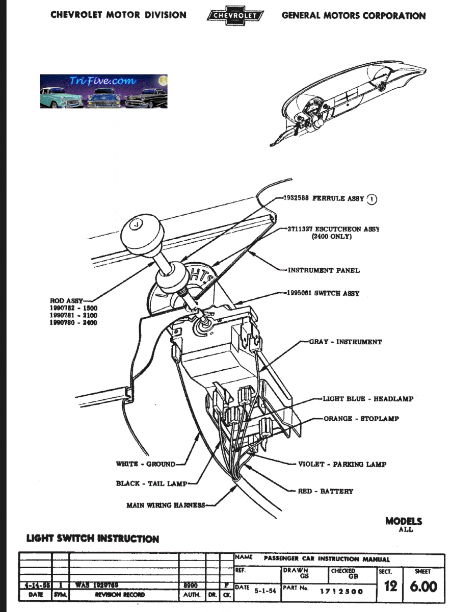

    You can add a "non-invasive" headlights on warning buzzer that's really simple to do.
    Use a two wire piezoelectric buzzer and wire it between the taillight circuit and the ignition circuit.
    The piezo buzzer works like a diode, only passing current in one direction. These will then be polarized, so you have to connect the positive wire to battery side.
    Connect the piezo buzzer between the ignition switch output and the lighting switch taillight output. Switch on the lights. If it doesn't buzz, swap the wires on the piezo buzzer.
    With ignition and lights on at the same time the buzzer has 12 volts on both sides, will pass no current, and will not sound.
    With ignition switch on but no lights
    , the piezo buzzer has 12 volts on one side but will not pass current in that direction, so also does not sound.
    With lights on and ignition switch off
    , the piezo buzzer gets power from the lighting circuit and finds ground return through the temperature or fuel gauges.[usually the oil pressure sender]
    The piezo buzzer has such high internal resistance (only a 10mA device) that the lower resistance circuits conduct current like ground connection for the buzzer.
    Current is limited to 10mA by the buzzer, so nothing happens in the ignition or fuel pump or fuel gauge (or heater fan, wipers or radio if any of those were left on). The little piezo buzzer could buzz loudly for 3 months and it still wouldn't flatten the battery.
    With cars like my 57 Chevy [or most GM light switches] there is a spare male spade terminal beside the "black" tail light circuit [see photo] . This is the positive side for the piezo buzzer.
    The other side of the buzzer on my 57 can simply plug into a spare terminal on the switched side of the fusebox. [there is continuity to the ignition circuit on early Chevy's]

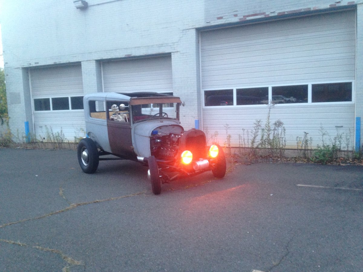

    An older shot of the car at dusk. I run my parking lights and they have 1157 NA bulbs in the headlamp reflectors so they give off a bright orange glow and seem to stick out pretty well.
