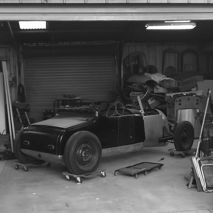

    Starting to put my 25 Chev. roadster in a pile....wanting to start building the steel body framing. Question: I know the width of the body at the rear of the cowl is 37.5 inches and the body width at the beginning of the trunk area is 45 inches from a sketch I saw on the site....does anyone have a body width measurement at the rear of the door/beginning of the rear quarter? Thanks in advance, Jim

    Gilco, I'd like to see lots of pictures as you go. What nose piece is that?

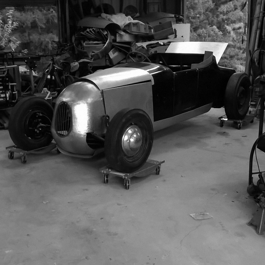

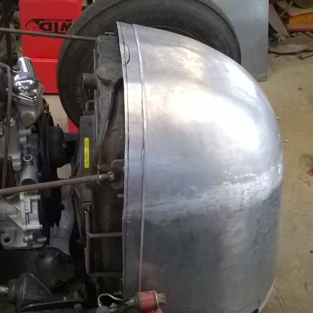

    Hello Six Ball, The nose is going to be my homemade version of the S/G roadster track nose,(in steel)....I have it roughed out using a 23/4 Chevy grill as a starting point so It will be easy to use my stock hood...

  14. Happy to help, the measurements are very close to stock. Before I did the body structure I asked a restorer to measure his restored roadster.

    Is it normal for an old hot rodder to start his car project by chopping the windshield? (Couldn't resist it!)

  18. Six Ball
    Joined: Oct 8, 2007
    Posts: 6,963
    Six Ball
    from Nevada
    That looks nice. I was wondering which parts of mine to use. :D
    Did you narrow the Body? I haven't tried to put my pieces on the frame yet. I thought it was wider than the frame.

  21. Gilco33
    Joined: Dec 3, 2010
    Posts: 37
    Gilco33
    Thanks for your comments, I didn't narrow the body , My plan is to shape the frame to match the body, so I cut out all cross members and moved the rails to the outside ....... ( I got this frame in a trade ....it was built into a BOAT TRAILER! ....not sure exactly what it is, but it almost exactly fits the lower body shape of the Chev roadster!)

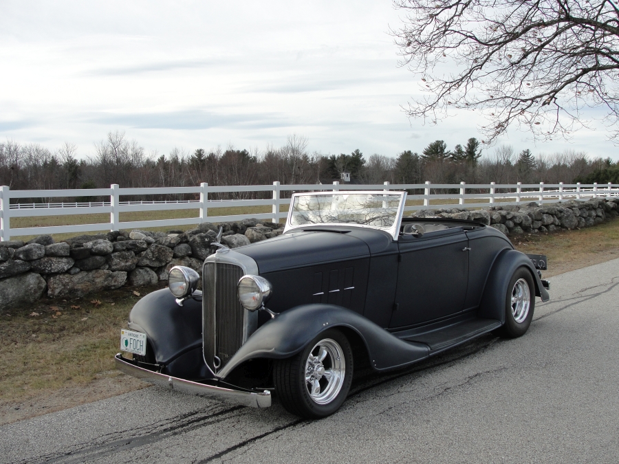

  22. TFoch
    Joined: Mar 31, 2010
    Posts: 2,389
    TFoch
  23. GEBHARD

    Thanks! My frame too matches the lines of the lower body and I was thinking of matching them up. I don't want to channel it. Making the frame wider could provide a little more room inside the car for seats, tank and trunk. I'm thinking of using rear suspension similar to the old racer in the picture mounted inside the rails or quarter elliptics. Trying to stay with old tech and away from Ford. I need to get the body together so I can take measurements and get on with it.

    Yes, We are thinking alike.... By setting the body on top of the frame I was thinking I could add extra "depth" to the seating area and also make it have the "belly pan" look , ( I will keep you posted as I go on the difficulty of making the frame match the lower body)........... yes, I understand wanting to use non Ford ch***is parts, that rear suspension would be cool... I'm trying to stay somewhat with the theme of the S/G car ....thus the Ford wishbones..... ( I can claim I had to "sacrifice" an old Ford to build the Chev. ) ...Lol
