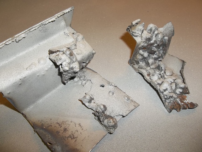

  2. That's "Hammered welding". :D I think that might have been what the last guy was doing on the butchered bird!:eek:
