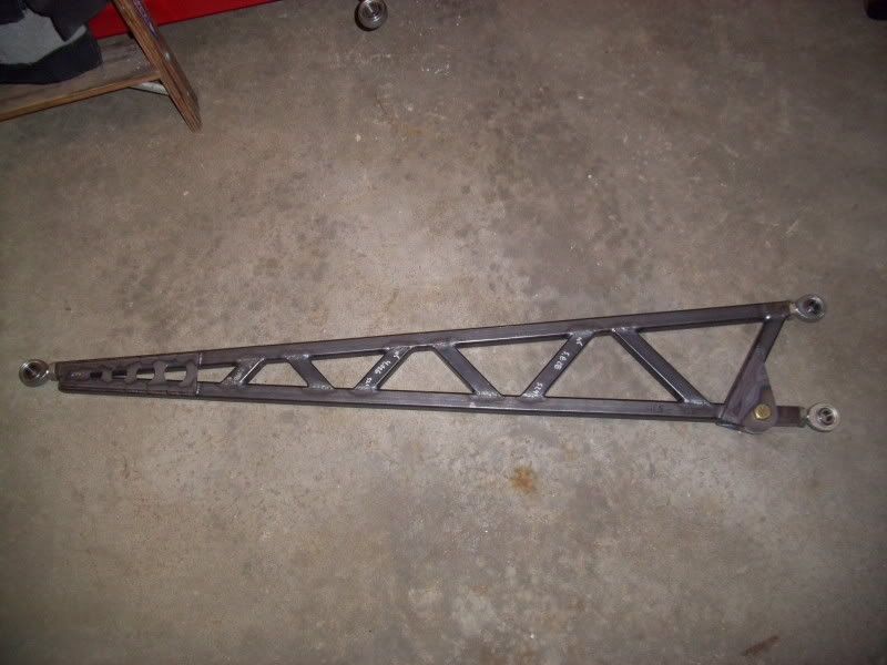

    can you share some info on the ladder bars? I was thinking of getting some caltracs but I like the old school ladder bar look

    I'll post some pics of the ladder bars tomorrow for you.

    thanks! I'd like to make my own (to get it "just right") but I'm thinking that without a jig to hold it all in place I'd have some warping from the welding. I dont want to hijack this thread, I better start a new one.

    My ladders bars are made from 1" x 1/8 wall square tubing. Where the rod ends screw in it is made from 1" x 1" x 2" mild steel that I drilled and tapped 3/4 NF. The ladder bar also has a adjustable link on the back so I can adjust the pinion angle and IC with out binding the rod ends, I don"t know how well this will work, I'll find when I get the car on the track. I used a piece of 6" channel to keep the flat while I tack welded them together.
