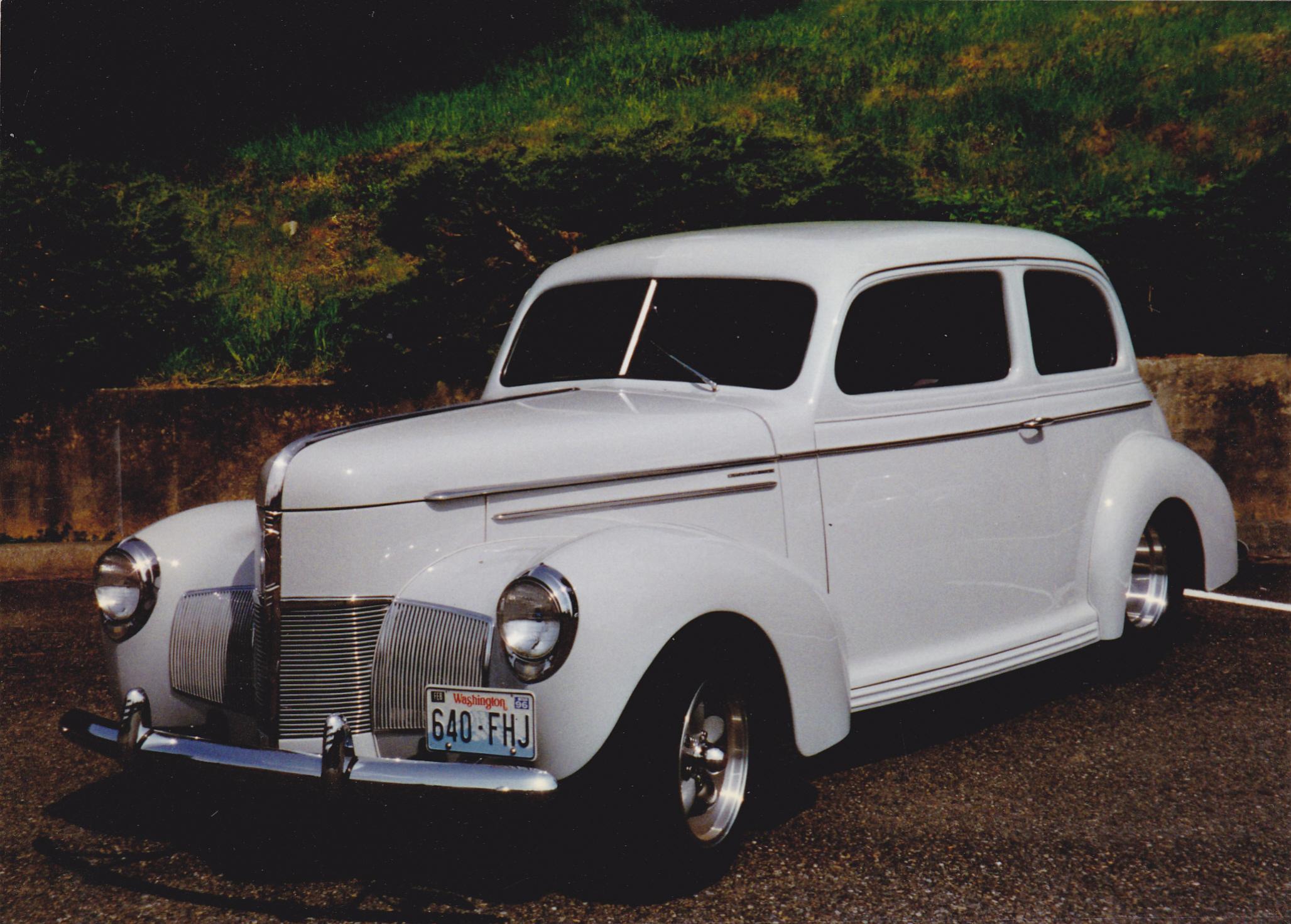

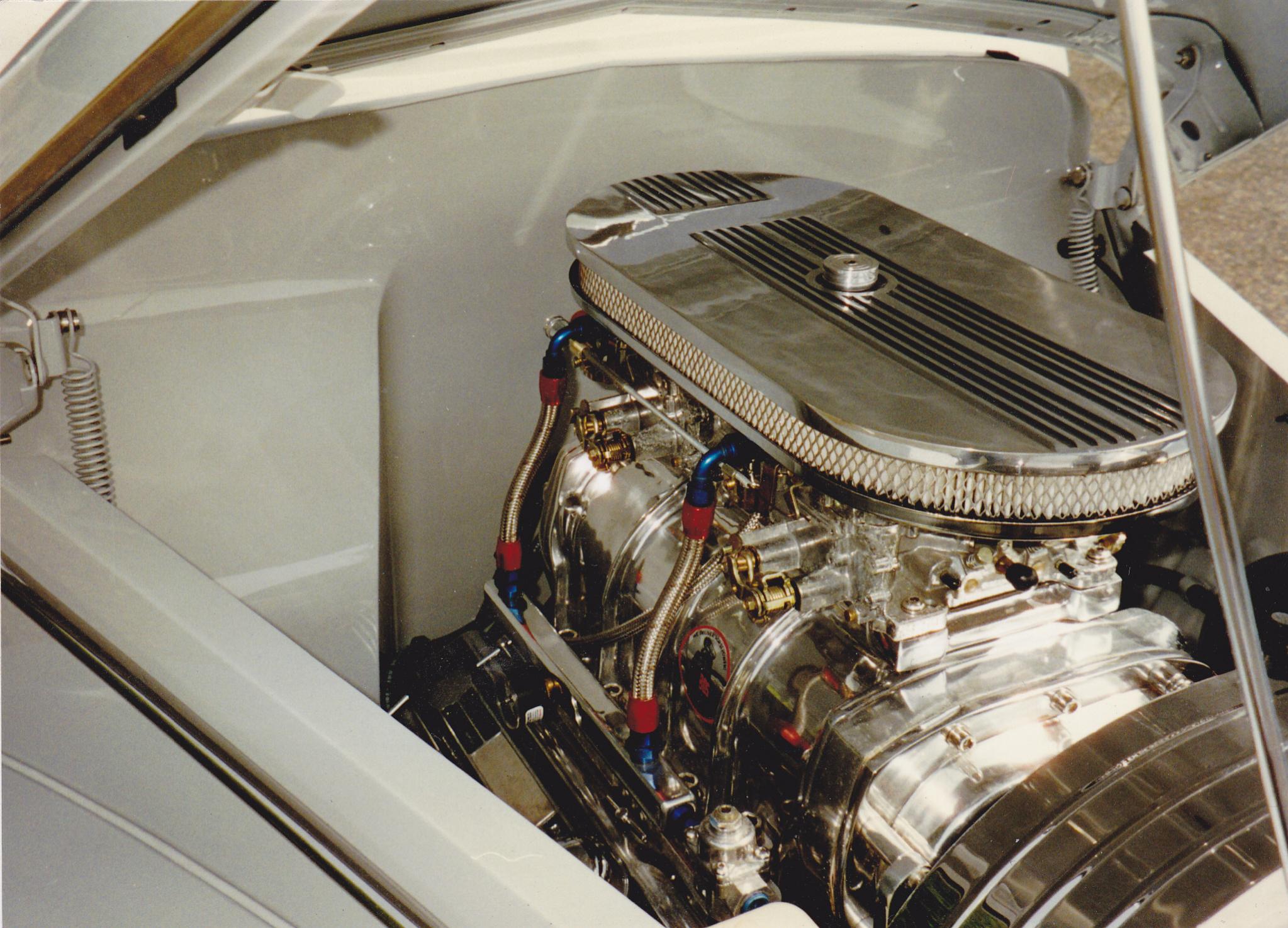

    My 40 Stude mild g***er. 383ci in 671 Blown sbc.;)

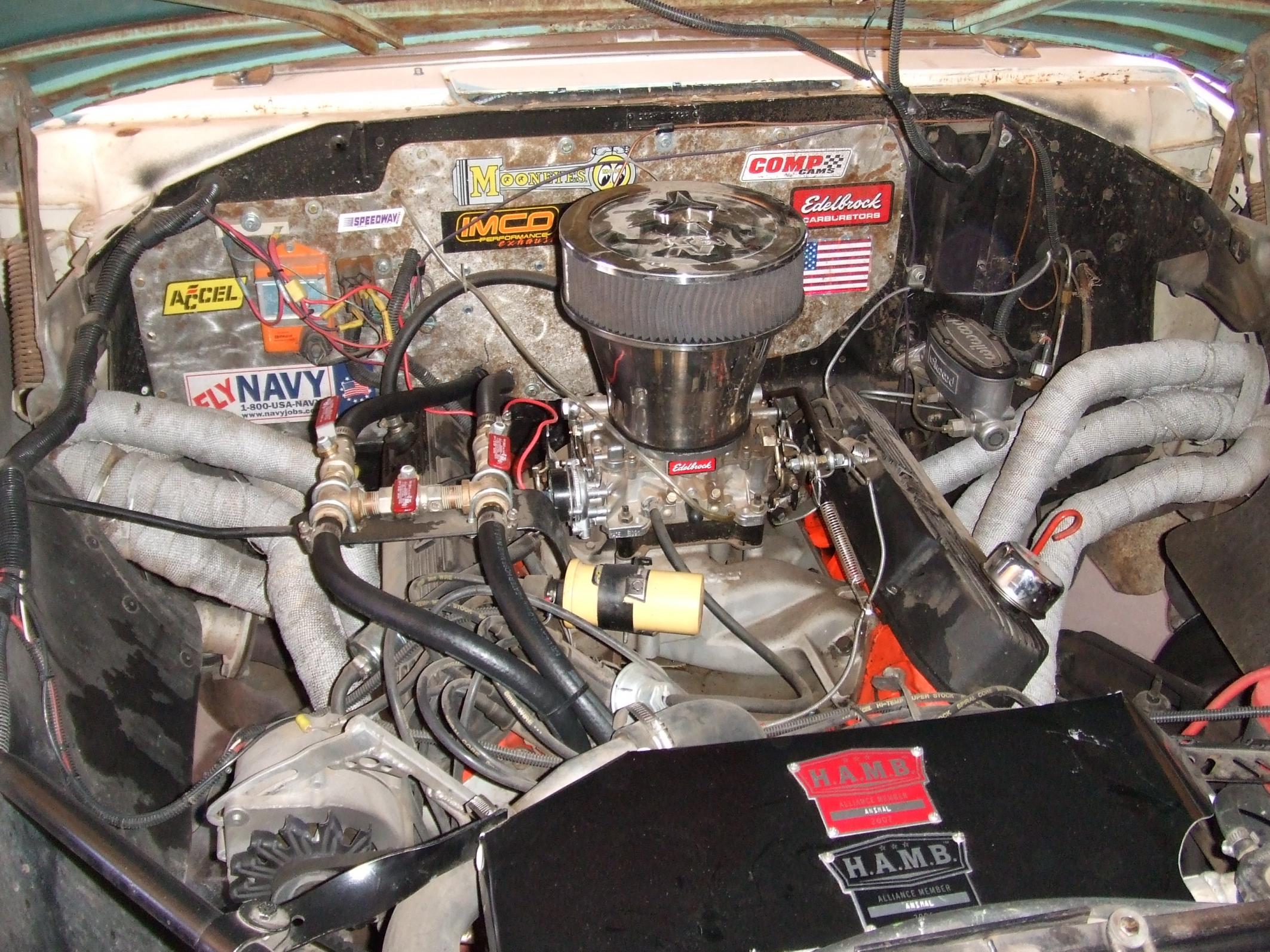

    i'll through my truck in the mix…
    still a long way off but getting there.
    it's a 1940 dodge with a 270 and a A-833 4 speed OD
    i am currently working on getting the 4-71 supercharger installed
    it will be v belt driven.

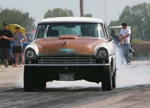

    Looking through this thread, I realized that I never posted a picture of my g***er-inspired '56 Plymouth after it was "finished". :) 440/TF727, six-point cage, homebuilt fenderwell headers, tube bumpers, radiused wheelwells with 10" US slots on the back, ET five-spokes on the front. I drove it the 700 miles to Joplin for the HAMB Drags, had a freakin' blast! The car is now in the Netherlands.

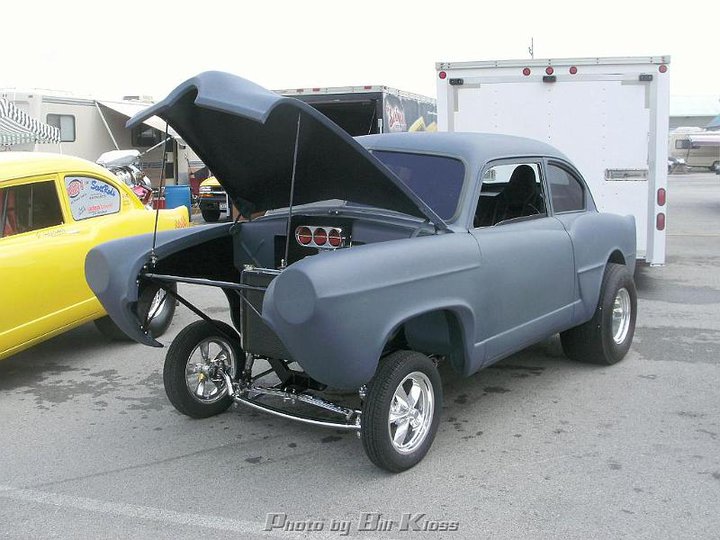

    My all Gl*** Henry J, Serial number 1
    Now being converted into my AA/GS Drag car.

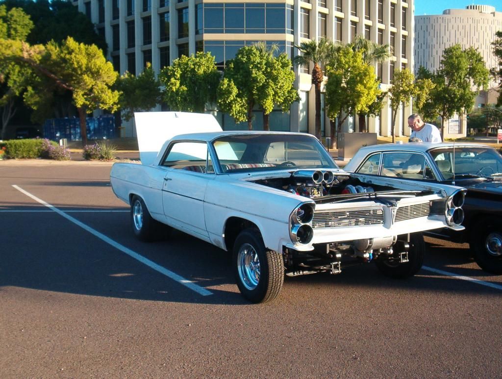

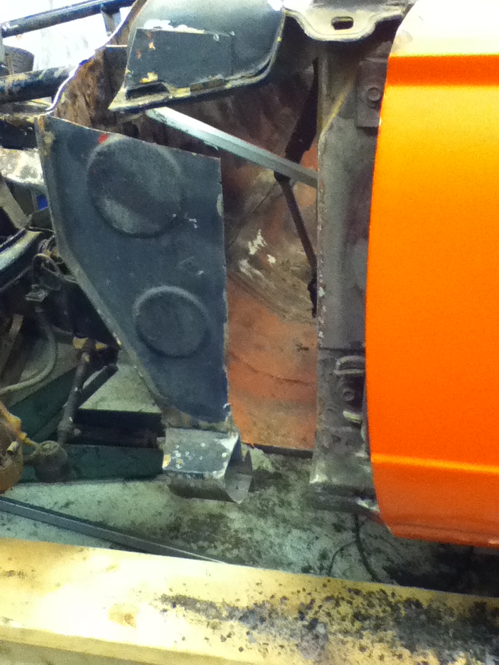

    I've had my G***er style '63 Catalina on here in its build stages. Well I'm still building it. This is the last and final engine configuration. With the finished but not started engine all in place. I'm a turbocharger nut so I had to incorporate that into this build so it is not even close to traditional. But much of the ch***is and body mods are older style G***er like. 1960 389 punched .090 to 406. KRE D-Port aluminum 320 cfm heads. Solid roller turbo cam. Ross dished pistons on GRP aluminium rods, forged Ohio 3.75 crank. Wenzler Gutsram Tunnel Ram with twin blow thru E85 750s, twin 76MM Turbonetics ball bearing tuebos blowing thru twin intercoolers.
    Ford GM spec (Dearborn) top loader 3 speed, ladder bar rear suspension, Ford 9 inch detriot locker 35 spine axle 3:50 geared rear end. '57 Chevy pickup front beam axle on custom front frame clip.
    Engine moved back 11 inches and firewall cut and reformed around that.
    Engine compartment.
    Towed it to a local cruise last October, full car pic.
    This is my concept to fit my needs and wants. Nowhere traditional but with traditional flavor. Hope to start it up soon. Just needs wiring run, fuel system finalized, and coolant lines run from trunk mounted radiator to the front.

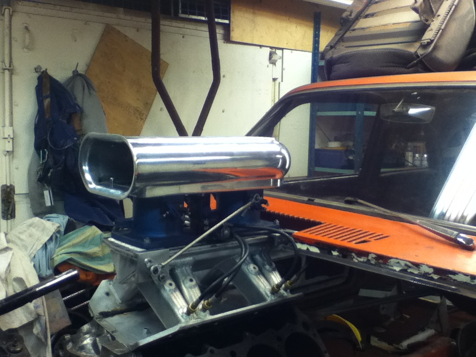

    My Austin g***er has been sick with a bad engine. Almost finished installing the replacement I've built for it. Just waiting on a pair of vintage Mr Gasket finned valve covers to arrive, and plumbing to the twin 600cfm Holleys.
    Had to work up a little bracket after changing from tunnel ram to cross ram so the Hilborn scoop would still supply fresh air to the carbs.
