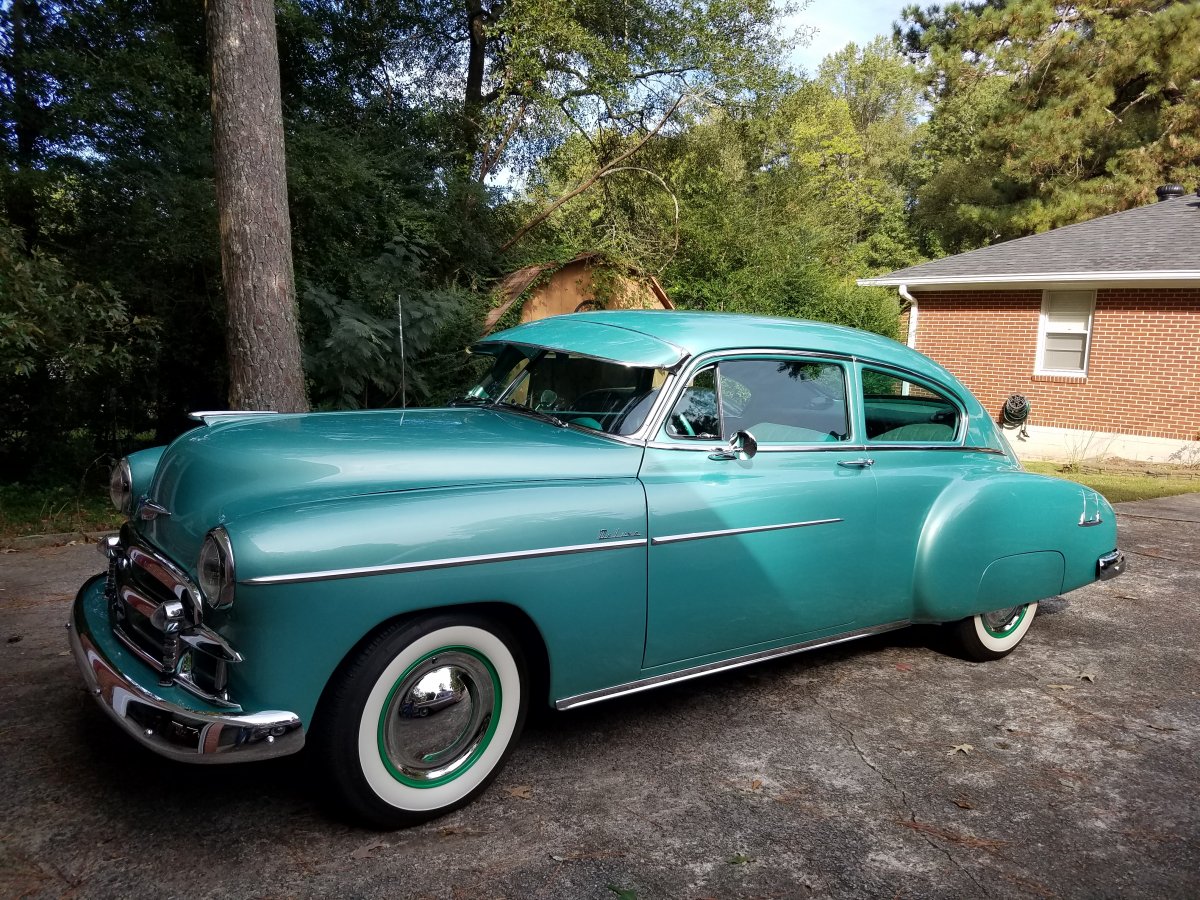

    Looking to notch my 50 Fleetline but not wanting to go with a huge stepnotch, trying to avoid major fabrication on a restored car.
    Post your pics please.
    Give info on what was done to achieve your stance.
    THANK YOU
