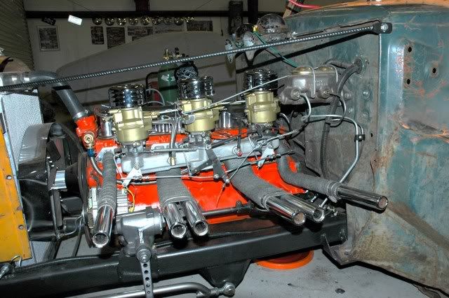

  7. Bonehead II
    Joined: Apr 18, 2005
    Posts: 439
    Bonehead II
    Twisted 6, Yes its a old Clifford with 3x2 Holley, The guy at clifford told me that it would take 700 HP, to run that unit. I wanted something that was going to easy on the street what do you think.
  8. 6narow
    Joined: Jun 1, 2008
    Posts: 563
    6narow
    WILD!
    Those exhaust pipes look like a set of guns off a WWII fighter plane! ;)
    Speaking of which, I've seen those "straight-out" type of exhaust pipes before.
    Does someone manufacture those or are you guys building them custom, just for your rods?

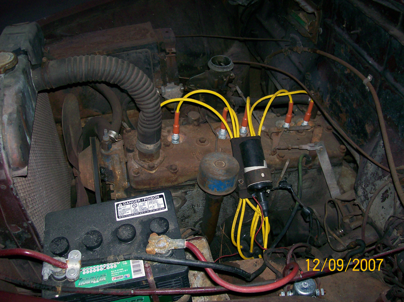

  13. roddinron
    Joined: May 24, 2006
    Posts: 2,676
    roddinron
    Here's mine, nothin special, 235 rebuilt by sears allstate, though I don't know when. It was stuck when I got it, but I got it freed up and checked it out, lapped a couple valves, then added HEI, split manifold, and rochester 2V. Just got it running, this was recorded today.
