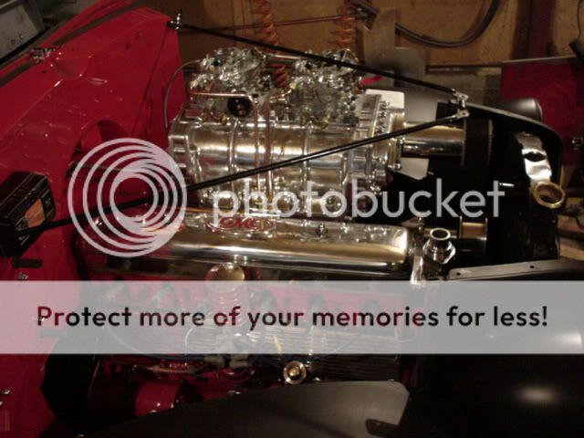

    I have a 302 GMC 6cyl with a 6-71 blower and dual carbs on it. It's in my '40 chev p/u hooked to the original 4 speed ****** and rear end. I'm not sure my truck is a hot rod, but she goes pretty darn well. Here's a pic:

    Damn That looks Sweeet. Got any pics of Intke manifold.

    Not really any of just the manifold. This is the best one that I have:
    With the fenders and front end back on the truck you can only just barely see the intake manifold and the cast headers are all but invisible....lol.
    When I was putting the thing together, I kept forgetting to bring my camera into the shop. Now I wish I had taken more pictures as I have had more than one request for pics of the intake manifold. Sorry about that.

    That's really nice. Good skills!

    That set-up is Just a awsome Job.I to would like to know more about the intake (thickness and what not.)

    Which intake are you referring to?(before I go into an explanation that no one really wants to hear...lol.)

    That nice looking (what looks to be ) 671 blower If you have build others i wouldn't mind seeing them either :)

    Well I wish I could take the credit for the fabrication of the manifold, but unfortunately I don't possess the welding skills required for aluminum. So I went to a local machine shop and told the guy what I wanted. He said no problem and I'll mount your drive and crank pulley too.
    The manifold originally started as a cast piece set up to mount a 4-71 blower vertically. I got the last one from the old stovebolt company. The guy didn't think he had any left but when he looked he found one covered in dust at the back of a shelf. I really lucked out cause he sold it to me for about $75!!! But I thought the 4-71 would look funny on a motor with this length. I also wanted it to be mounted horizontally. So I had the machinist build a plenum out of 1/2" or so aluminum and weld it too the original cast manifold. Then he built the mounting plate for the blower on top of the plenum. He also designed a pop-off plate that is spring loaded in case the engine backfires through the carbs. The setup works quite well

    That is still one Sweet set-up. Still if you have or get/take any other photos I wouldn't mind seeing them.
