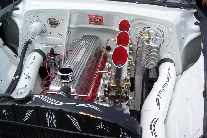

    The ol before and after pics of my stovebolt.
    I couldnt never come up with the money to buy me a triple carb setup.so I built my own.
    But after doing it, I am glad I built it myself.

    any pics of the intake?
    did you just take a stock intake and weld carb flanges on it or is like a tubing log set up?

    Here is a pic, that you can see a little of it.
    Its not pretty or fancy, like some could have done, but considering my lack of ability and Money, I am pretty happy with how it turned out.
    I had some good help, from on here, and on CT, from a couple of guys, that gave me alot of tech advice, and talked me through it.
    Its a stock intake, and has 2" tubes, and flanges I cut out of plate steel and then welded and brazed up.
    Most of the parts, to do the intake, throttle linkage, and fuel block etc, just came from my junk pile.
    It still needs some tweaking, here and there, but Its doing pretty good now.
    The worst part was, after getting it running, it keep flooding the carbs.
    Not all the time , but when I would take it for a test run, one of the carbs at least, would start to overflow with gas.
    I would take them apart, and blow them out, and it would do ok, for a couple of more runs, then do it again.
    I finally found the problem, by accident.
    I was pulling the gas line off again, and when I did, I noticed the filter element, in the the New inline filter, that I had put on, had broke loose on the inside, letting junk get into my inlet needles. Putting another new filter on solved that problem.

    thanks for posting a pic
    thats a cool intake!
    I had the same problem with gas over filling my carbs then I figured out that I am a dumb ***...
    if you run a manual choke carb and you do not use your chokes, you still need to tie them off.
    apparently something stupid about vacuum pulling the choke closed?
    oops!:D
    all good now though! runs like a scalded dog!
