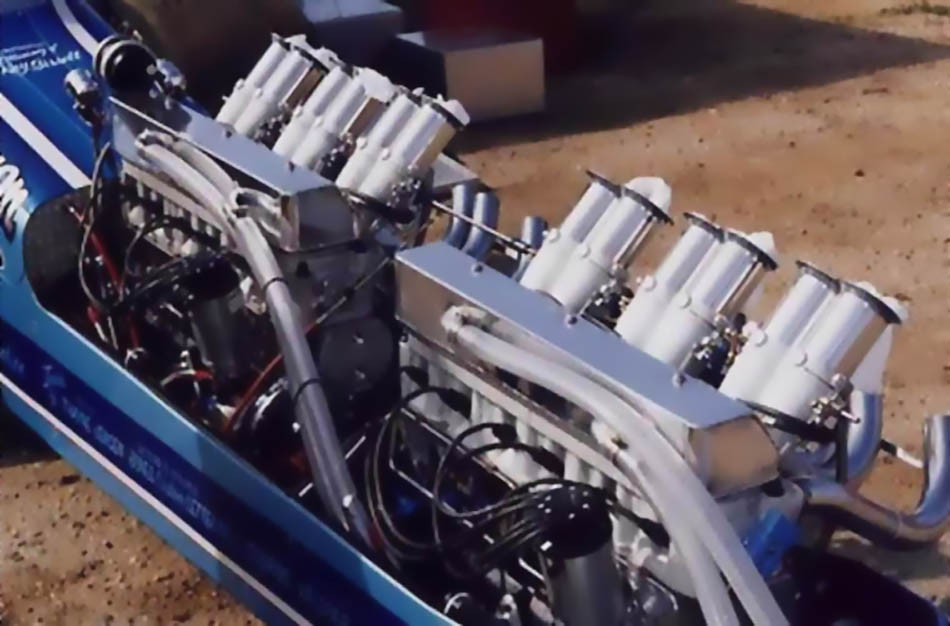

    Kay Sissell is an absolute Wizard of the Inline!
    Here is an example of his alchemy.

    Sissel also modified the original cast iron heads by opening up the ports especially the siamese intake ports and then adding lumps to the intake runner for greater velocity and of course bigger valves and other such hot rod stuff. The man is a legend in the six cylinder world of hot rodding.

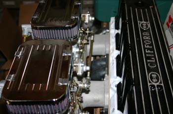

    Thanks for the education. My head has been milled .060 and now has the 1.94 valves with heavier springs. The 292 block was zero decked and features the Clifford cam, intake and exhaust manifolds, and a pair of Webers. It's torquey enough for a 2.90 rear spun through a four speed to be fun to drive and still get 22mpg.

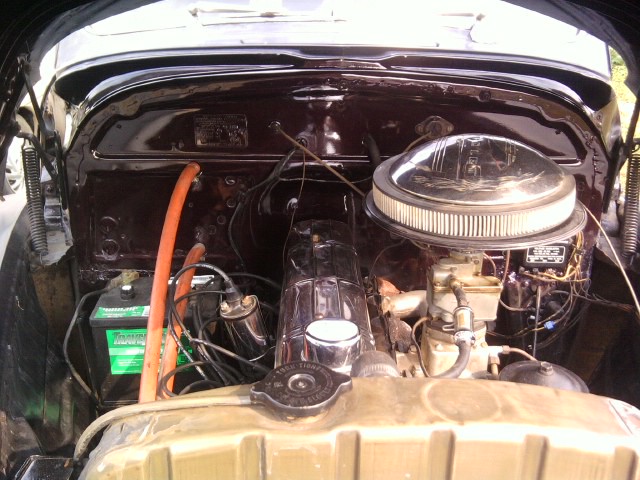

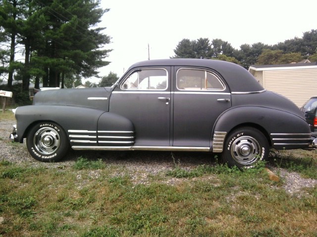

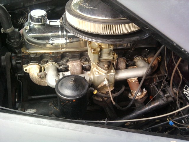

    all original six,with split manifold

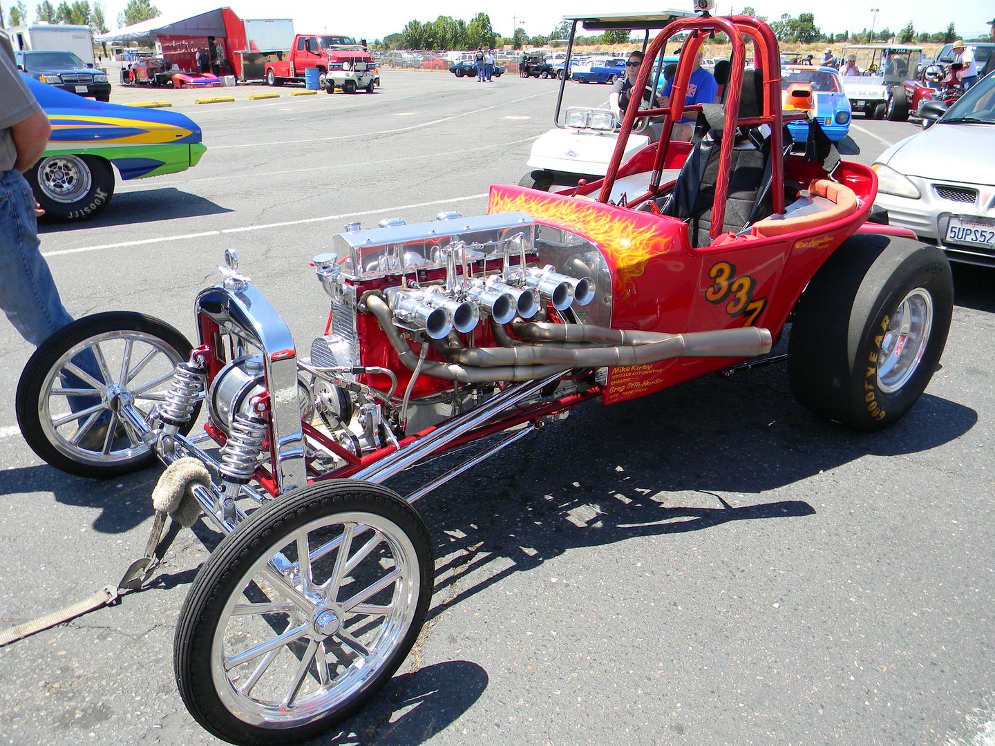

    [​IMG]Seen these at the track last week

    Oh yeah, definetly knew his stuff, but a modified orriginal head would be a "Sissel modified head", where as the aluminum head is the only thing I've ever heard of called a "Sissel head".

    Aren't those known as "Lump Port" heads?

    Take note, people. This is one of the few times anyone's gonna claim their 292 got more than 12 mpg.
    Nice work, Wolf. She sounds like a hum dinger!

    I have been quite pleased with the results and performance. I won't win any races with that 2.90 rear, but it putts along at 2000rpm at 65 mph. I made a 256 mile trip to NSRA york and back and still had a quarter tank. I got the jet kits for the Webers and fiddled with it till I got it right. For the money I spent on it, I could have had a stout crate SBC, but you can't swing a dead cat by the tail at a show without hitting a SBC.

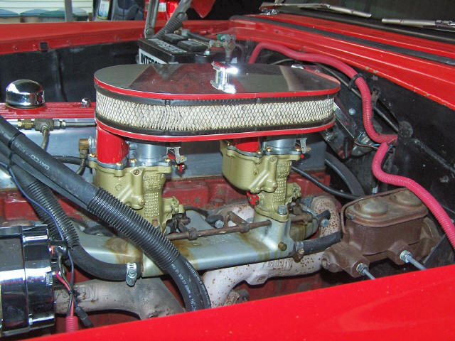

    Here are a few to look at. All are top performers too.

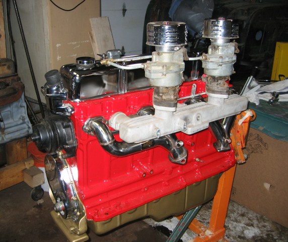

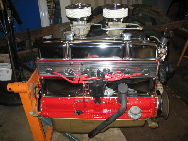

    This is what I'm working on. Its a 54 block with a 56 "848" head, also using a HEI dist. from Langdon's stovebolt engine co., I'm going to put it the 48 GMC pickup I'm building. Mel:D

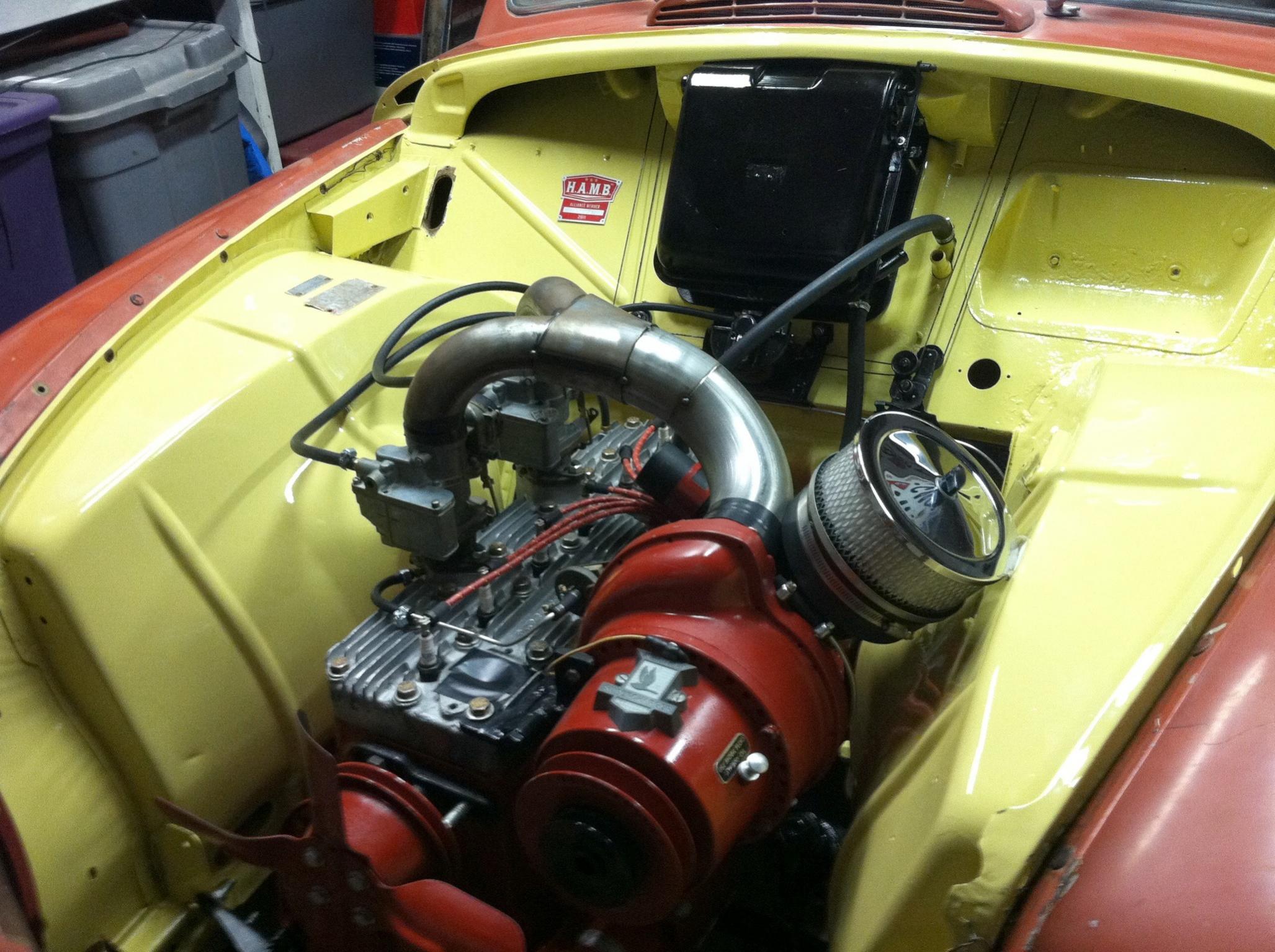

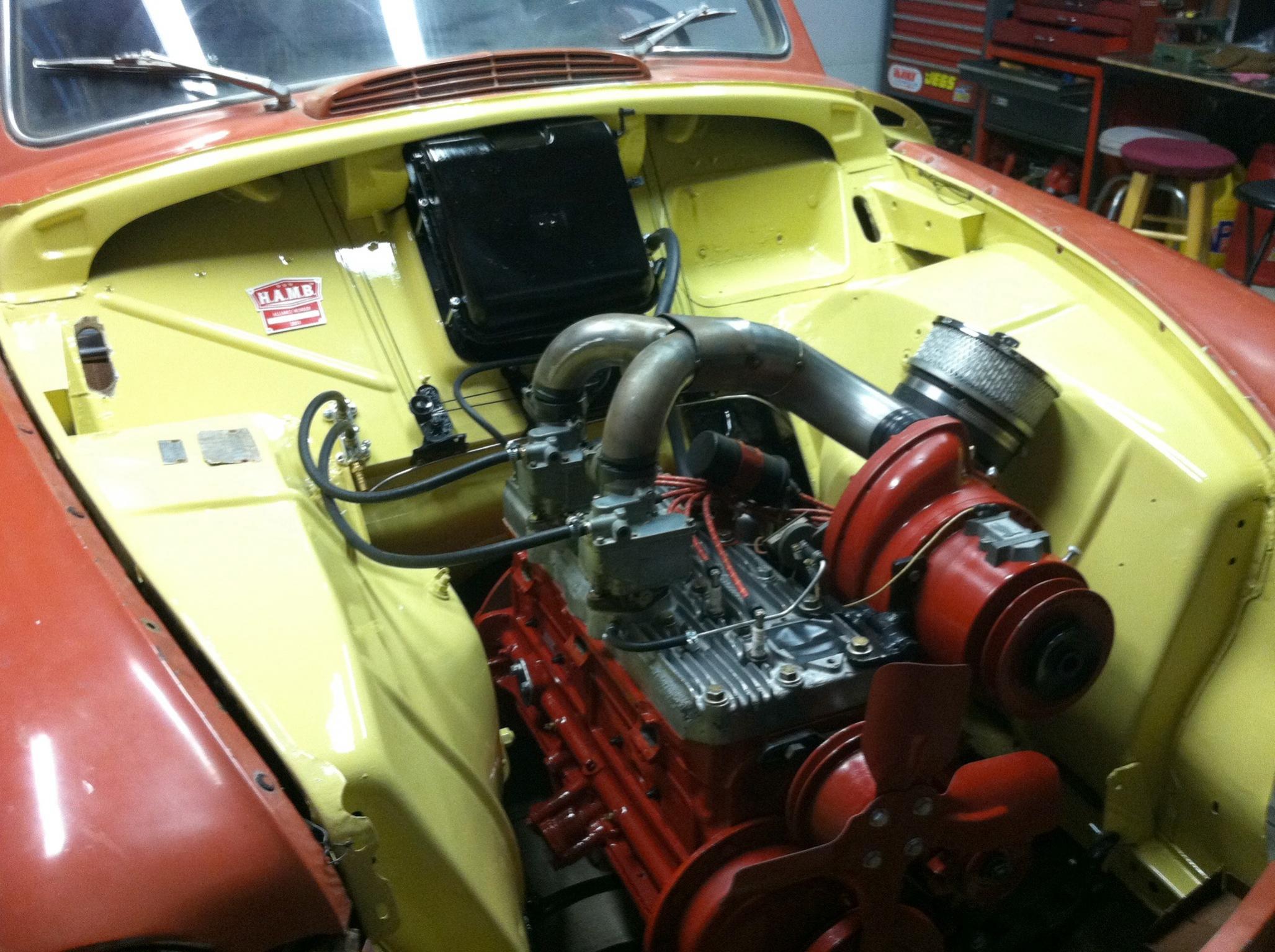

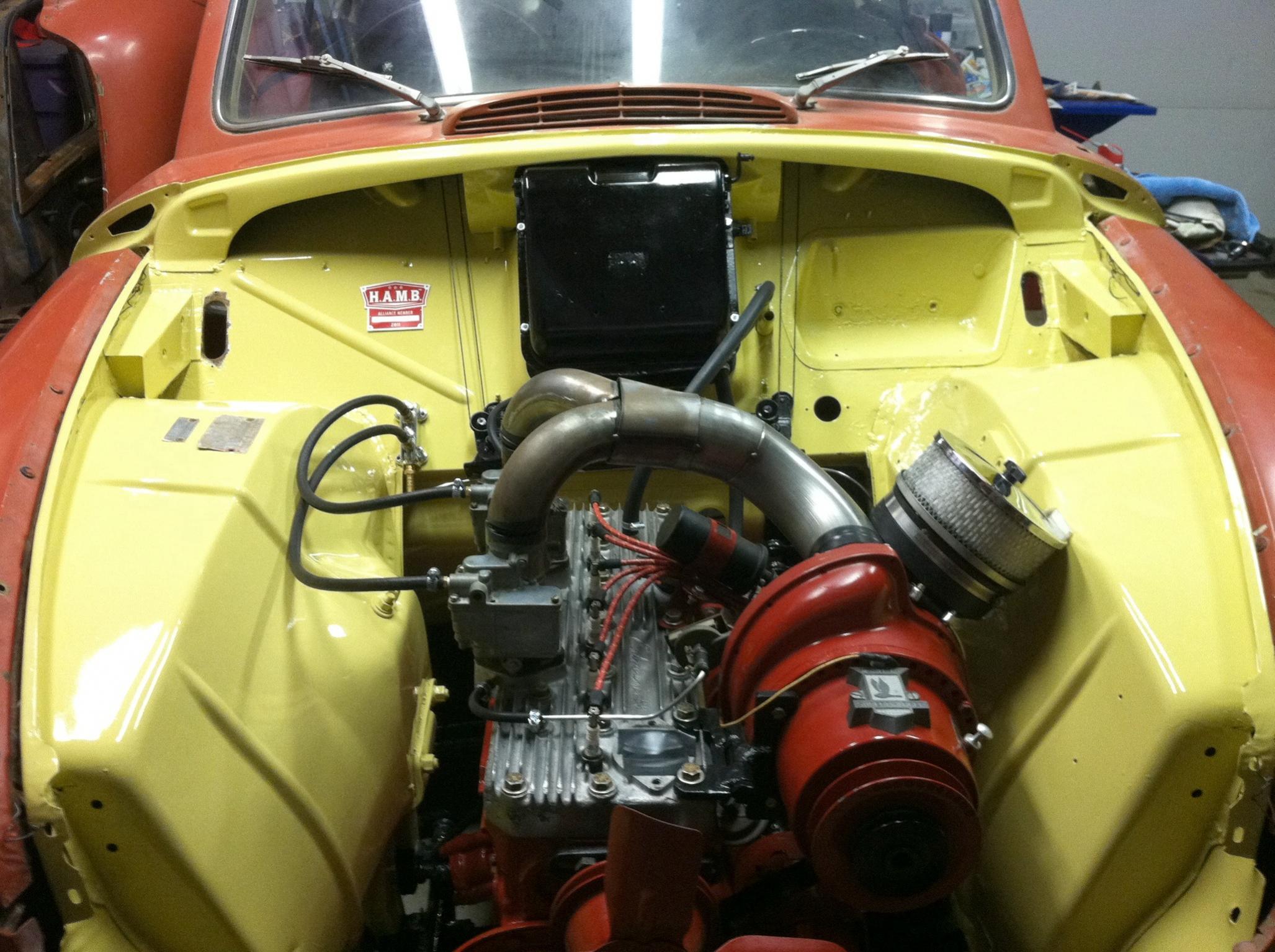

    Here's my supercharged Nash straight 6
    Almost done!

    Woha, that's cool. Funny, too, as I was just sitting here thinking about combining an early Rambler with a Karmann Ghia body to make a Facel Nash, and wondering what an appropriate drivetrain might be.

    OK, I'm only ignorant until I ask, so here goes: Seems like added pressure to the intake side of the carbs would pressurize the carbs and force gas back into the float chamber and overcome the vacuum produced by the venturis. GMC 6:71 blowers have the carbs on the intake side of the blower, and consequently increase the pressure of the entire fuel/air mixture simultaneously. How does this system work?
  30. nexxussian
    Joined: Mar 14, 2007
    Posts: 3,237
    nexxussian
    The fuel pressure has to increase the same ammount the pressure in the carb does.
    That is usually done with either a boost referenced fuel pressure regulator, or boost referencing the fuel pump itself.
    The venturis still work fine, but you likely have to jet the carb different as there is a larger mass of air passing through under boost.
