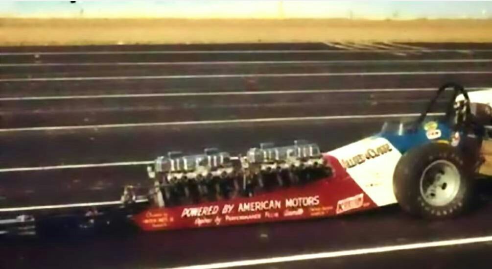

    Yepper that it is. The Twisted6 has run down many of the Vthings. Nice pick-up six ball

    I'm curious as to how the motors are linked together. Do two cylinders (one from each engine) fire in sync for 6 monster power pulses per revolution or are the engines staggered to provide 12 evenly spaced pulses for smoother torque delivery? In a drag race application which would be better? My guess would be the former will give a better 60 foot time while the latter would provide a lower final 1/4 mile ET. Maybe it doesn't matter unless it did!

    Most twin engine of any type are normaly linked via a coupler crank end to crank snout. With a dist. on both motors.
    not linked in anyway.

    My guess would be dependent on how stout the rest of the drivetrain is.
    If you have some really heavy duty parts and super sticky "big tires", then 6 "monster" pulses would be the way to go.
    If your drivetrain is more "slightly modified standard car" fare, then you might be better off with 12 "regular" pulses.
    So how would you synch the motor for 12 pulses?
    Crankshaft on one engine 60 degrees off from the other?

    I'm guessing both #1 cylinders fired simultaneously and etc.
    I'm guessing it would be easier on crankshaft life if done that way - especially the rear crankshaft.

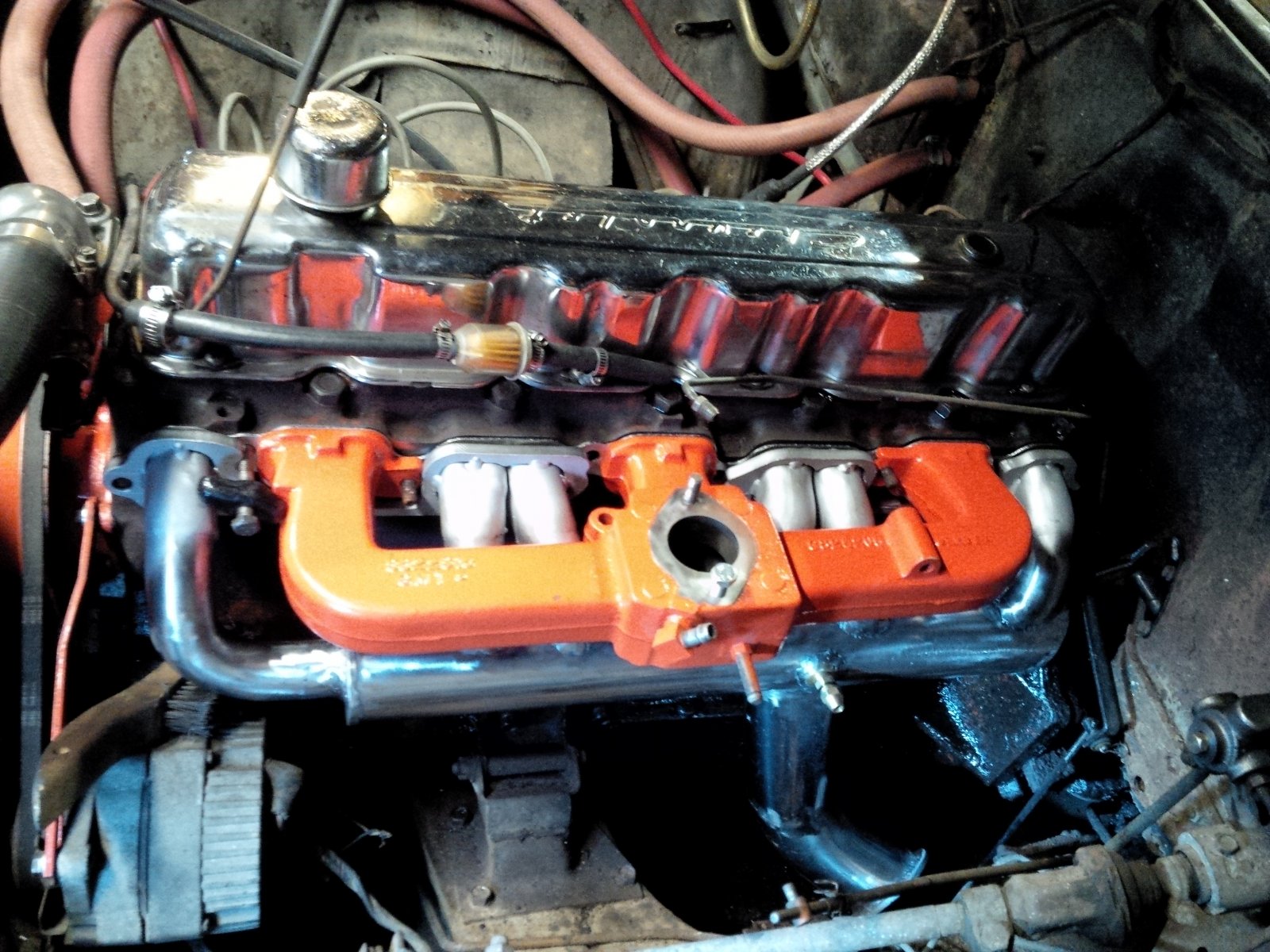

    Ive got a stock(for now) 230 in my 63. Its got 89k orig miles. I built a header out of stainless an am gonna add a cam, lump ports, and i wanna turbo it. I love the sound of an inline with a header!

    Nice job on the manifold.
    I like the chromed valve cover, too.
    Remember though, the 6's were red. Only the v8's were orange.
