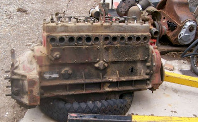

    IMG_0309.JPG not 6 but I got 8 in a row

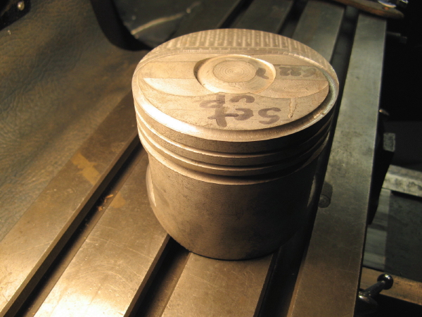

    A 352 piston can be used in a 300 six IF the tops are milled about ,050", depending on how much deck height you want to end up with.
    A 390 FE piston can also be used but since the standard bore on a 390 is 4.05 that requires an overbore of .050 to work - more than I like to start out with as little material is left for additional clean-up boring.

    You will also have to match wrist pin bore sizes of the the FE which I think are .975".

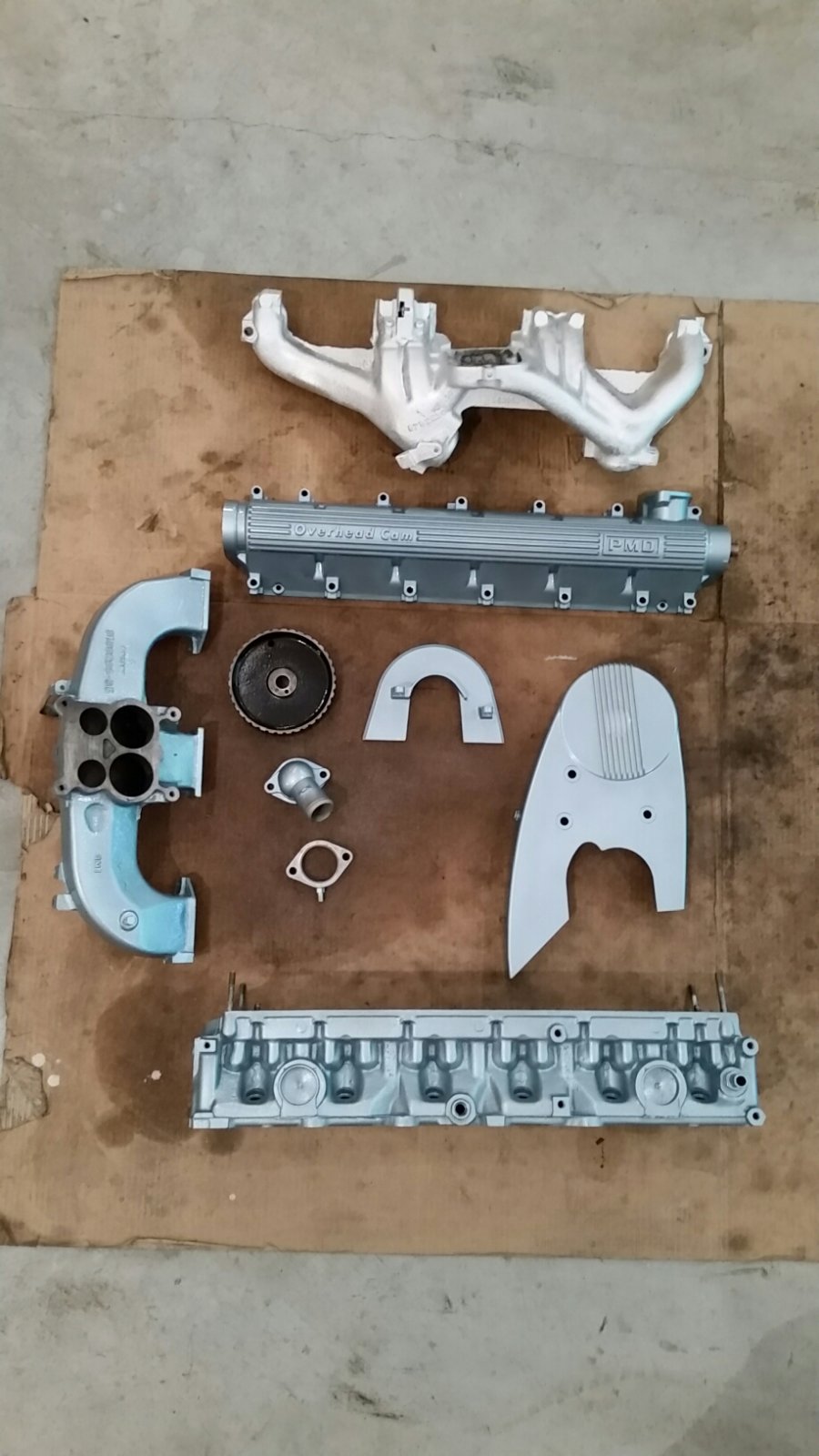

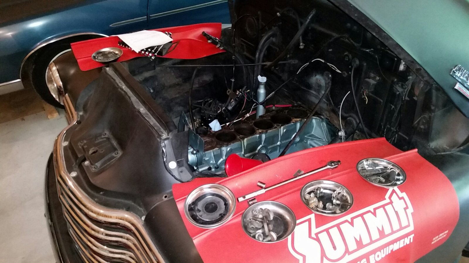

    Getting ready to put the topend back on my Sprint 6 in my '52 pickup.

    Let's see, 4 bbl., dual exhaust...if your '52 has a 4-speed, you could tell people you have the world's only 442 pick-up truck! ;)

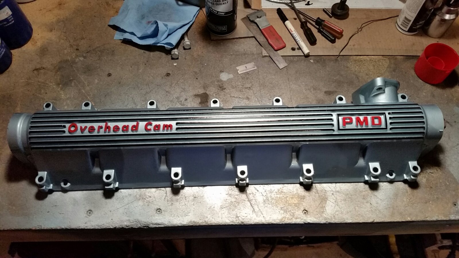

    The truck has an s10 T5 in it for anyone wondering. I got the cam tower all painted up last night. :)

    Gorgeous!
    Nice job, GTA9I. :)
