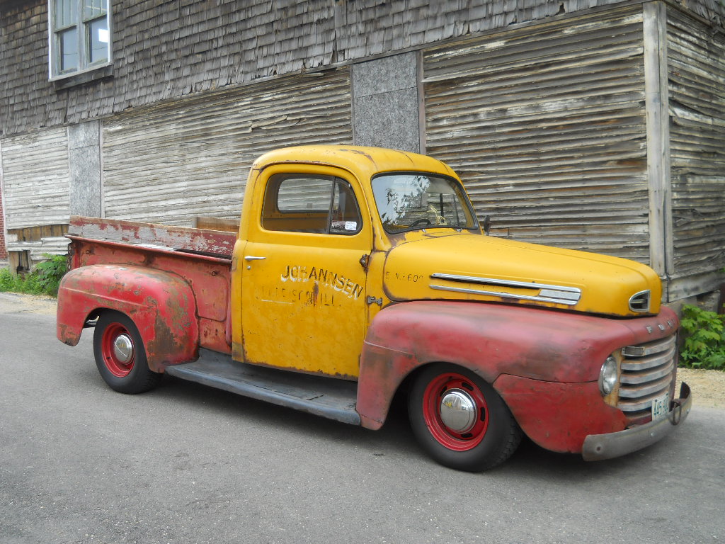

    ...I've run lots of 230 & 250 Chevy sixes in my old trucks/cars;...when I put one in this 48 F-1 my nephew said "you just made it bulletproof"...it's not purty so I won't even show it but I love them inline sixes.

    All I see on the outside is the truck's lowered a little (spring under?) and different wheels and tires but what a difference it makes.
    Nice stance.

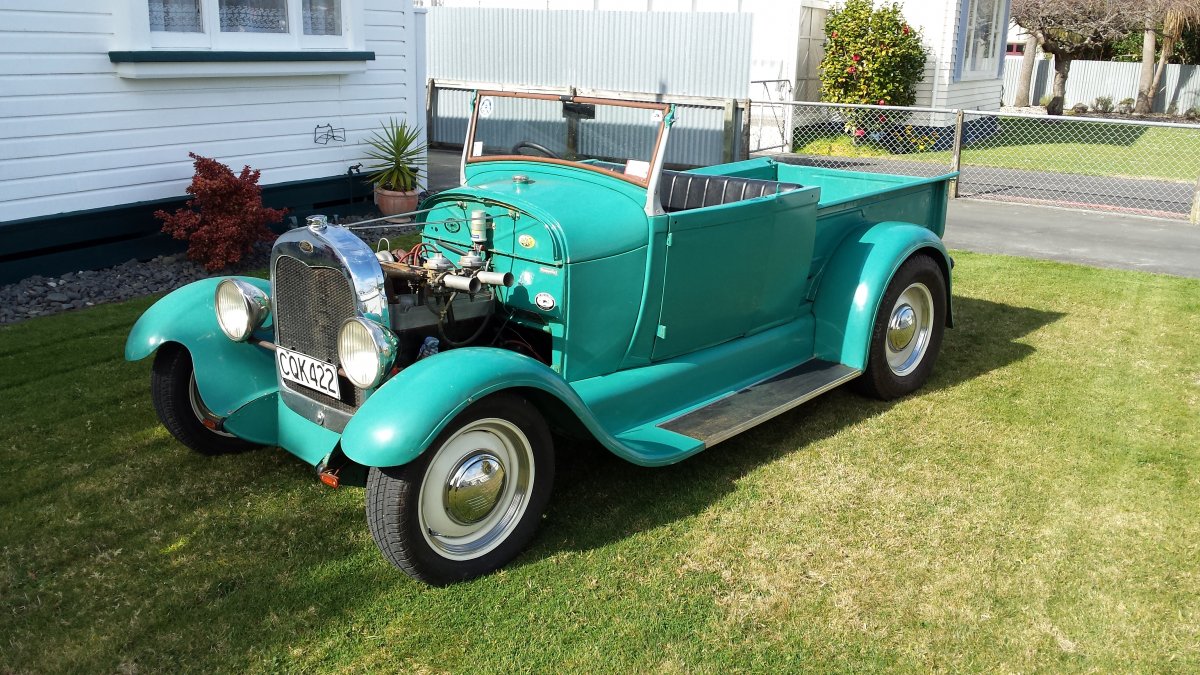

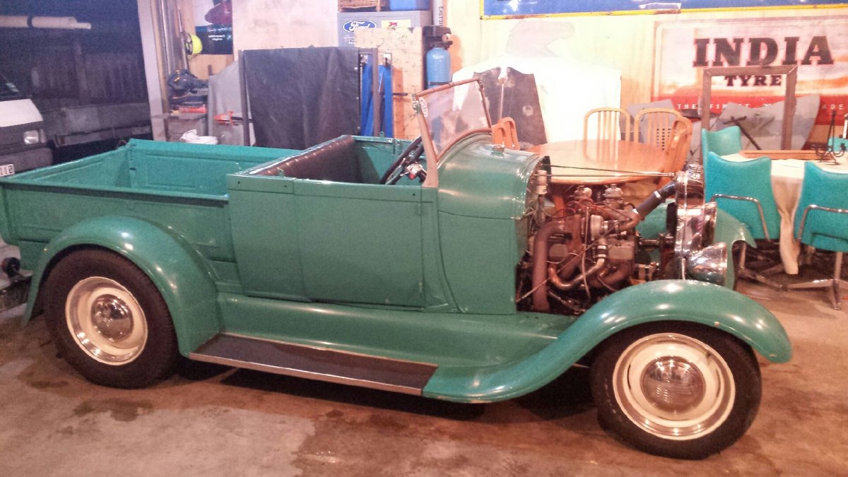

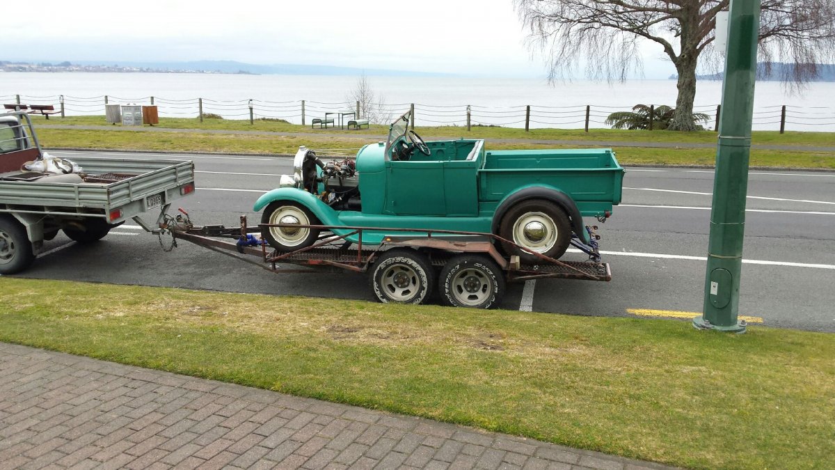

    Just spent a couple of hours going through this thread. Always loved my six cylinders & have had a hankering for a Mopar flatty 6 in a Model A. Have just picked up a 28 Model A roadster pickup with a turbo'd 4 banger & Thomas alloy head. Got a 53 Dodge truck motor out of a 53 Dodge panel van imported to NZ about 6 years from San Diego (an ex HAMBers vehicle I believe). Have got an Edgerton head, side covers, & twin carb manifold for it. The Dodge motor is a 23 incher but would like to know if anyone has done this without moving the radiator forward or recessing the firewall too much. I'm 6' 4'' so leg room is an issue. Looking for ideas on a suitable gearbox as well. Running a NZ built speedway quickchange (Halibrand copy) with a tall final drive. All thoughts appreciated. imagejpeg_2(1).jpg Model AC.jpg Model A1.jpg

    from Nevada
    I can not answer your questions but I love your idea. That is a sweet car just as it is. I saw Edgerton's truck a Bonneville what a cool looking engine. I have a 413 CI Dodge flathead six and it would not fit in a Model A. maybe the bed.
  22. 6narow
    Joined: Jun 1, 2008
    Posts: 563
    6narow
    Nice ride, Mr.Dodge!
    What I am noticing is the shaft for the fan seems unusually long.
    Seems like there might be enough room for the six without mods.
    What do your measurements say?
    As for a ******, you could run an A833. That's the 4 speed overdrive trans that Chrysler used for years.
    Gearing is spaced like a 3 speed and 4th features 27% of overdrive.
    If you like the gearing your car has now, you can simply divide the axle ratio by the overdrive and that will give you the new ratio you'd need to run.
    So, for instance, if your drive axle features a 2.7:1 gear ratio, you'd simply divide 2.7 (axle ratio) by .73 (4th gear ratio) and you'd end up with a number just on the high side of 3.7.
    Thus you'd change the axle ratio to 3.70:1.
    ...otherwise, nothing wrong with a T-10. =)

    Thanks for your responses guys
    Six Ball - Yes, earls truck is very cool. The 413 wouldn't fit in the tray, let alone the engine bay !!!
    6narow - There is enough room, as long as I don't want to run a fan...or a waterpump !! A833 are few & far between in this neck of the woods, not to mention pricey. T10 & S10 t5's are available but nothing under about NZ$1200 and this is a budget build. I'll just keep hunting.
    Thanks chesster d5, I have been following dumprats build. Its cool
    Plan at this stage is to drive this thing over summer & mock up my other A ch***is with stock firewall, radiator and engine to see what will/won't work. Any time saved will be a good thing though

    ****** - might have to start looking at whatever's available in NZ. I would think any Dodge ****** would fit.
    Engine - You say the engine will fit if you leave off the waterpump and fan. Fair enough, ever heard of "thermosiphon"? model T's ran this way. Engine heats the water and the natural reaction of heat rising sends it up and into the radiator.
    While your engine doesn't sit as low, in relation to the top of the radiator, as the old T engine was, you could augment this action with an electric fan or two.
    One problem might be fitting the fans. They'd likely have to sit on the front and that might be unsightly.
    Otherwise, the only thing I can thing of is cutting the frame and adding in extensions, so the engine can fit.

    Anything worth doing is never easy!! I've seen the thread on Rod Bods, pretty cool. It may be that I end up with a combo of recessed firewall AND push the radiator forward. I like the proportions the car has now so really want to retain them if I can. All good ideas though. :D
