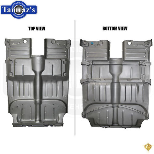

    get one of these. it looks good in the picture.
    saw them on the ebay.

    I'm a little late joining this topic but I'm in the same boat now. My floor is toast and I wondered about channeling the floor vs buying new. I looked into the one piece deals -1000 bucks+200 to ship. Nice product and maybe the best route. Not to cheap out but I was curious too what challenges people who've gone the channel route encountered.
