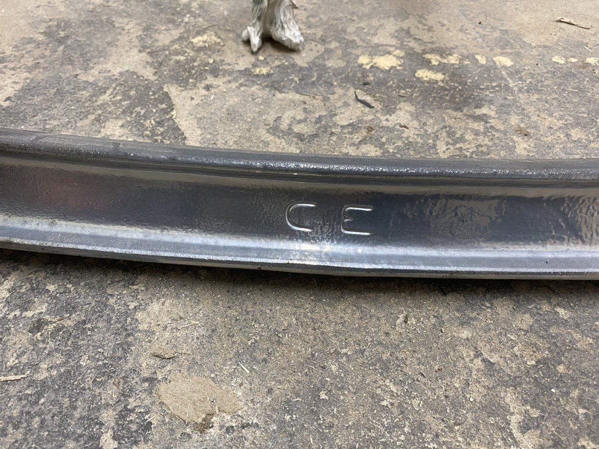

    Who here has drilled their chassis engineering axle? I'm getting prepared but the CE stamped dead in the center is throwing off my pattern layout. I've read on here a bunch have drilled out these axles, can you show pictures how you went around the CE, through the CE, filled the CE, etc. Plan is to go with either 13, 7/8" holes spaced 3" apart on center OR 17, 7/8" holes spaced 2" apart on center.

    Over the years I had dozens of CE axles drilled with no problems. I never had a logo in the center of any of the axles. Do you have one of the CE style forged axles from P&J's. I've never seen one but they may have put their logo in the middle. I've also had some P&J cast axles drilled and I had them smooth the logo out of the center of the axle for an uninterrupted line of holes. I'd go with the 2 inch spacing.

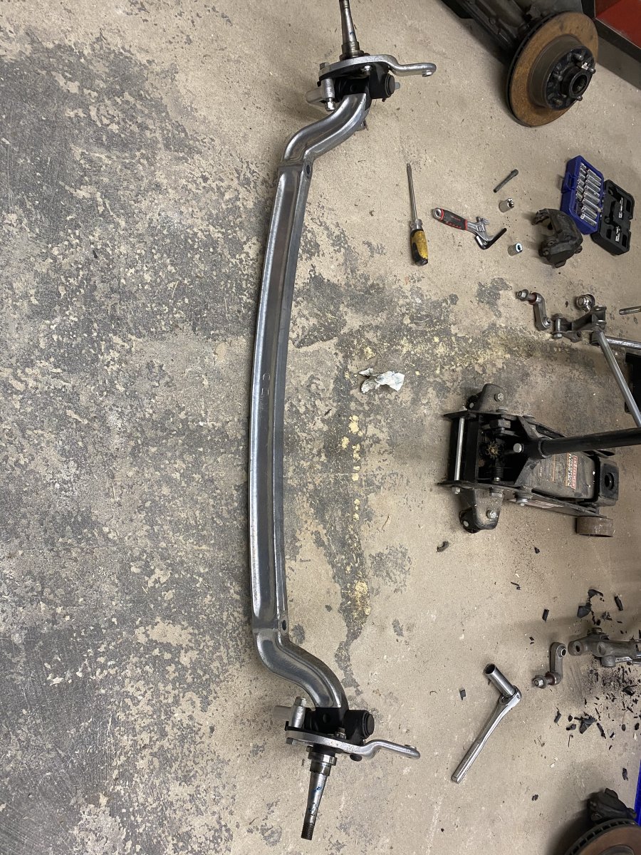

    Here’s what mine looks like. I believe it’s forged? I didn’t know CE made an axle that was not forged?

    If the logo is only on one side, flip it towards the rear and drill it how you want. That logo is not very prominent, you could probably drill it how you want and no one would even notice if a hole was in the middle of the logo. Unless you are super anal, which some folks are.

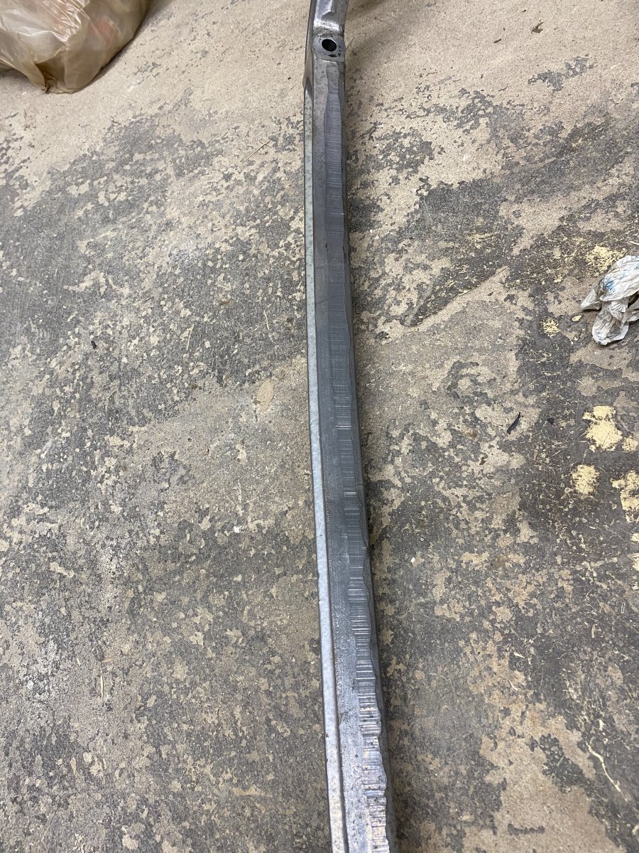

    Show a pic from the top in order to see the parting line that runs down the center top of the axle.
    If its cast I sure wouldn't be drilling holes in it personally...

    When I balance it on one end and hit it with a hammer it has a ring to it. Not forever ringing, but not a thunk. I thought this was the tell tale sign it was forged? I associated the lack of an 'ever lasting ring' to the fact that spindles are still attached and potentially buffering the sound a bit.

    That's forged. A forging will have a wide ground area from the parting line of the dies. A cast part will have a very narrow parting line from the mold so consequently the ground area will be narrow.

    Well to add more to this - I just got off the phone with Jason from P&J and got a history lesson.
    This is for sure a forged axle, made by CE up until the late 90s. Prior to the CE, the tooling for this axle was owned by Vintage Chassis Works. Those axles have a VCW in the top right corner. There was a time period where CE was forging these axles but with a VCW in the top right corner. They later changed the tooling to have a CE logo in the center. CE later sold the tooling to P&J for this axle from them. P&J forged axles with the superbell logo in the center use the exact same tooling as the CE axle with the CE in the center, but they changed out the tooling to show the superbell logo. Other tell tale is the CE forged is 47" kingpin to kingpin and uses a 30" spring.
    Other fun fact, P&J forged axles are manufactured in the same facility in Ohio as the CE axles were once forged.
