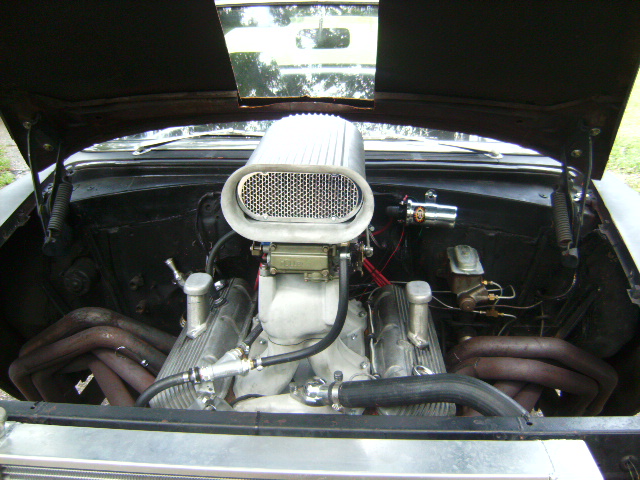

  2. Chec out the pics in my albums. The yellow car has custom made headers from somewhere in Minnesota. The project car 55 has Sandersons that I welded about 10" extensions onto because I like them to dump way down low, and I think they look cooler.
