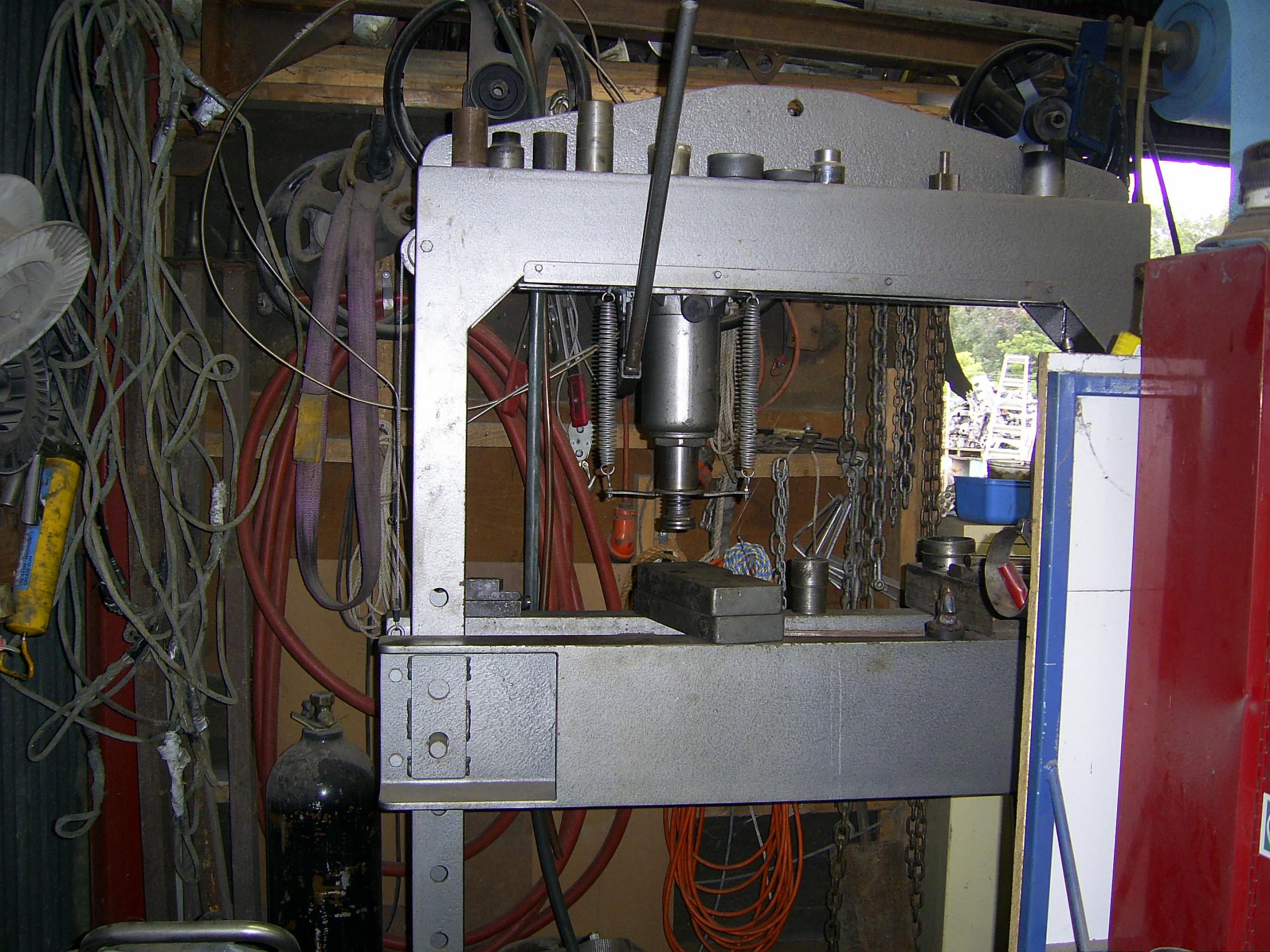

    made this one around 7 years ago. mostly made out of scrap/offcuts etc. the winch came off my old boat trailer when i replaced it years before. the jack is a 30 ton import job, reckon it's good for maybe 20!! it was sold as an upside down jack but really it's just a normal jack that has been replumbed inside with an oil pickup to work inverted. i also reworked the action of the handle so you pull down to pump instead of push up which is how they come. mounted the jack on a slide so you can move it along side to side for when you get an odd shaped item in there. real handy idea and fairly easy to achieve.it's probably overbuilt but i figured i'm only doing this once. use it heaps for bending plate steel, bearing removal and fitting, straightening etc. invaluable..............chop:cool::cool:

    That is my dream press!Overbuilt whatever!That my friend is an impressive piece!

    I have a big ol' one that a welder/fabricator built in the early '60s or so. It uses just about any hydraulic bottle jack. Looks alot like chopped35's, actually- winch on the side & all. But the jack isn't mounted upside down.

    Scrap eh? Damn, I wonder what you would have built if you have new materials... :eek:
    That press looks real sturdy and good!
