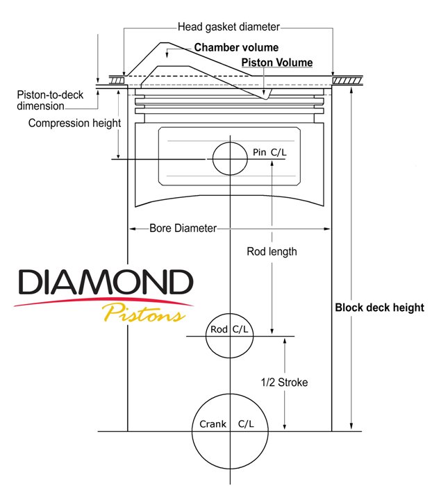

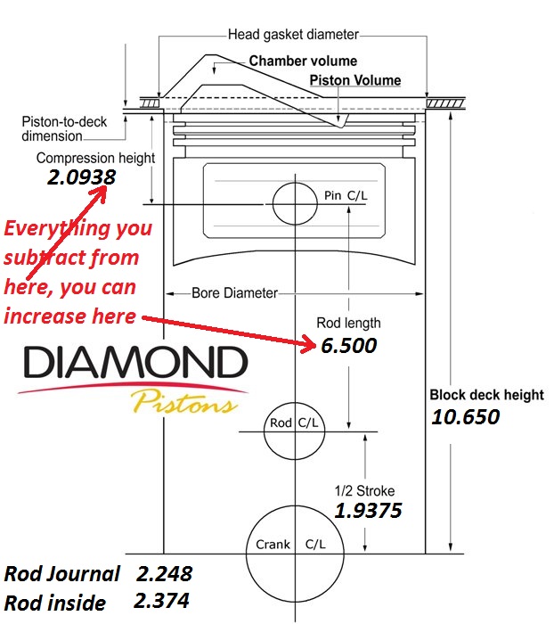

    If I haven't had another brain fart.........Big "IF" there. The deciding factor seems like how much "compression height" you need to have room for your rings . If you take something in the range of 1.430 I think you have about .660 you can add to your rod length. There is room for some fudge factor on ring placement. I'm wondering if since 4.00 in bore is such a common size, if it might be possible to find a standard aftermarket piston that would work. Also, the diameter of the piston pin will affect this.

    It looks like you did your homework pretty well. I looked on the Scat site and the best option I could see was the Pontiac rods with the 2.249 rod bearing. I think I would at least check and see if there is room to widen your journals and put good radaii on the fillets before I tried narrowing the rods. If it has room, you could then just use stock Pontiac bearing that you know fit the rod correctly. There might be a little room to narrow the rod slightly without getting all the way to the side of the bearing, but anything you can do to keep the Pontiac bearing in the Pontiac rod seems a better choice than using the Cad bearing.Both rod bores are the same per my old Federal Mogul catalog but the part numbers are different. May be due to width or maybe tang placement.......or both. I guess you could just insert one of your old bearings in a new rod before you decide. Got any buddies with an old Pontiac laying around ?
    Buy one of these and see how your plan works before using high dollar stuff.
    https://www.ebay.com/itm/PONTIAC-V-...643647?hash=item2cdac1043f:g:ybMAAOSwznVaz2ch
    To answer your original question: If you have the rods milled, any decent machinist can machine them down easily. Be sure you stipulate that you want material taken from both sides equally. You may assume he knows that, but since I'm a former machinist I will tell you to make sure he understands. The best thing is to finish them on a surface grinder. A conventional mill is somewhat precise, but a surface grinder will make them all the same because they put them all on a table at the same time. Turn the magnet on to hold them. ZThen as the table reciprocates back and forth under the grinding wheel they all come out exactly the same......and smooth. If you only mill them, then leave a .001/.0015 on each face and finish them by putting emery paper on glass or a flat surface and lapping the last .001 off them.
    Since you will probably be having your crankshaft ground anyway, I would look at the idea of widening the journal as a first consideration (along with nitriding it). If thats feasible then the rod narrowing becomes moot.
    Sounds like a nice project.....keep us up on it !;)
