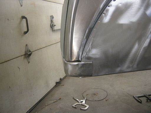

  28. I have posted this before, but here it is again. This roadster body is handmade except for the gas tank / hood and some pieces from the front fenders.
    Lars
  29. Here are some building picks.
    Lars
