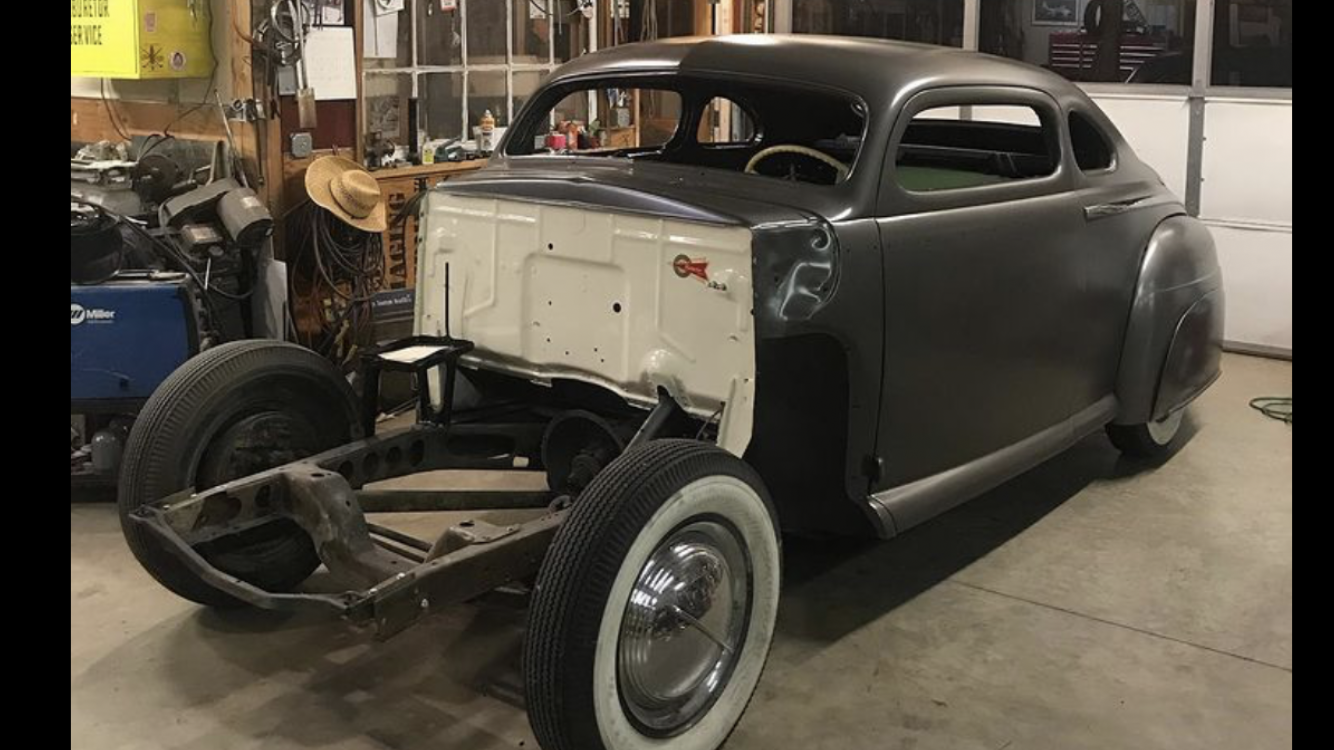

    I am slowly trying to finish my chopped 49 Buick. Chrome is sent out for replating, and getting the body ready for paint. 1949 Buick .jpg

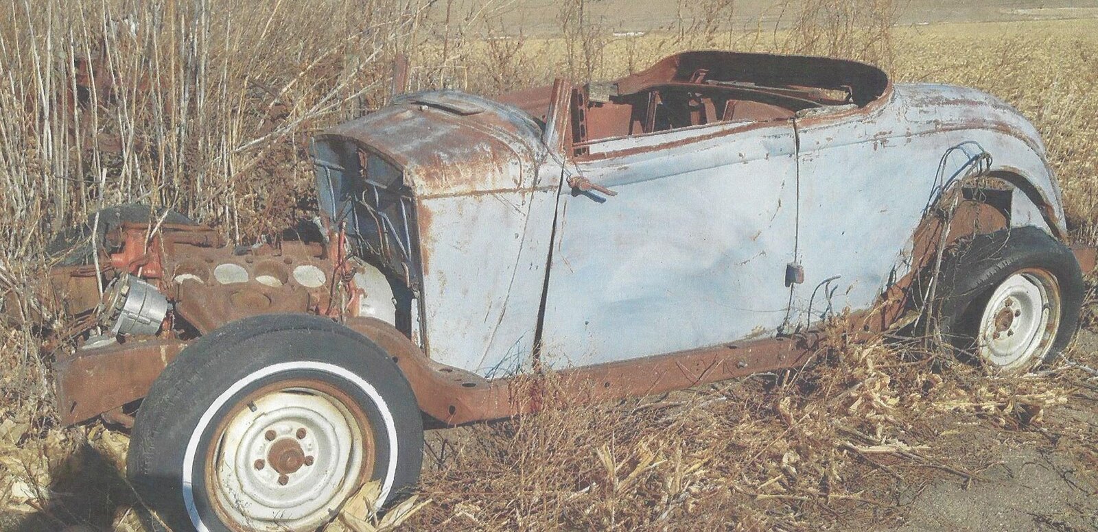

    Still parts gathering Saw this pic when I was 10. Bought a 33 Plymouth and did a concept with an x-acto knife. Got a trumpet horn coming this week. A pre 40`s custom with hopefully a 52-53 flathead 6 spitfire motor and a stock frame. Named Soldier`s Joy. Scan0654.jpg Scan0607.jpg Scan0751.jpg

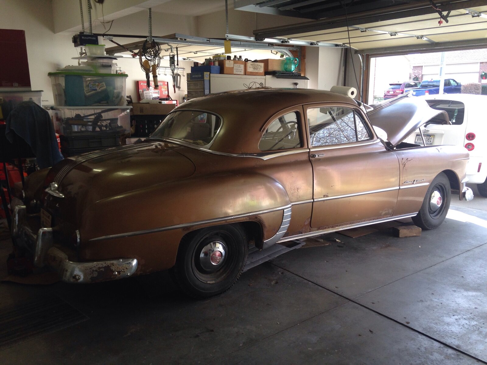

    Great question....I suppose I'll prolly do a mild custom with my old 50 Pontiac. Thing is, I absolutely HATE fender skirts, visors and fake **** like spotlights and curb feelers. It'll prolly be lowered with the back up lights removed and whitewall tires. I may do dual exhaust for the straight 8. 50pont12_2020.jpg 50Pontiacgrillepolished4_21.jpg

    That Pontiac is great!

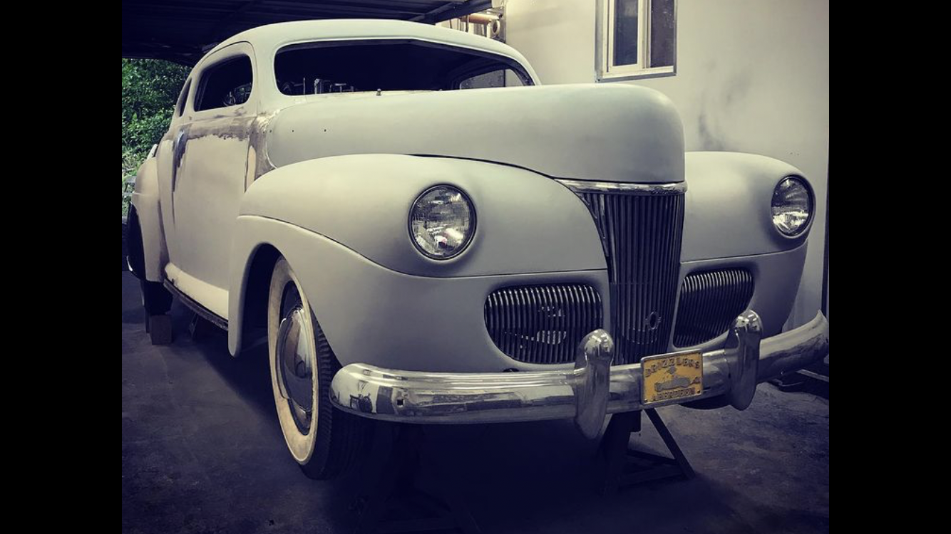

    I have this on the go.
    I have been at it for quite a while. Originally a tudor, now converted to a three window coupe using the sedan roof and a trunk lid from 39 LaSalle.
    3in roof chop, channelled over a custom frame I built, 350-700R4 Ford rear end. The dash has been modified to accept a 1950 Chrysler cluster.

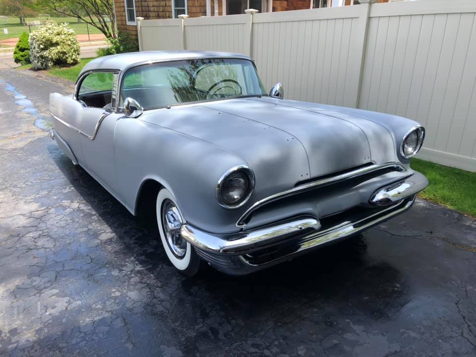

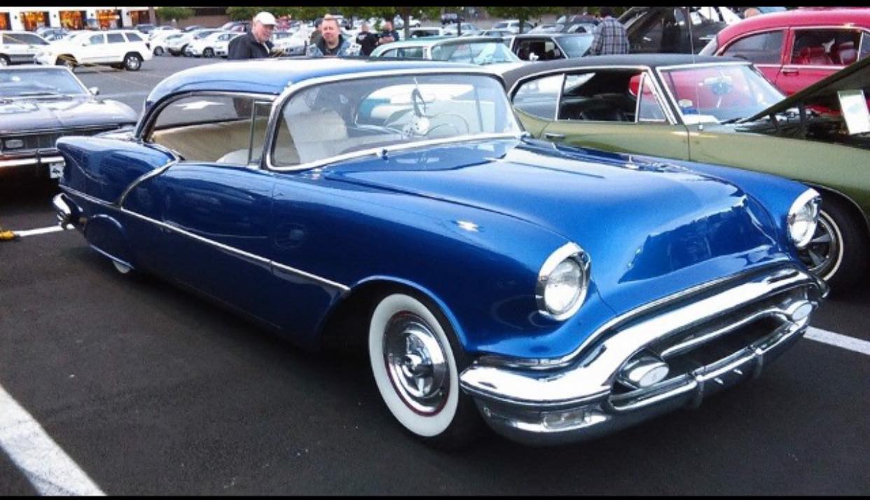

    I am, always have a custom in the works (actually2 right now). Been working on my 47 Chevy for years now. Mechanicals done, the heavy bodywork done. Just have to raise funds for chrome plating, and upholstery.
    The 56 Olds will be done first. Converting it to a Nomad style wagon. Custom? Concept car? Phantom vehicle? Blurring the lines on this one! It IS chopped (1 1/2"), semi frenched headlights, 98 tails and side trim (car was an 88), shaved doors, nosed, not sure about decking, with that cool Nomad chrome. Lowered, skirts, emblems removed. 100_1013.JPG KIMG0133.JPG

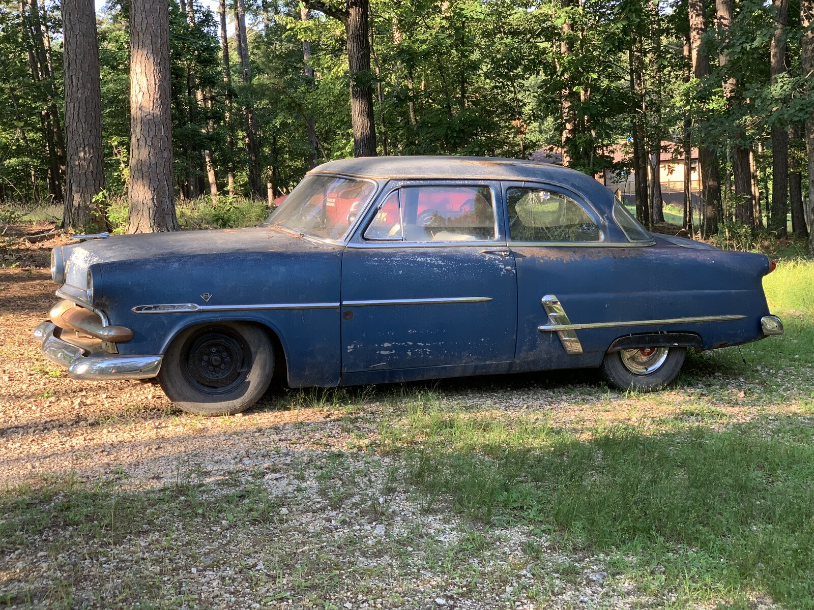

    I have two custom projects. 53 Ford 2dr Customline. Static lowered with 4” blocks in the rear a 2” lower springs in front. Those springs are not installed yet, so it’s sittin on the bump stops. It will have air shocks all around, for a poor mans air-ride. The rear is aired up a bit in this photo. Will shave some emblems. Some new gl***. I just got some 3” port-a-walls I’m itchin to put on. I plan a chrome bullet grill. New blue pait and gold scallops.

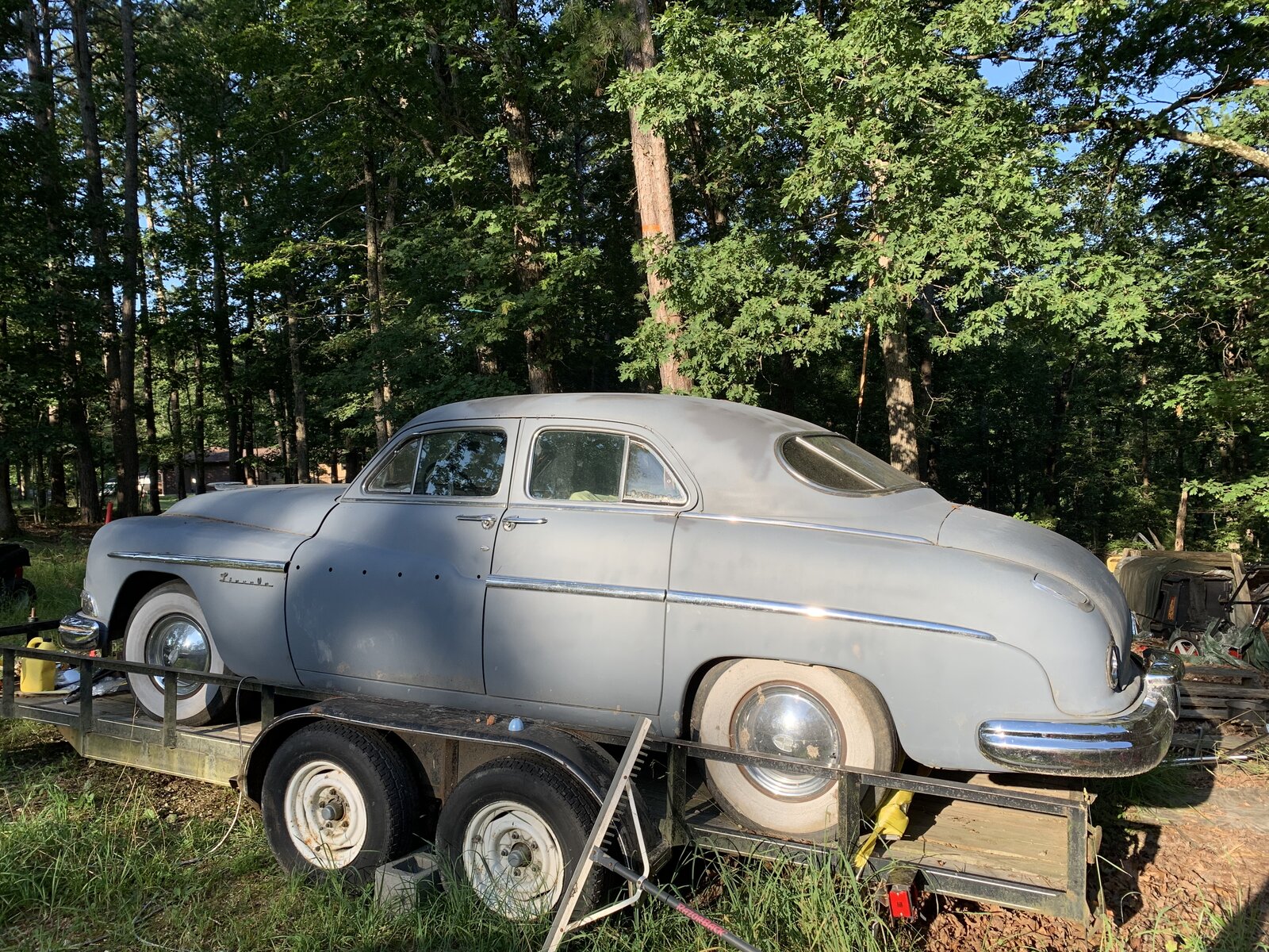

    the 1950 Lincoln will get skirts, side pipes, lowering and paint. Maybe quad headlights. Maybe a chop if I can afford it. Both get nice interior.
    The first time either one hits a pot hole and bottoms out, they get modern suspension upgrades. I don’t give a **** about traditional, when my back hurts. A5B88236-FD48-42FE-B628-6DEFA2CEAD39.jpeg 5C98880B-CDC7-4850-84DD-2BB41C3A6EB2.jpeg
