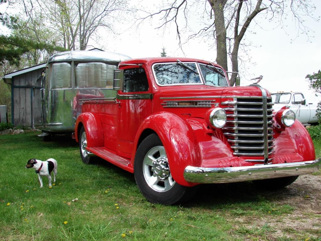

    If you love to get dirty, black-dusty and destroy your clothes for 40+ hours, come on over this weekend. It's camping season and the 1960 Avion is getting a rub down. I am not looking forward to the 4 stage buffing process (Nu-Vite)
    Some have comented on my single rear tail light being unsafe. If they can't see me now with a giant shiney trailer, I don't know how much safer I can get. It's hard to even wash it without seeing sunspots for an hour.
    I won't be posting much next week or two as my arms will be noodled out from holding the buffers [​IMG]

    My arms are sore, clothes are black and although it took an entire day and evening, the results are satisfying at best. I still need a day to do a final polish with a cyclo buffer ( 2 heads to reduce swirls) that I have and i think it will be close to what I had wanted. At first I thought " the barn find patina look is the new in thing, just leave it" but I tried some other techniques and failed. You can see the square smeared or dull area in the first pic up top and forward on the trailer. At that point, there was no going back. It's not a show polish-mirror, but close and is just rough enough around the edges to still take it down a gravel road to some remote spots up here in the NW.
