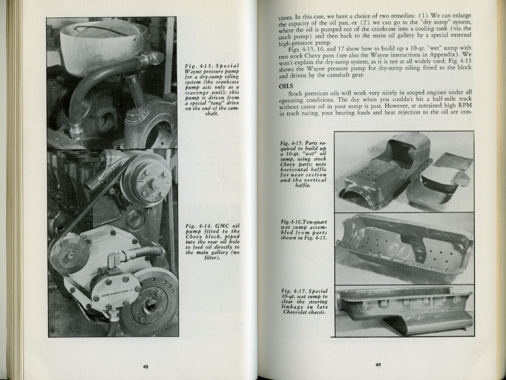

  8. Gofannon
    Joined: Feb 8, 2007
    Posts: 984
    Gofannon
    Here's how Wayne did it.
    mgtstumpy likes this.
