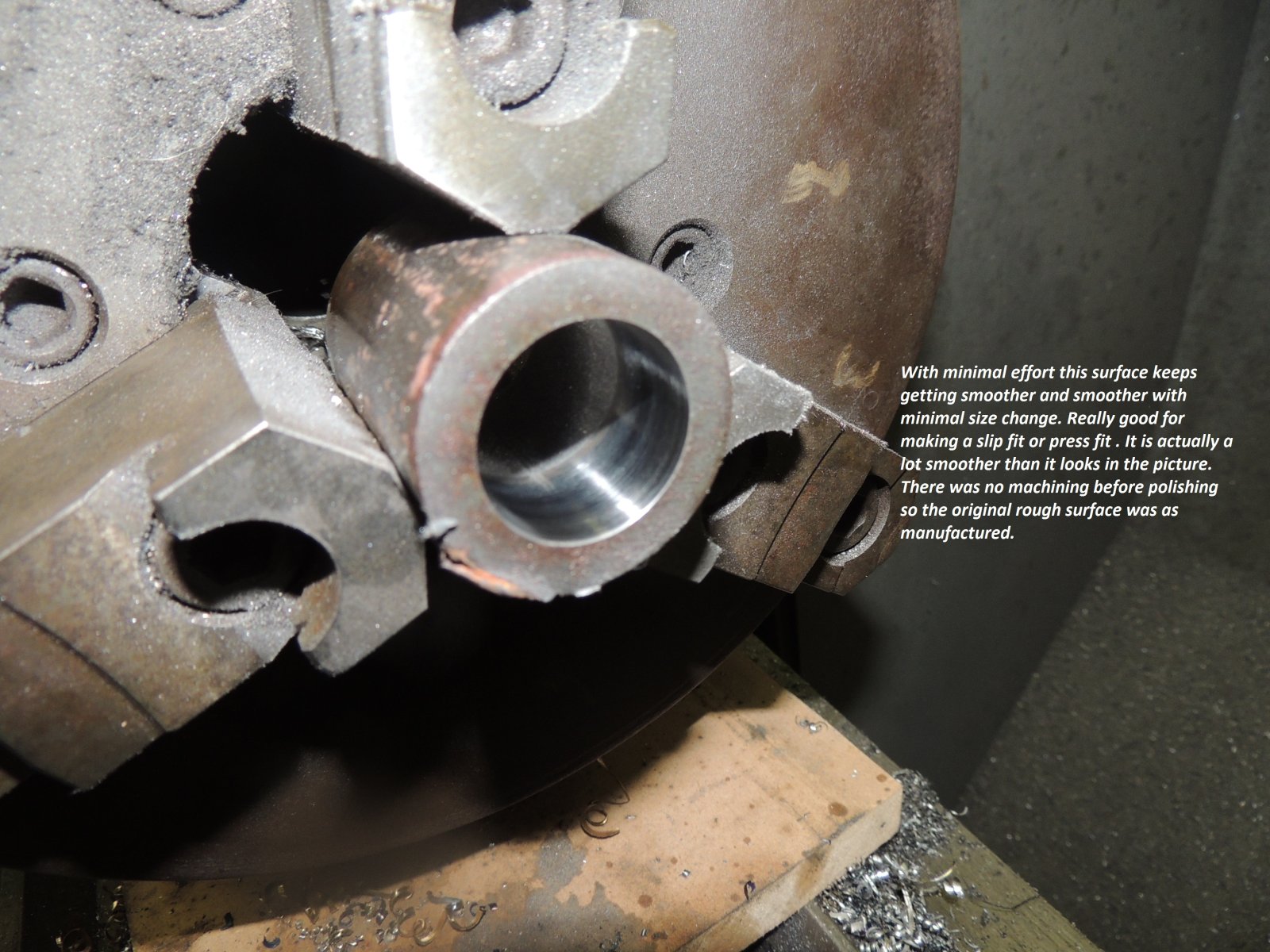

    A simple way to true the jaws would be to ****m blue them and scribe some lines to cut to. Then put a square on a belt sander or one of those disc sanders with a table. Gently put each jaw against the square and dress the end of it. This would not work with a 3 jaw chuck but with a 4 jaw all you need to do is get it square.
    If you want to try grinding while the chuck is mounted and spinning......I would get a round ring that you can slip over the outer steps on the chuck, ergo the surfaces used when clamping a part internally. Just snug it initially so it doesn't deform much. Then use a dial indicator to see how round you can adjust the ring. That puts some tension on the jaws so they don't move when grinding and centers them as well. Then I would use a grinding stone with atleast a 1/4 shank. I would use a short round stone with a larger diameter. That way the stone will have less tendency to become tapered as you grind. I would use coolant too.
    If you have a tool post grinder, thats great. If you don't then you can make a simple adapter for a die grinder to mount to your tool post, like the one below. Tool Post Grinder 6.JPG
