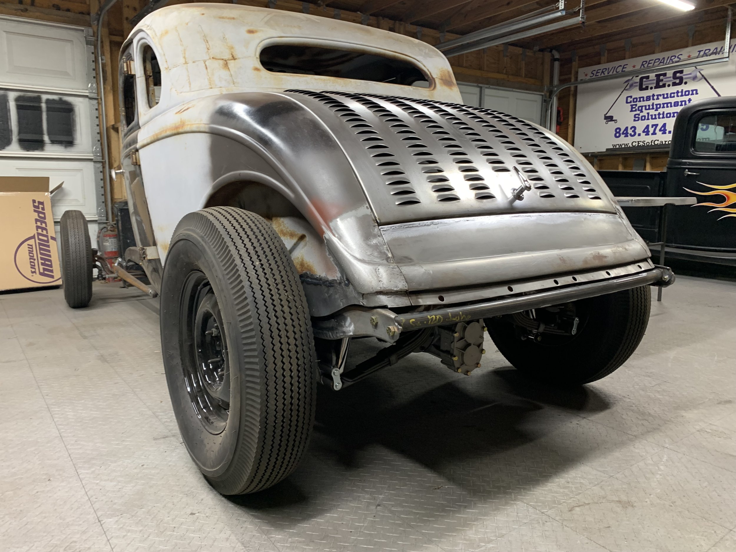

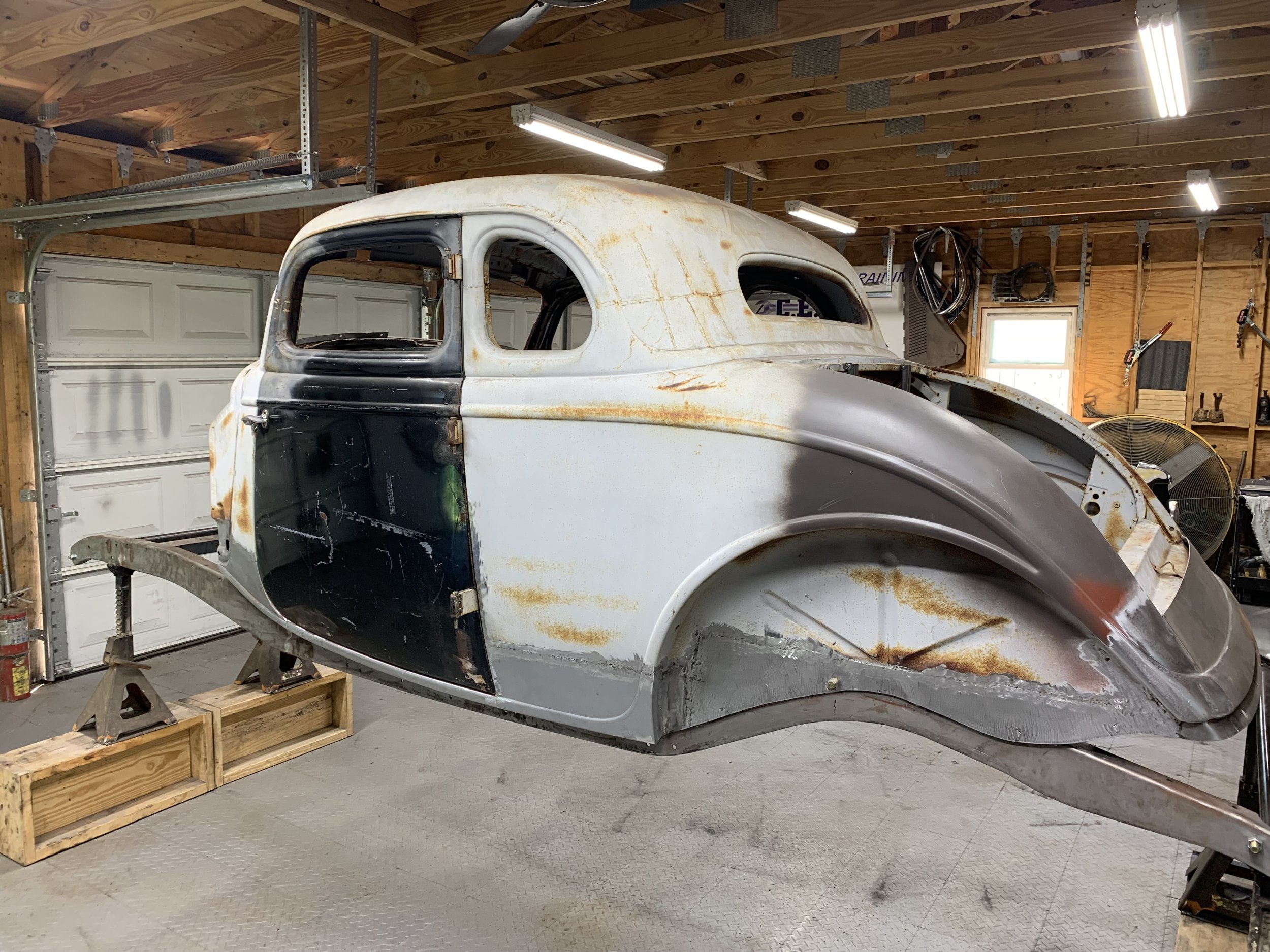

    I have used just about everyone’s panels over the years and they all seem to be about the same. There is even a possibility that there is one stamper that makes all of them, but that is only speculation….
    Here are panels from 3 different companies, two of which are sheet metal suppliers.
    I used to use Howells, which was always a risk, but Im not sure if they are in business after their “website got hacked”.
    I have a pair of inner fenders from Tom Bay and they are pretty darn good, but contacting those folks is a chore.
    Here in a the one I’m in the middle of right now, which has a little of everyone’s panels on it.
    Here is the last one that had about 4 different vendors panels on it. They all seem to be about the same.
    Good luck and don’t forget to post lots of pics.
    -Abone.
