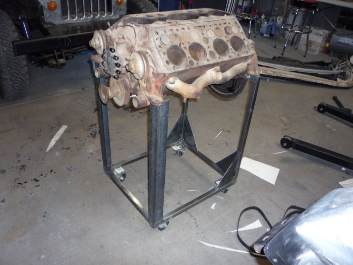

    It is not so hard building your own, I just found some pieces under my workbench and baked it together.

    Mean lean, that looks pretty clean:)
    I figure the best one was one that was made on yer own, just wasn't sure.

    I think it is more stable than if you try to hang it on the half bellhouse. I do not know if the bellhouse is strong enough to hang it on. It works pretty good, is easy to rotate.

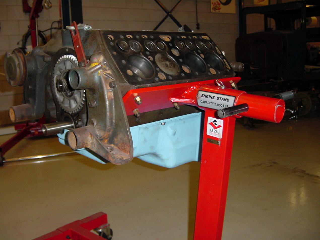

    Steve i used Vern's exhaust mounted plate & adapted it to my stand, as mentioned the old KR Wilson was the best available & that mounted via the exhaust flange so i guess it must be the best option.
    Original type.....
    Here's the plate from Vern, it doesn't come with the large hole i did that so i could weld
    the tube from both sides.....
    Added these for extra strength too.......
    Still stirdy with some goodies thrown on.
    Kev.

    Thanks for all the info and pics kev! looks like that works like a charm:)
    sweet motor by the way...awesome.
    Cheers mate and i'll give Dave a hug for ya when i see him:)

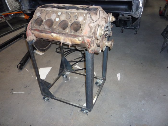

    I know it's not an engine stand but I fabricated this dolly so I could at least push my 8CM around before putting it up on a stand. On of these days I'll get around to welding some studs on the two posts to keep it from sliding around when you hit a crack in the floor!

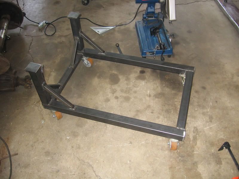

    Just built a quickie one for a customer. The casters disapointed me until I 75w90'd them.

    Conceptfab and Pinewood,
    Great lookin stands and thanks for sharing them here on this thread!
