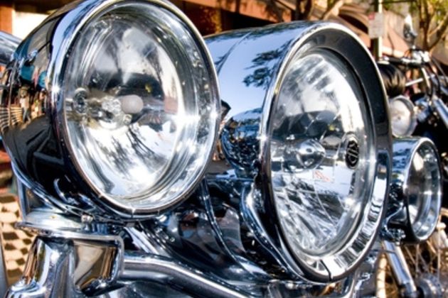

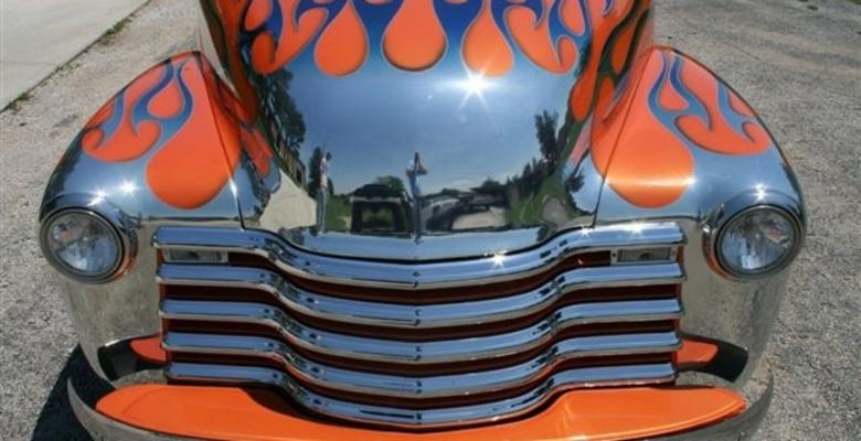

    You might be surprised at the quality of the Spray On Chrome process these days. While I would never do this to a vehicle, the finish is amazing
    All this Harley "Chrome" was done with spray on as well

  9. That 'chrome paint' photographs better than it looks... and it's not durable. Go look at Jivin' Jer's coupe thread (posts 2328 and 2334); he tried it on some interior parts, and it didn't survive the installation process.
