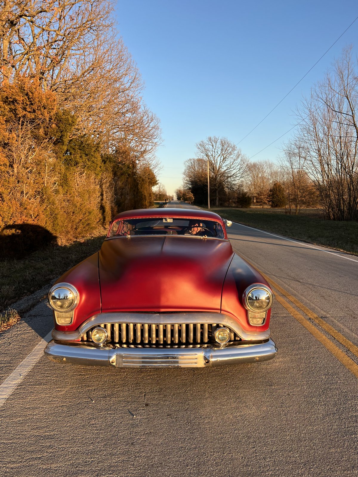

    Looking at how that car is chopped, would a stock gl*** fit anywhere? It looks to me like it has all been changed rather than simply shortened.

    This is the major stumbling block. A lot of chops are just done without a thought for being able to use a cut down original windshield. When you change the opening size and curvature too much, the only alternative is a one-off full custom item. This is the point when guys realize what they have done and the problem they have created.....:eek:

    I cut the windshield for my 55 Olds back in 1984, because I could find no one to do it. It has a LOT more curvature than yours. It can be done, IF the chop was done correctly (with regard to using the stock gl***, cut down). You don't want to have a custom gl*** made, if at all possible. Costs run from 3000 to 10, 000$ from what I've heard from guys who have had it done, or priced it out.

    How much chop? What did you do about seat height?

    that opening is so small nothing going through it in a collision except a piece of mail....
