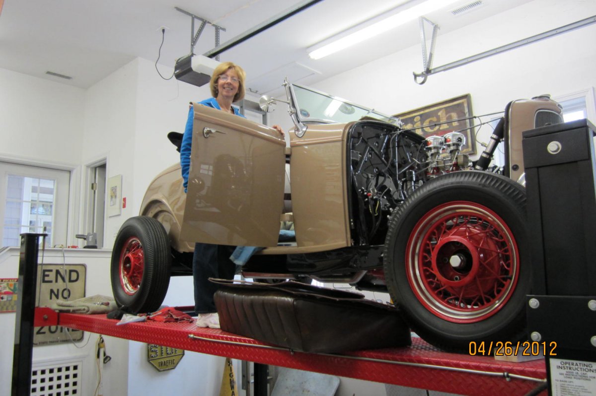

    If you plan it and have a diagram to follow it can be easy and fun. Did my roadster with the help of my wife fishing wires for me. Made my own schematic in color to match wires. One light circuit, one power.
    Wiring 001.jpg Wiring 002.jpg 002.JPG 001.JPG 006.JPG 001.JPG It is rewarding!

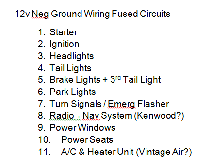

    What I've come up with so far... can some of these be combined ?

    12. Horn - Or a "HORN BROKE, WATCH FOR FINGER" bumper sticker

    good catch, Trailer
    A horn is worth a thousand words....or something like that.

    Many of the kits have a wire for elec fan and ac/heater. I do not like to take that load thru the panel but rather use these wires to fire a relay to turn on elec fan,ac or what ever. Speaking of wiring, going to go wire a 7 sec drag car tomorrow.

    You probably want to split the turn flasher/hazard flasher. The turn signals you will want to run through the ignition switch so they are off when the switch is off. You will likely want the hazard flashers to run through the battery power so you don't have to have the ignition switch to be on for the emergency flashers to work. Gene
