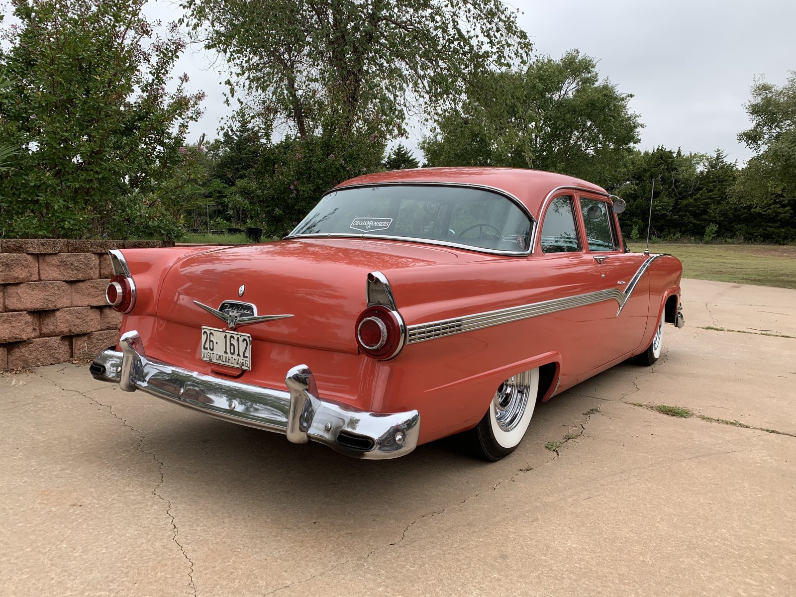

    This is what a license plate looks like after multiple uses scooping salt at Bonneville. Since I've had this plate for almost 50 years I'd like to get it restored. It's still the valid plate on Clarence.
    Who (on here or not) can restore this?

    Mike, your plate is in the same condition as the '36 Colorado plate i picked up for my truck. Soak it in vinegar to remove the rust, patch up the cracks/tears/holes with JB weld, spray the field the right color and brush in the letters. I did mine, its not perfect but Colorado DMV said it was good . If I can do it, " YOU CAN DOOO IT". Give it a shot. Mitch

    I did my 28 pa plate like Mitch described only I used rust 911.
    I tell everyone that my 5 year old grandson did it for me.
    Truth be told about your plate, with 50 years of history that includes Bonneville is way too kool to refinish

    I'm kinda with @CSPIDY here. I might give it rudimentary cleaning, just enough. Spray the whole thing with 2 coats of semi-gloss Krylon clear, get a small rubber roller from a hobby store and re-roll the numbers and letters. History preserved, legality (legible numbers) handled.

    My dad and I did a couple of plates with the krylon and a paint marker and they looked very presentable. I’m fixing to do several more but I’m going to soda blast them first and fix what few dings that are there and base coat then roll the numbers and letters then clear over them. They should stay looking good for the rest of my life and then my kids can figure out how to fix them.

    Mitch, I'm visualizing you smearing the JB on the back built up heavily over the cracks. Yes/no?
    Thanx cob. If I decide to restore to perfection I'll call him. And TIA if you snag a business card.
    To all; I never considered keeping the patina. Perhaps that's the way to go. Maybe if the rust stains go away it will be a lot more readable and the white will show up better.

    Yea Mike, I smeared it on the back as smooth and thin ( I did 2 coats) as possible. After the JB setup, the plate became pretty ridgid, I supose it would have failed if I really torqued on it. The back wasnt necessarily pretty but who looks at the back of a license plate anyhow. Right? Mitch

    I worry about all those cracks if should I try to restore this thing by myself (or to keep the patina). Is the JB the best way to go here or is there something I'm not thinking of that might be better? I'm thinking repair by even a great TIG welder would necessitate total restoration. And I don't do TIG; although I've got several friends who are very good at it.

  14. Those fatigue cracks just above " historic vehicle " look like the main problem for the next 50 years :oops: . First i would try to get the creamy background colour in shape. If you can at least get some colour back your almost home. If you lay it in fresh cleaning vinegar check it at first every half hour with a brush to see that the old creamy paint does,nt disolve. Don,t use dirty contaminated vinegar . Then what mitch 36 says. How about a new mounting bracket using the top holes ?

    The fatigue cracks are because it was mounted on the front bumper using only the two bottom holes and the wind pushing on it. When I use it again it'll be on the back (no wind) using all 4 holes. And I'll probably cut a backer of sheet metal to go behind that.

    I've made a backing plate for mine out of aluminum. Only have a rear plate per DMV, hanging from the top mounting holes, keeps the plate from flexing and cracking. Actually the 1/16" or so of JB weld makes the plate fairly ridgid. I kinda bent the rules a bit, after the DMV approved the plate, I somewhat distressed it so it wasnt so squeeky clean and shiney and better matched the worn look of the truck....Mitch
