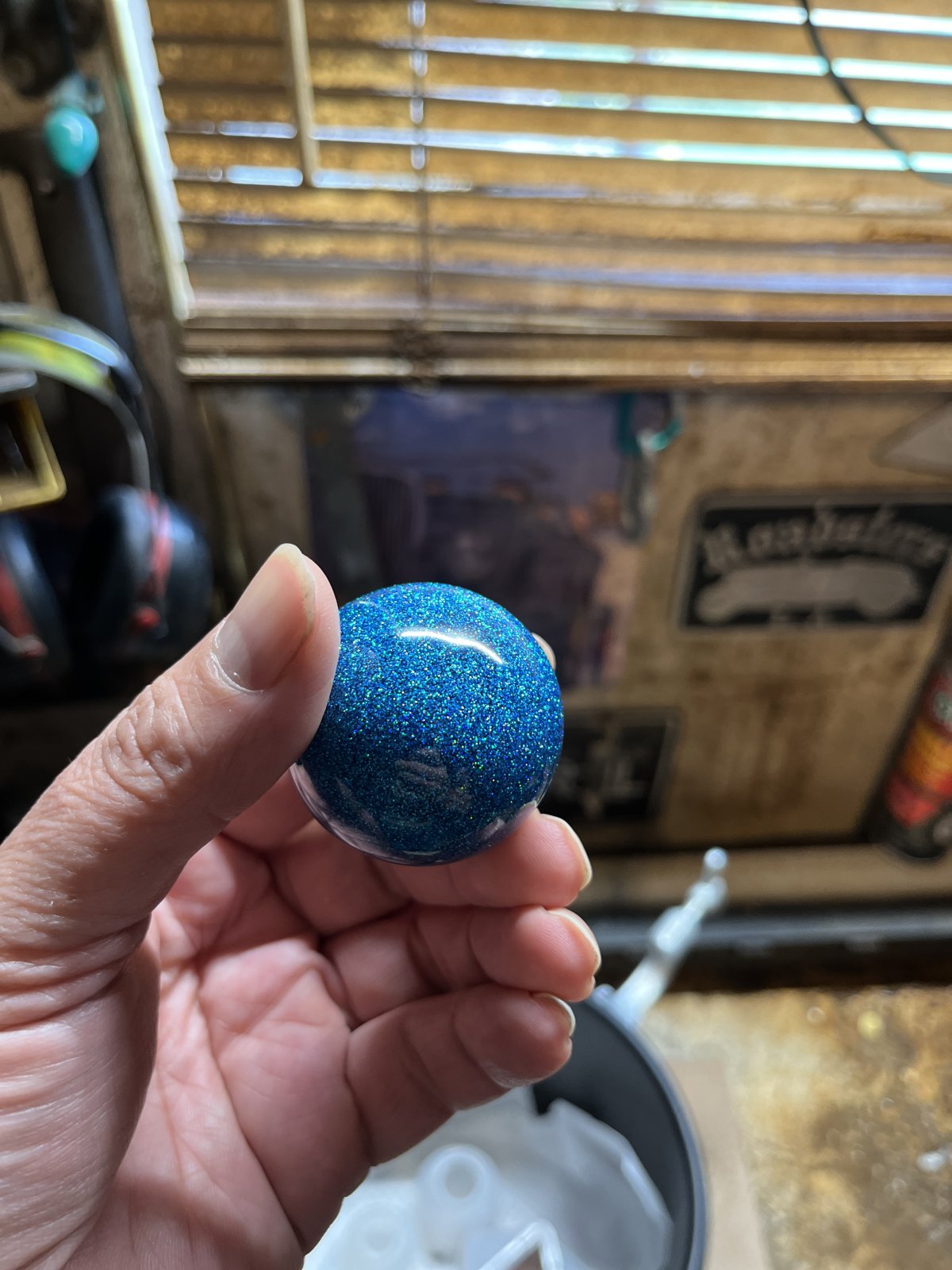

    I had my girlfriend pour me a test shift knob this weekend, she makes crafty stuff and saw this post on Friday.
    It's blue and sparkly, it'll look great in the sun. It shrank in the mold a bit leaving a spot on the bottom but I'll still finish it.
    5540444D-A029-4EBB-9904-F343CA4A9002.jpeg 5D2C34C8-2B40-4818-A23E-9B1625D6C95D.jpeg
    Hope the IG link works: https://www.instagram.com/p/Cp_BisbgIsA/?hl=en
    With the right molds she can do knobs, does everyone generally like them shaped like christmas light bulbs? How many knobs in a set?
    I'm gonna have her do me some more test balls. I think a buddy needs a copper flake one...

    that looks great! was it poured in a light bulb??
    Roothawg and hrm2k like this.

    She got a silicone sphere mold from a craft place to pour in from the top. A few actually, in different sizes because she wasn't sure what size they are. I've been bugging her about making a shift ball for a while but when I showed her there was some interest in this stuff she got excited. She likes crafting for the challenge/sake of it.
    I can help her make molds out of silicone so I was wondering about the dash knob shape. Seems similar to a C7 or C9 Christmas bulb shape so I was thinking about making a mold off those for her.

    metallic will not work with acrilyc it will separate i tried it !!!!
