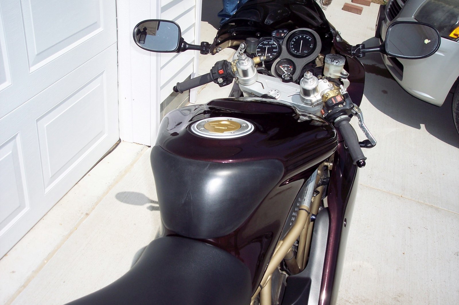

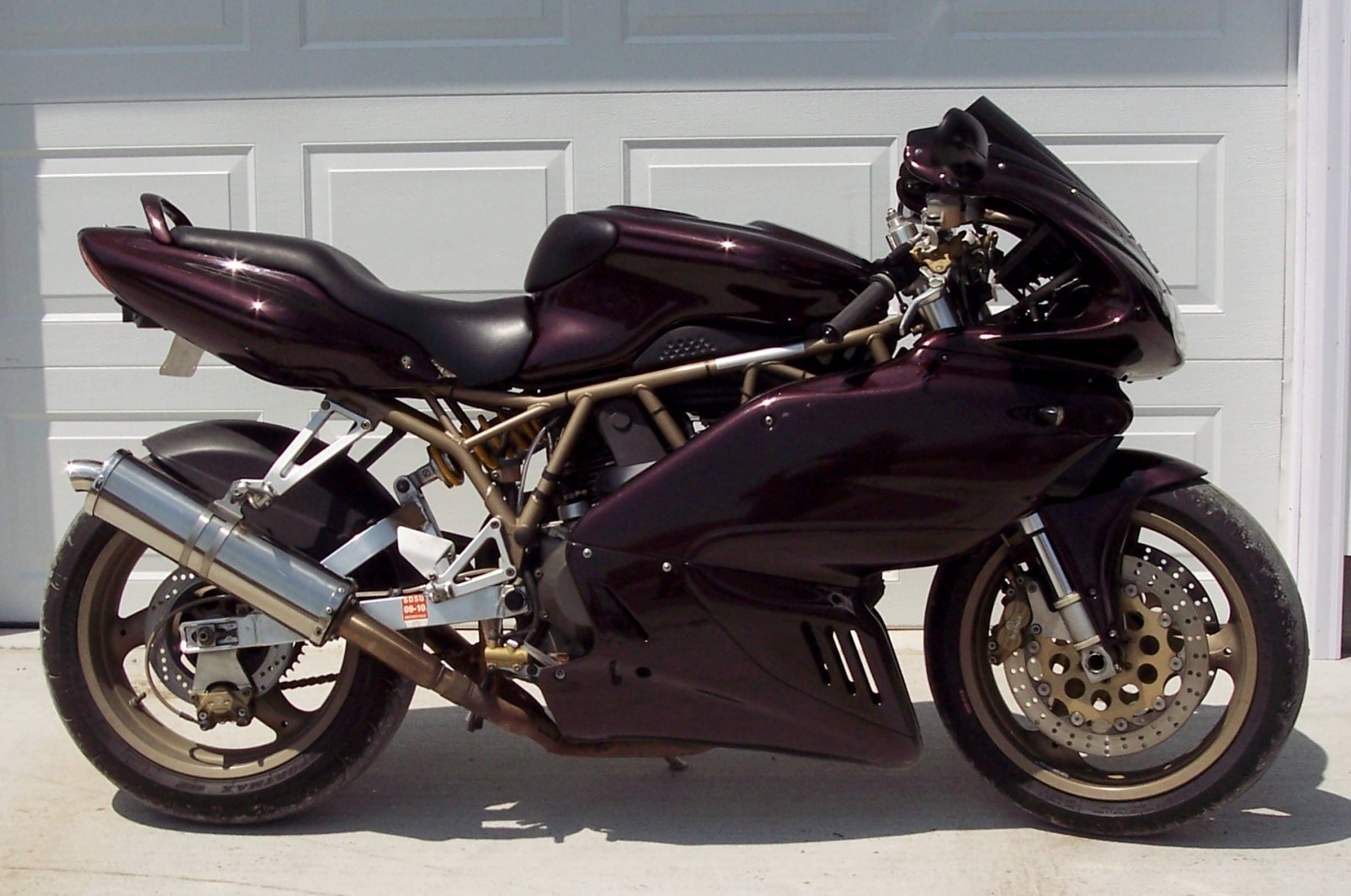

    The Ducati I painted was just last year, so I can't speak for how long it will hold up, but if it is cared for, washed and waxed regularly they all will last for a reasonable time while if it is left unprotected from the elements the best paint job will not.

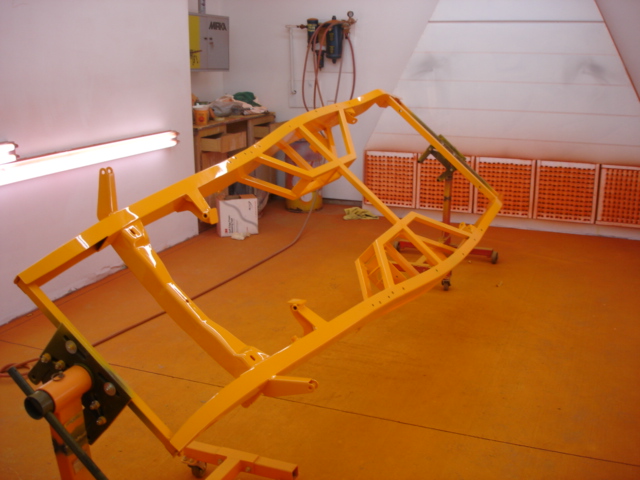

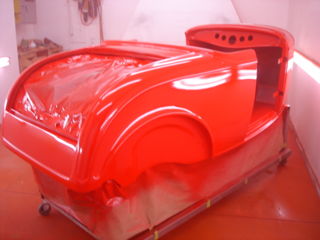

    32 roadsters build pics 135.jpg 32 roadsters build pics 085.jpg 32 roadsters build pics 087.jpg 32 roadsters build pics 091.jpg 32 roadsters build pics 106.jpg 32 roadsters build pics 109.jpg 32 roadsters build pics 134.jpg
    Try BASF Limco acrylic enamel with a hardener, flows and looks like Centari
