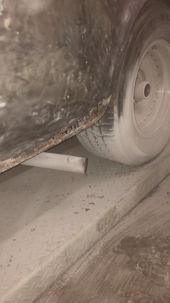

  13. dutchrod
    Joined: Feb 5, 2009
    Posts: 505
    dutchrod
    I need left and right side so if you can make them and send it to the Netherlands i like to know how much.
    Both sides from the door back to the wheel opening
    2CDBA70F-00D2-4E68-855E-BB300EF5DA56.jpeg DE6B3FA2-7E77-4F6F-8002-975371D19EC8.jpeg
  14. squirrel
    Joined: Sep 23, 2004
    Posts: 60,072
    squirrel
    use a brake to bend some metal to the shape of the door/rocker, then m***age the end to make it fit the wheelwell. Shouldn't be too difficult, for a skilled metal guy.
    Be sure to replace the metal up past the highest rust pinholes, so it won't come back to haunt you.
    dutchrod likes this.
  15. dutchrod
    Joined: Feb 5, 2009
    Posts: 505
    dutchrod
    I just ordered a brake and gonna give it a try
  16. dutchrod
    Joined: Feb 5, 2009
    Posts: 505
    dutchrod
  17. squirrel
    Posts: 60,072
    squirrel
    The contour at the bottom is not the same....
  18. You might be able to use a pair of 55-59 truck rocker panels and the leading edge of pair of stepside fenders to repair those areas.
    squirrel likes this.
  19. squirrel
    Posts: 60,072
    squirrel
    those were made with a brake, weren't they?
  20. dutchrod
    Joined: Feb 5, 2009
    Posts: 505
    dutchrod
    The rockers I can make on my brake , for the more flowing lines I can use the c10
    repair panel.
    Im not so skilled to fabricate everything from scratch but I will get there.
  21. squirrel
    Posts: 60,072
    squirrel
    It sounds like you have a good plan
