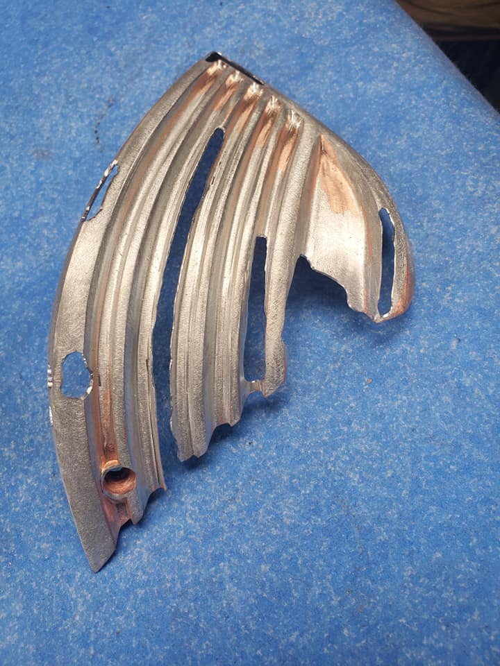

    I used to work there years ago. They fix some insanely wasted pot metal stuff, they're not afraid to take on really tough jobs. Here's a before and after of a die cast pot metal piece they fixed and posted on their web page.
    They've done some stuff for me and I've been really happy. They are not cheap though. The insane amount of work it takes to repair some of this stuff, and the crazy cost of the materials makes chroming an expensive job. If I had something I could not fix and could not replace any other way, I wouldn't hesitate to take it there.
    Their tanks are not huge though, if you bring bumpers there, they sub them out to Northstar in Minnesota (who also does fantastic work) and also they will not do wheels.
