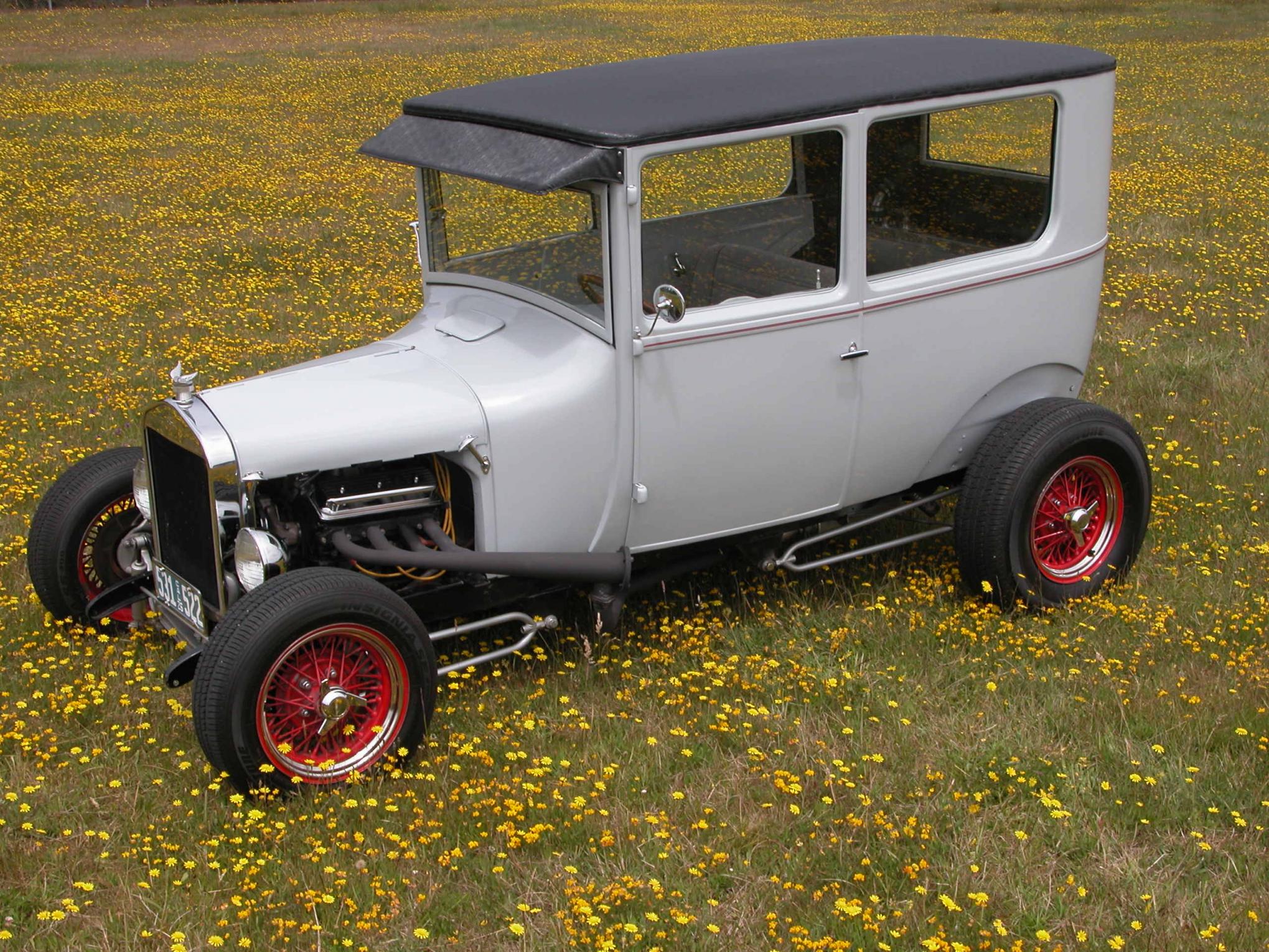

    How come so many model T coupe builds never seem to get a decent roof finished???

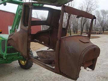

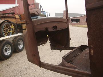

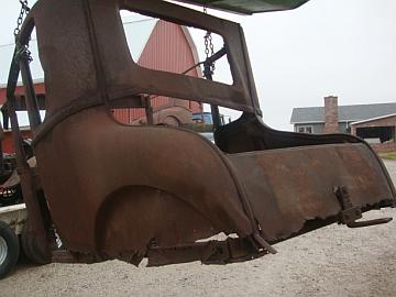

  12. RFAGrasshopper
    Joined: Oct 30, 2011
    Posts: 108
    RFAGrasshopper
    Well here is my start for my Tall T Street/Strip project. I bought this 1926-'27 coupe shell yesterday and will pick it up soon. I will also be ordering up Speedways '27 Deluxe frame as the platform for my build. It will come with the mounts for a 289/302 engine and a C-4 transmission. I will hang a 9" rear-end with a pair of Suzuki Samuri rear leaf springs with a Cal- Track Bar setup so it hooks good and is still street-able. The body will be channeled the depth of the frame-3" and I'll leave the top stock height for now. I will using a set of '28-'29 model A Doors(same as T) and making a plaster mold of both doors. Then I will make a set of fibergl*** doors with some steel channel for strength. The windows will go up and down on a strap like a lot of bracket cars do so there will be no need for a regulator and the window will be Lexan as will all the windows except the windshield. I will be using a reversed Ross steering box out of an older Combine so I can have cowl steering. my '27 coup body 1.jpg

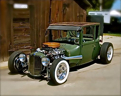

  14. kyle paul
    Joined: Oct 31, 2003
    Posts: 817
    kyle paul
    from sac
    the greet T was on a model A frame zed up front with a stock cross member , reverse eye spring and 4 inch drop axle . the rear was a 7 inch kick up with model a rear cross member and buggy spring . cant remember tire size besides they were 15 s . i have no clue where the green T is now .i do know the brown car lives in Germany now

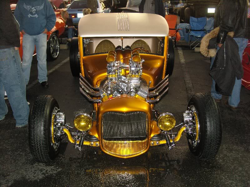

    does anybody remember what mag the gold car was featured in ? or more pics on the hamb !

    Rod and Custom....

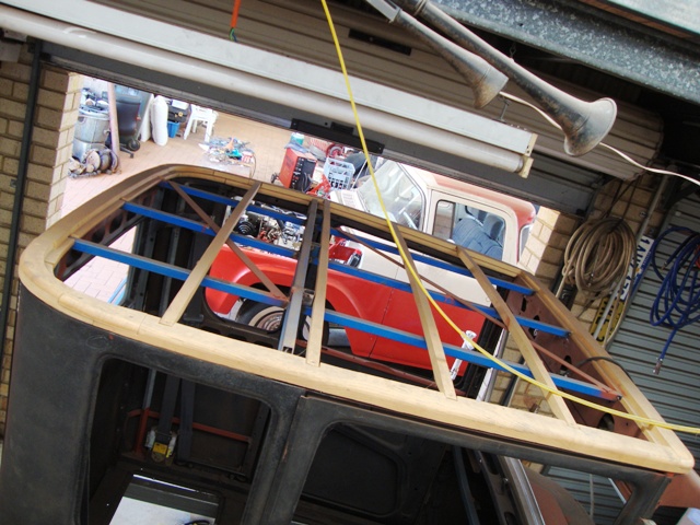

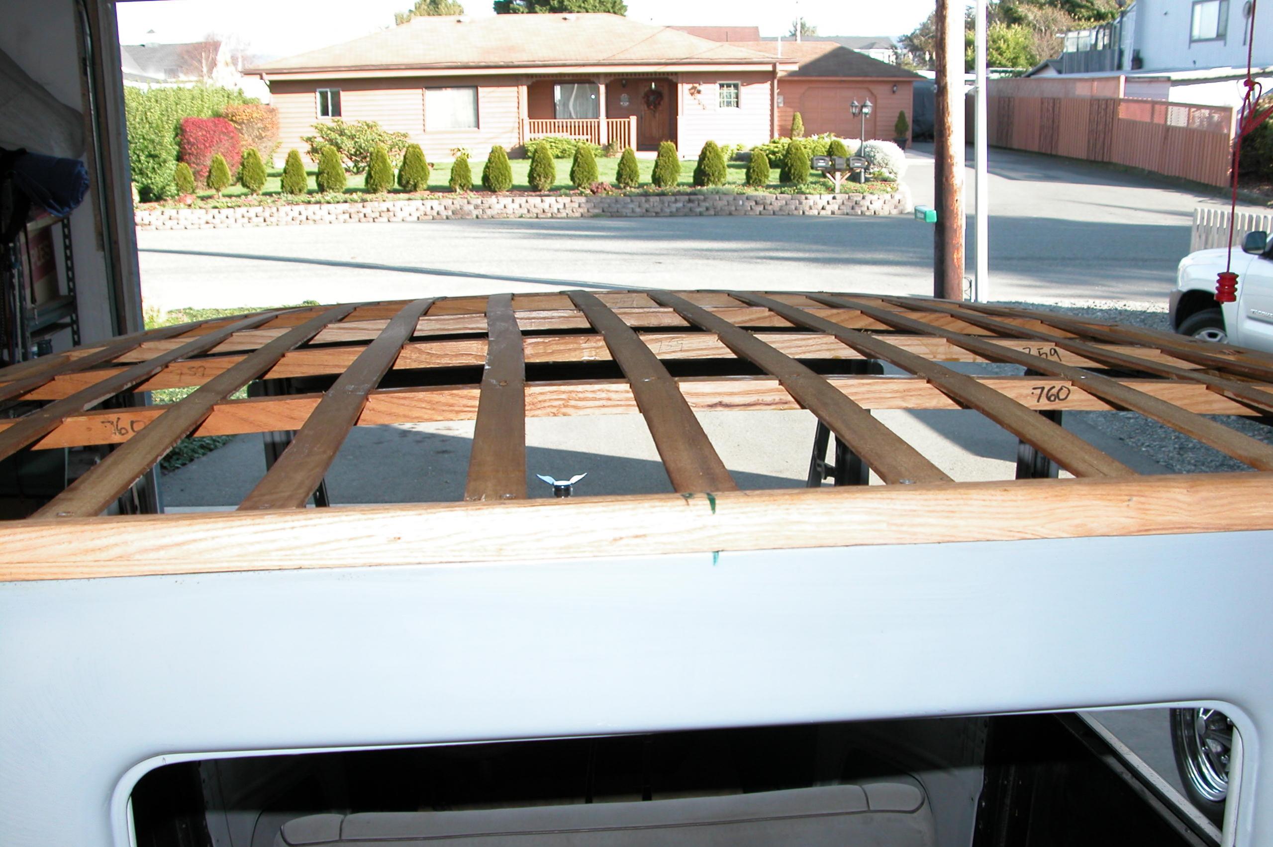

  25. Chaddilac, I used the wood kit from Fordwood.com, and the top upholstery kit from Mac's.
    After you have the wood side rails bolted into place, the cross slats go in, I notched my side pieces so the cross slats would fit flush... then, you stretch the chicken wire (and expect some bloodshed during that phase) stretch it tight, and staple it to the wood, and trim the excess. Then comes some muslin fabric, then the foam, then the top canvas, Mac's sells a vinyl that hopefully will last longer than the original stuff..
    A friend of mine and I did the top on my Tudor, and while it isn't a professional job, I'm pretty proud of the results, never having done anything like that before...

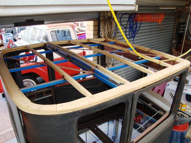

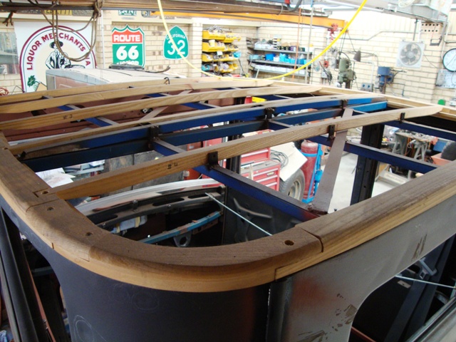

  26. fiftyv8
    Joined: Mar 11, 2007
    Posts: 5,401
    fiftyv8
    from CO & WA

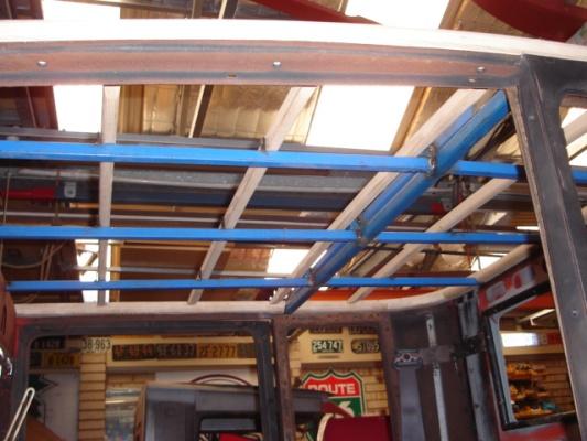

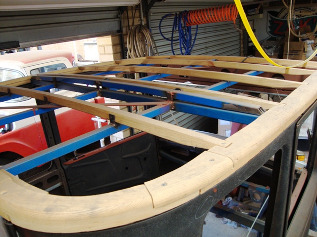

    I added some tube under the wood cross slats to help keep the body rigid and squared up.
    Probably over kill but just wanted to be sure.
    Not that clear, but if you have one you will know what I have done.
    Should make installing a hood lining easier plus interior light.

    chaddilac
    Whoa Cool!!!!
    Are the metal supports necessary??

    26Tudor and FiftyV8,
    Thanks for the photos of the wood kit in place. I copied them and added them to my Tall T Coupe file. It will be a big help when I get there.
