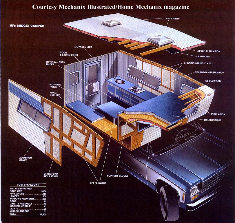

    Here's an idea we might be able to steal:
    If you look at thier wall, they used a single sheet of plywood to cut braces out of. Perhaps we could do the same thing with our roof inserts. We could cut some cross braces and the surrounding frame out of a thick piece of plywood. Then glue a thin, solid piece of plywood to the top of it for the outer roof.
    It would all be one piece so it would be strong, yet light weight. Less weight up top means better cornering and acceleration, if those are the sort of things you like. :D
    Fill the voids between the braces with Styrofoam insulation, just as they did, and then glue a headliner up to hide everything. You'd probably need some thin foam between the headliner and the wood to keep the pattern of the braces and frame from showing through, unless that's what you want. (You could get creative and cut out a "Ford" script, a spider web, a Rat Fink or something personal.)
    While I love the look of doing it factory original, just as Ford intended, this would be quicker, less expensive, sturdier and look professional. It would make it look a little "street-roddish," though.
    If you use fibergl*** resin to seal the plywood and Lexel to seal the roof insert to the steel, it would probably outlast the rest of the car.
    (Ace Hardware)
    I haven't tried this yet, so I don't know how well it will work. I just wanted to share the one-piece plywood brace idea that I discovered while researching tear-drop trailers.

    wsDAD, Could you post a link to what you're describing? All I get is a red X and I'm very interested in this. You'd need to get a sheet of plywood that's 5' wide because the T roof is wider than 4' (It is available - cabinet makers use it) but it would be quite heavy, specially if you used two sheets glued together. I was wondering about two very thin sheets with strips of 3/4" glued strategically between them and covering the top with convertible top material and the bottom with headliner material and I was going to install those little nuts with the teeth that dig into the wood in the top sheet,(The foam padding would hide the nuts) screwd to the top flange and a trim piece to cover the screws, but the foam idea sounds interesting, Thanks.

    This is a re-post. I got the picture to show up this time.

    I think that's just about what Jerry is going to do with the roof. I know he said the upholsterer wanted to lay in a headliner to cover the cross bracing. I'll get a picture for you when it's finished

    I am not much into wood work so it is all out of my depth.
    However, looking at what you are proposing seems do-able for the right skilled person.
    I think the main issues is trying to get decent curvature into the roof panel.
    Although it does not look much visually, I am sure it would still be a challenge to do in wood.
    Maybe a boat building skilled guy would be best placed to attempt something like that.

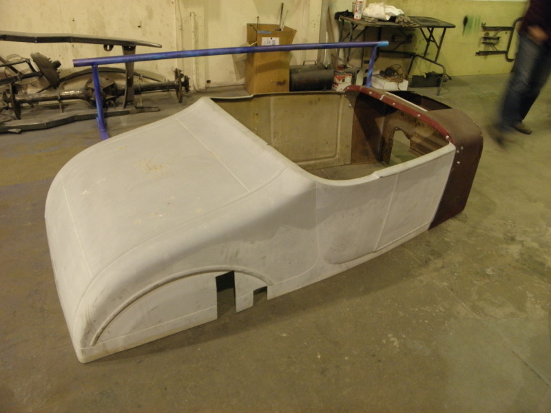

    I'm in the middle of trying to combine these 2 items.

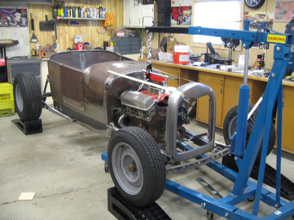

    Almost finished, here it is.
