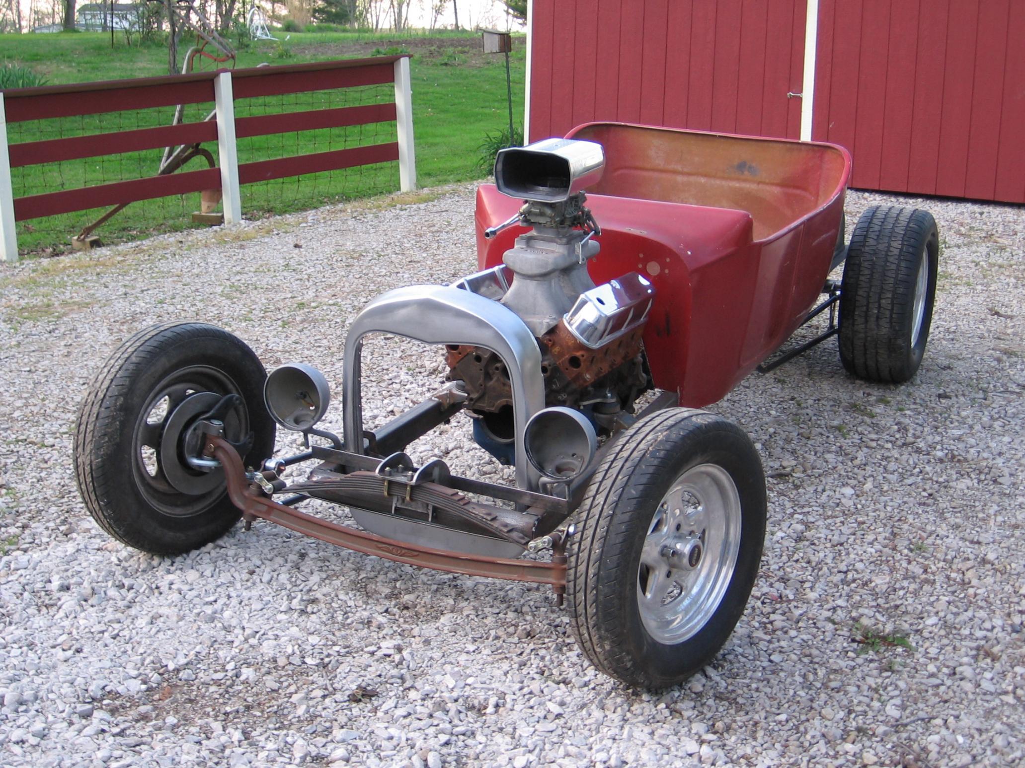

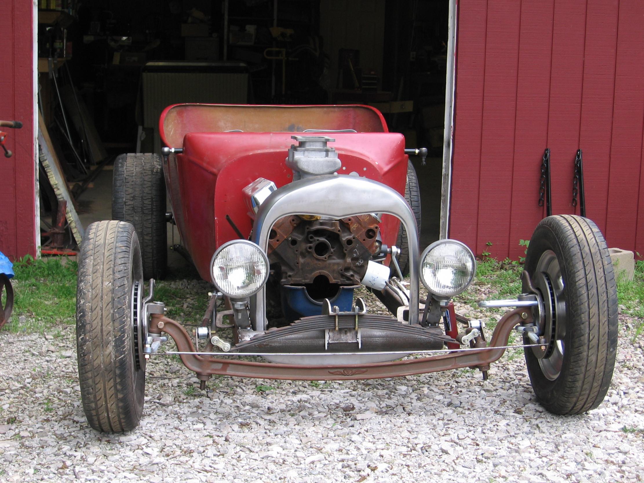

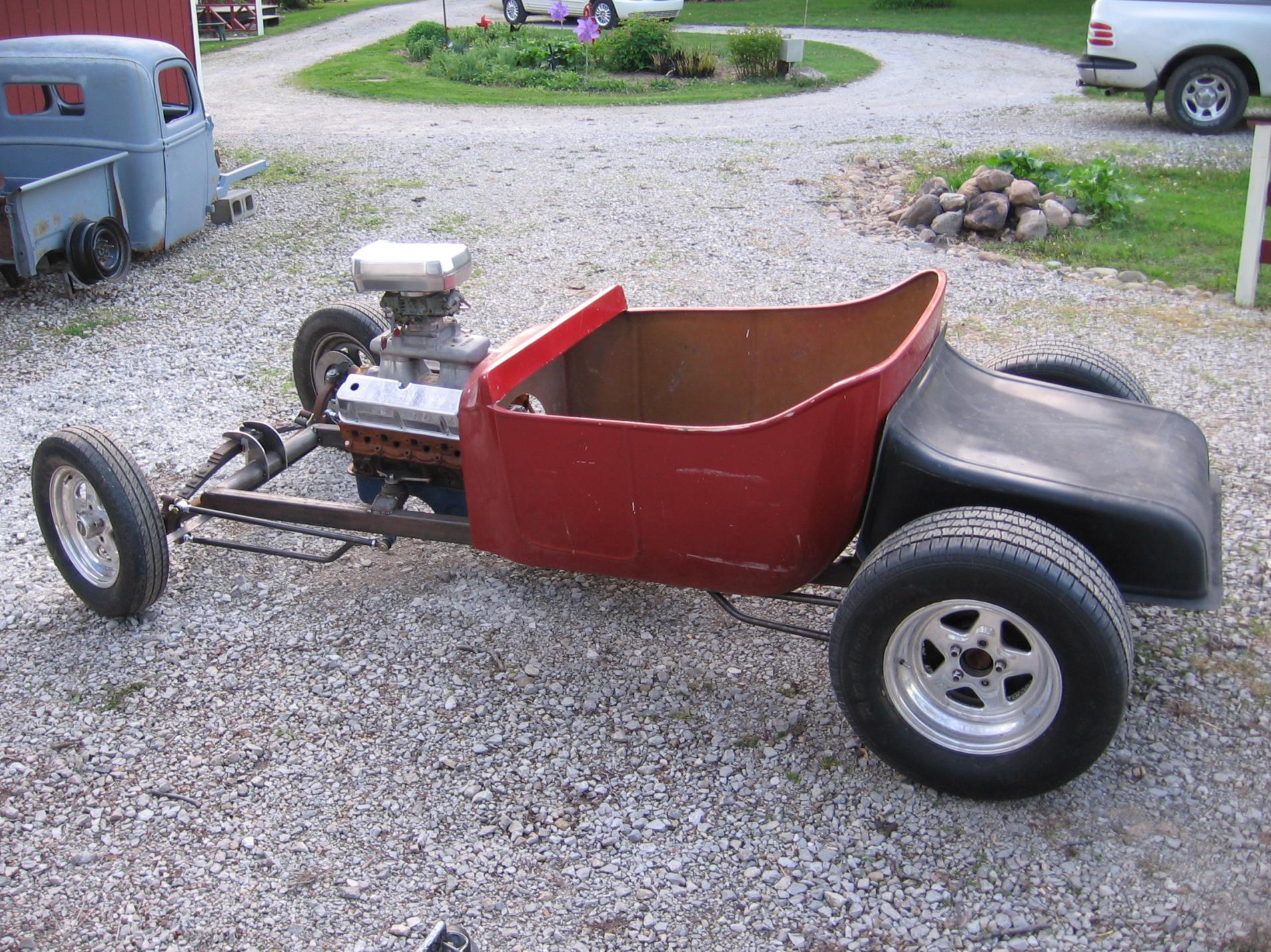

    Here is the current build at our house. I like the turtle deck but it has no storage. Maybe a 30" pickup bed? Where do you guy find room for the pedals, steering and your feet!! Waiting on the 289 and C4 to come home from the shop.

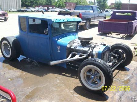

  3. Paul Windshield
    Joined: Aug 29, 2002
    Posts: 317
    Paul Windshield

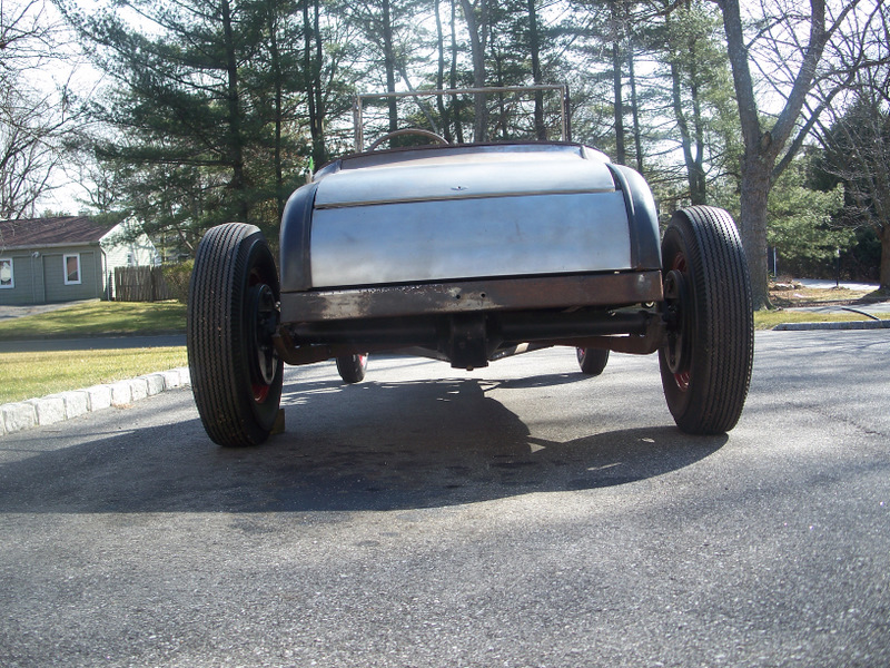

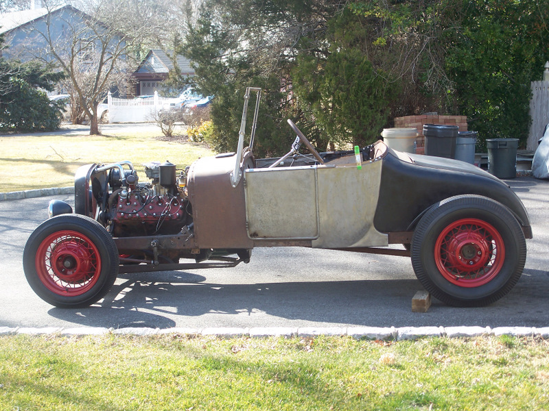

    Here's mine

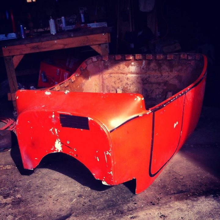

  4. NortonG
    Joined: Dec 26, 2003
    Posts: 2,117
    NortonG
    Picked up my body today!

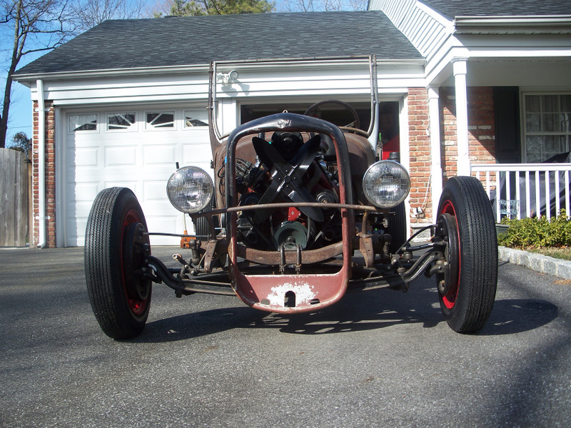

    Like the wheels and the riveted frame is bad *** too.
    Whats it out of?
  7. Johnny-B-Bad
    Joined: Jun 19, 2005
    Posts: 1,019
    Johnny-B-Bad
    THanks! Frame is '27 chevy with a cross members.

    Raise the turtle deck on the body about 4-5 inches, just about 1-2 inches below the top of the body.
    NOW you've got room for a 10-12 gallon fuel tank, a battery, and a few other things like a basic tool set(tune-up, lug wrench, etc), a tarp, some bungee cords, etc..
    Oh yeah you to add, to the bottom of the turtle deck, panels to make up the lower deck portion of your increased storage. An old style method was to use a pie-cut 2nd turtle deck.
    The feet thing is easy enough. Make up toe boards like "real" cars, and stock Ts, that put your feet at a comfortable angle rather than flat on the floor. Don't get crazy with the transmission hump in any direction, height, width, length. A clearance of 1/2"-3/4" is more room for YOU and your pedals and steering.

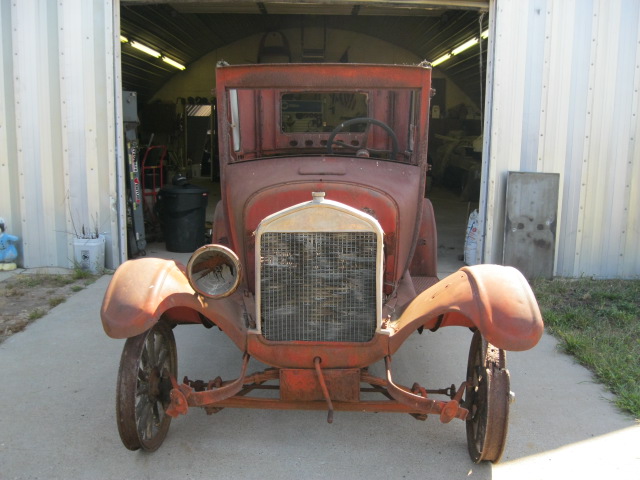

    Just picked up a 27 rpu basket case a week and a half ago and currently planning my ch***is as we speak.

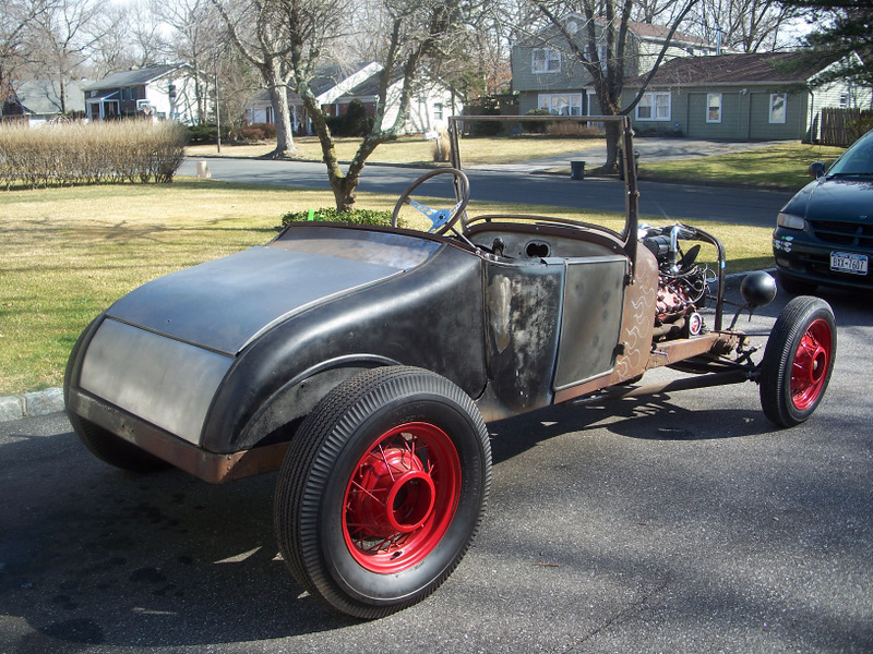

  12. jimvette59
    Joined: Apr 28, 2008
    Posts: 1,144
    jimvette59

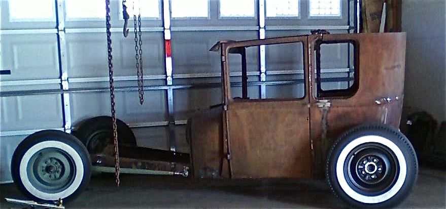

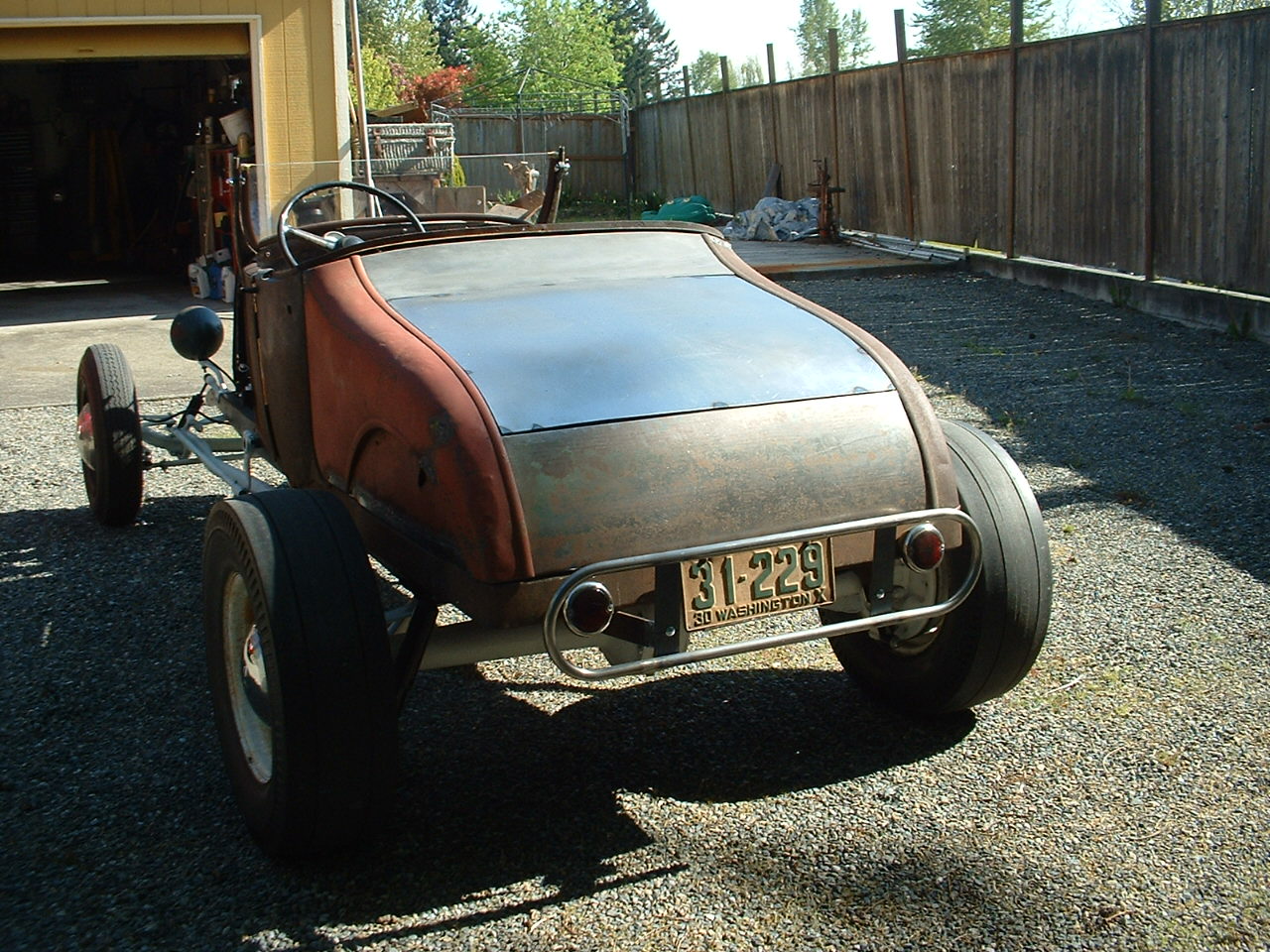

    Just mucking it up. Nothing is finished and I have a long way to go.

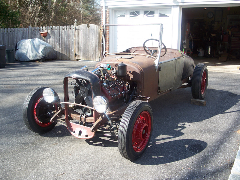

  15. 69firebird
    Joined: Dec 31, 2011
    Posts: 6
    69firebird
    from Wisconsin

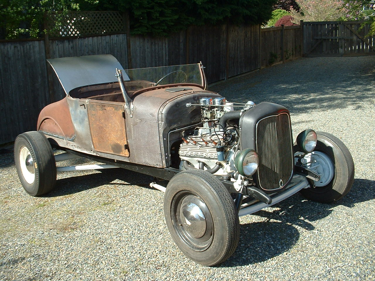

    Here are some pics of my 26 coupe project. Just got a 454 chevy motor and th350 ****** to slap in it. No choppin on this one.

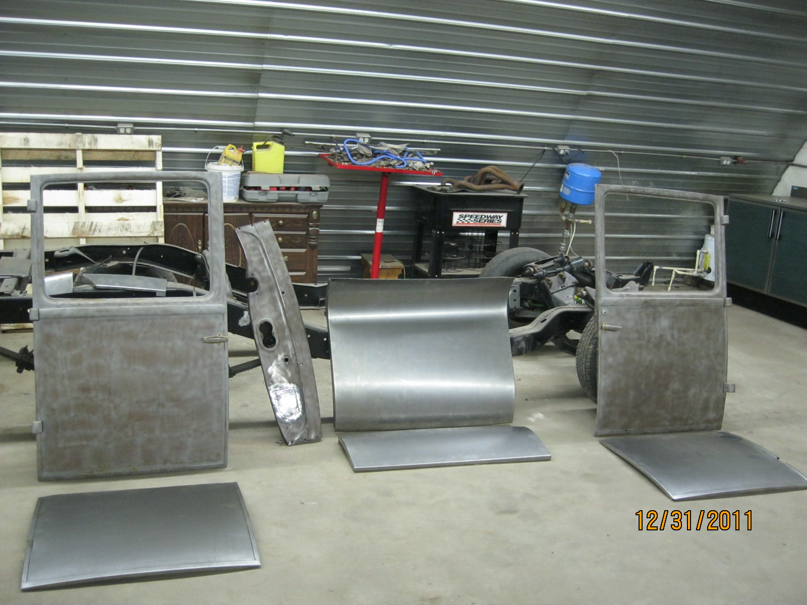

  28. daddio211
    Joined: Aug 26, 2008
    Posts: 6,012
    daddio211
    Okay, been watching this thread since the beginning and finally decided to throw mine in here too. A ch***is, '40 Ford axle and brakes, 9" in the rear. Built in the early 80's.
    I have a '57 283 with three deuces and a PowerGlide going in it, with a pair of Salt Flat Matt's headers! I'm going to use a pair of split '48 bones and do a "spring behind" moving the axle just in front of my A radiator. This way I can move the radiator up enough to get the SBC in it.
    When the car was built it had a HOT 2.3 banger and 4 speed built by Wayneat on here. Wayne and I have chatted, and know a lot of friends in common.
    Anyway, here's my junk....

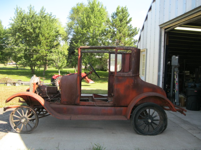

  30. I just picked up my first '26 T body. I have a million and one questions but you have to start somewhere.
    Not sure what motor and if I should run it on a stock A frame with boxing plates. I got a V8 60 with the car that has been rebuilt but sounds like it's not the best choice for motor.
