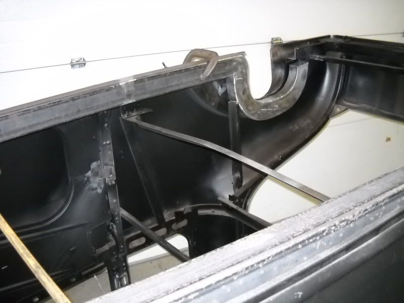

    Pretty simple - I just cut out the original floor and supports leaaving a flange about 2" wide all around the outside edge - it just happens to be about 2 3/4" above the bottom of the body so it pretty much hides the 2x3" tube frame.
    I think I posted these early in this thread

    Quite correct, I did check and you did post a similar pic, but always nice to have more. I am trying to get enough inspiration to do a channel job on my T coupe.
    Never done one before, so looking at work by others on the same model body is a big help.

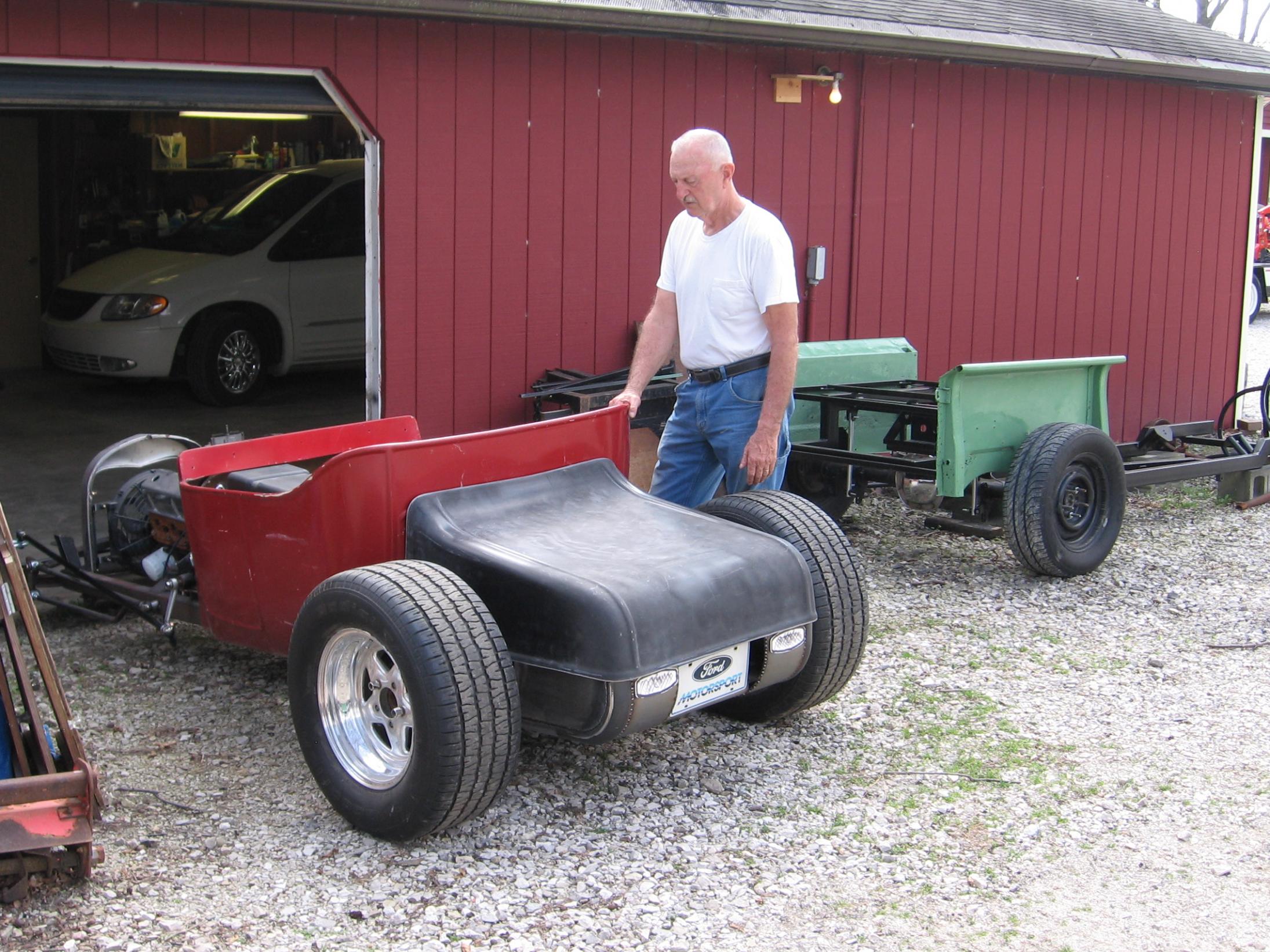

    Thanks for the ideas, I raised the deck and added a roll pan. Also reduced the size of the tunnel..Looks like dad is checking out the progress.
