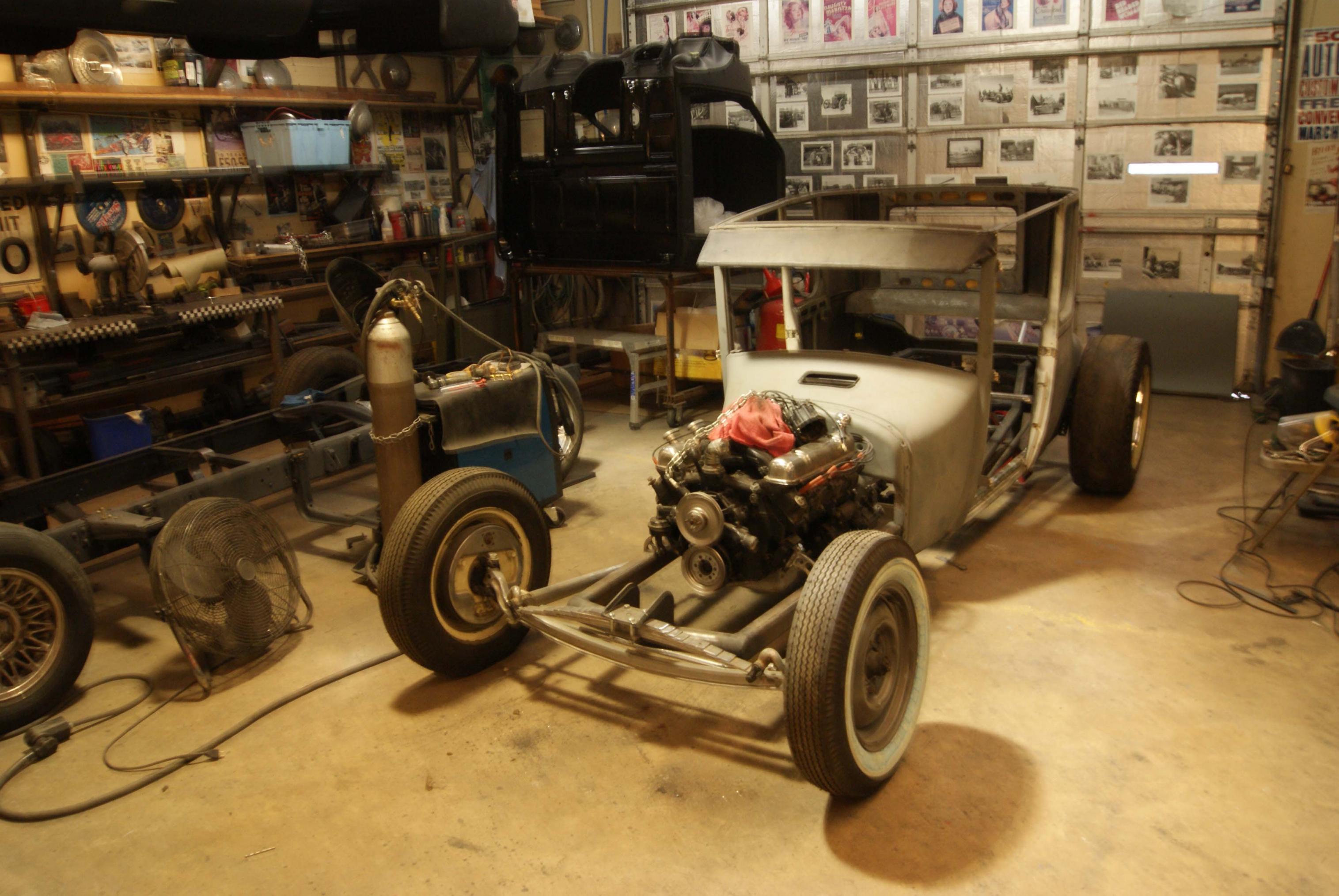

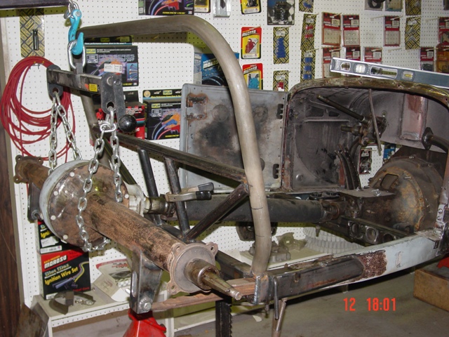

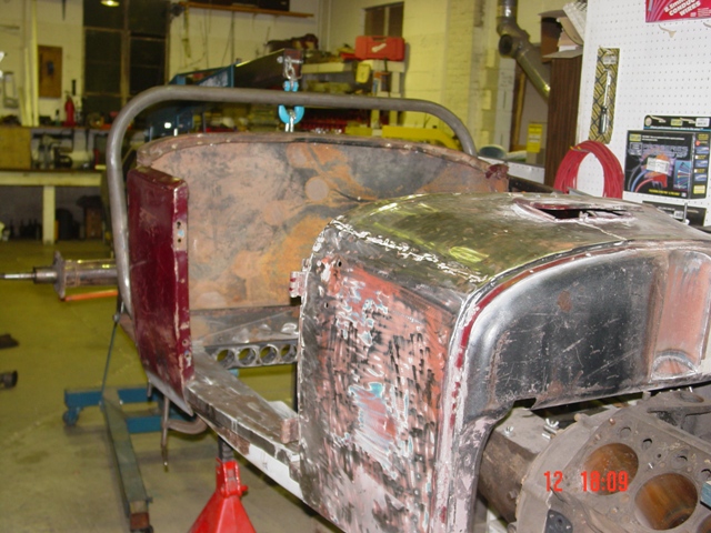

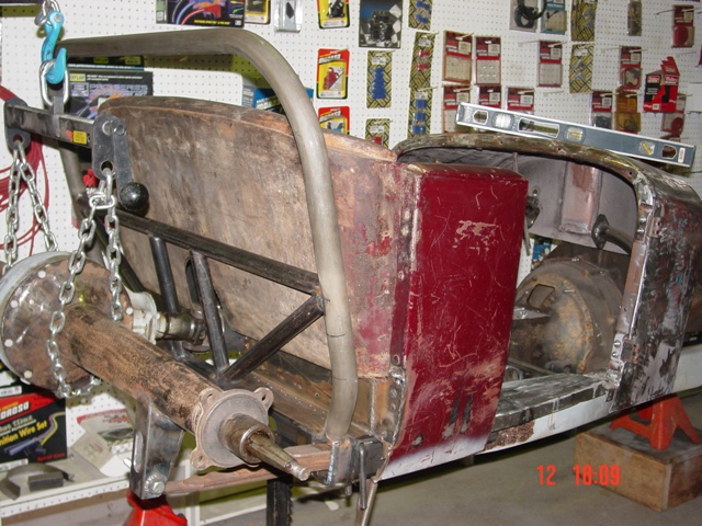

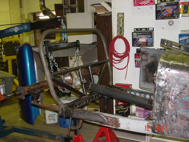

    I bent up the roll bar and welded it in and now i can make upper control arms to finish the suspension and hang the rear.
    I stuck a couple body panels up so's you see how it'll work together.

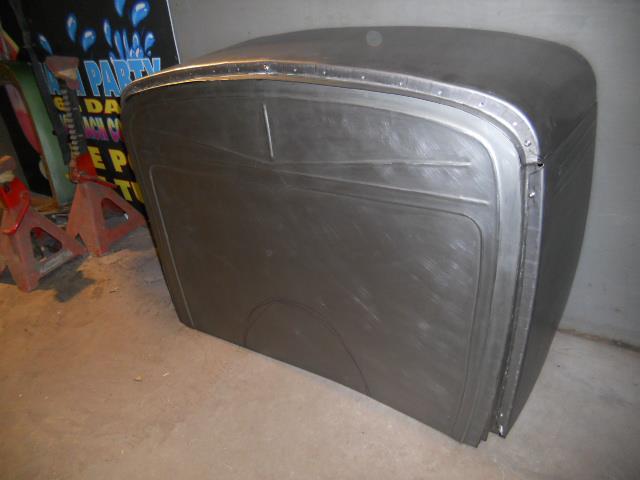

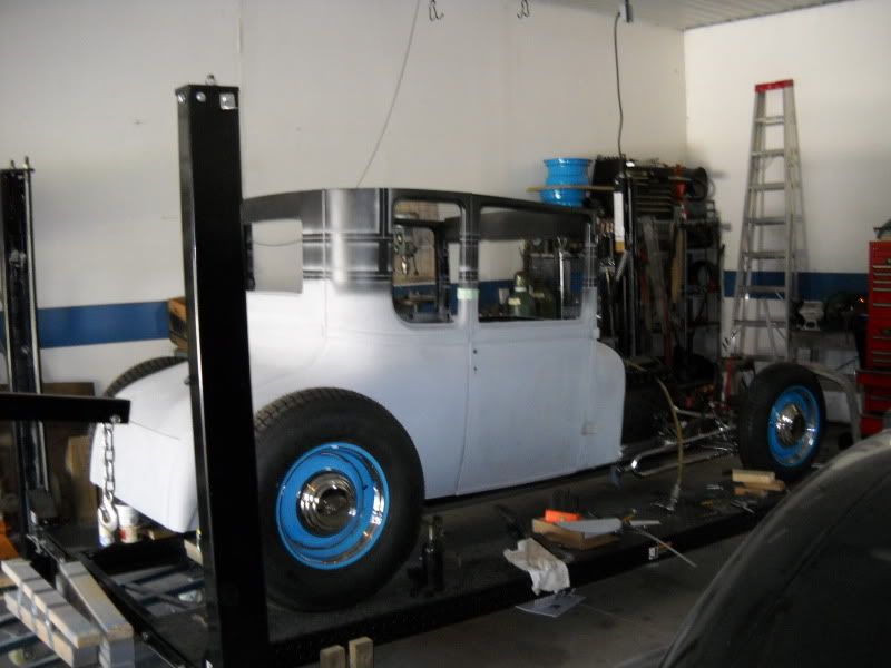

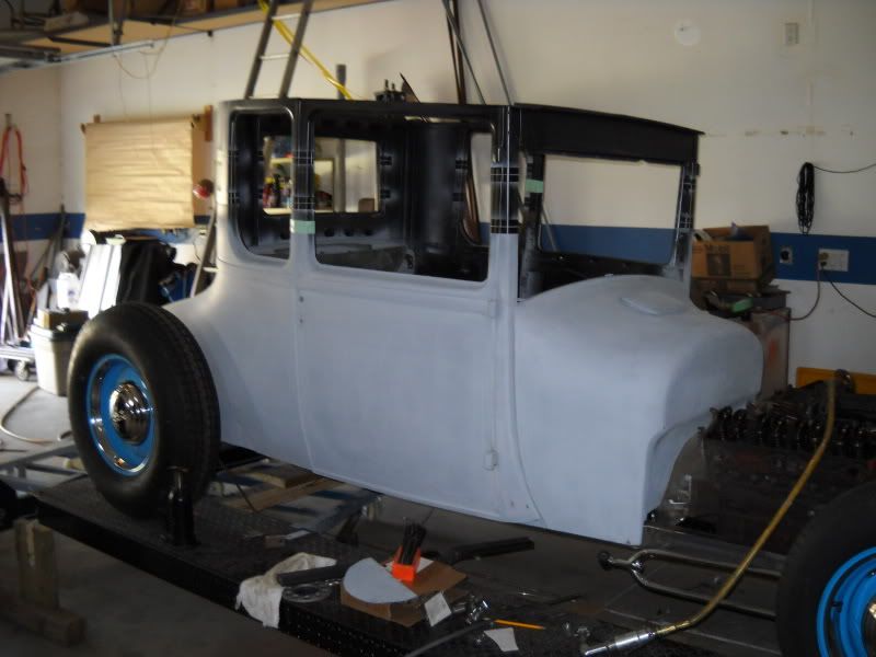

    I've been making a little progress with mine. The wife's still not well so it takes a lot of my time but the body is done and the frame is close. I reversed the rear rims to move the tires out away from the body a bit and the top is all layed out for the cuts - hopefully I can find the time to get moving on this thing again.[​IMG]
    I'll tell you one thing: Getting that repro decklid skin to fit right was a hell of a lot of work - If I had it to do all over,, I'd gladly spend a thousand bucks for a pristine trunklid! Question! Has anyone welded the "T" strip that searates the center rear panel from the quarters? I'm wondering if it'll weld OK or if I should remove the bolts that holds it all together and cut what I don't need off the top of the two strips.

    Looks great Ragtop. Sorry the wife's not doing well. The T is looking great. Love the stance and the wheels. Good work, man.

    Ragtop thats one sweet looking T,the wheel n tire combo and color are outstanding. What are the tire sizes? they look close to what i have on my RPU. VERY cool !!! JW :)

    THanx! The tires are Coker Excelsiors (not radials) and they are 5.00 x 15 and 7.50 x 16s

    Yeh, pretty much - my wife's improving a bit and I getting to spend a little time on it. The wheels are 15 x 5s and 16 x 6. I couldn't get the back spacing I needed on the 16s and had to take them to a shop that reversed them for me - I used to do that myself back in the 60s but rims were riveted and I wasn't quite so concerned about safety.

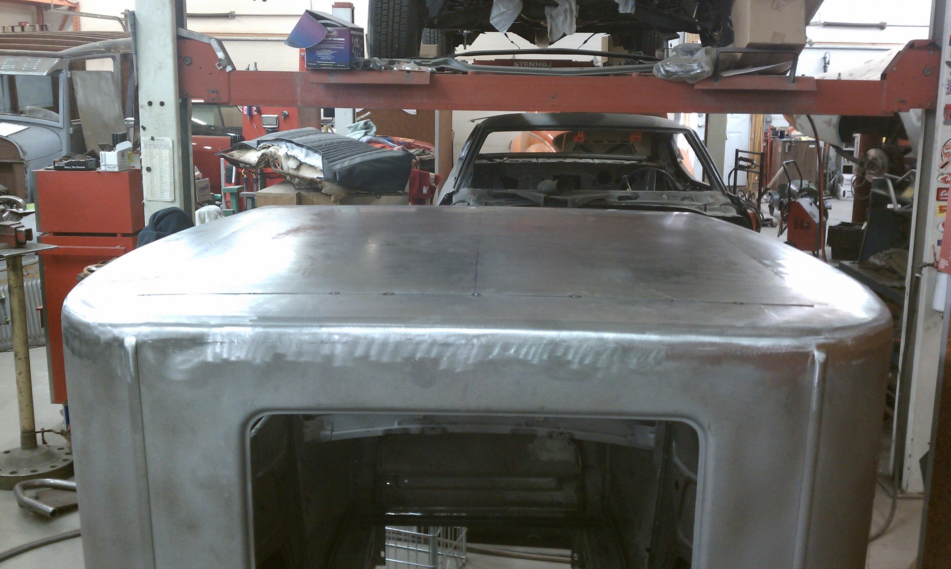

    Finally got my T coupe body home.
    Got a full steel roof made for it and a 29 model A visor.
    All metal work is perfect and just waiting for a ch***is.

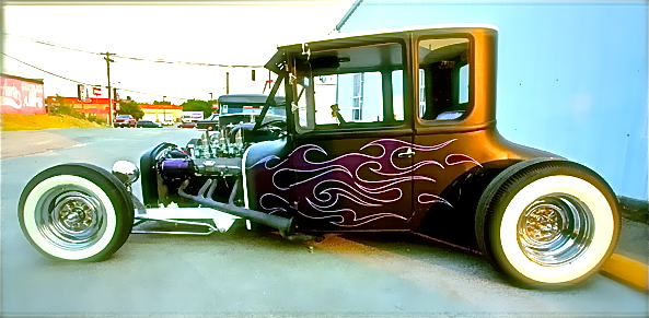

    My Mercury Charlie frame has a 13" Z in the rear. Here's a reference shot of the stance we're going for. It's Charlie's old T.

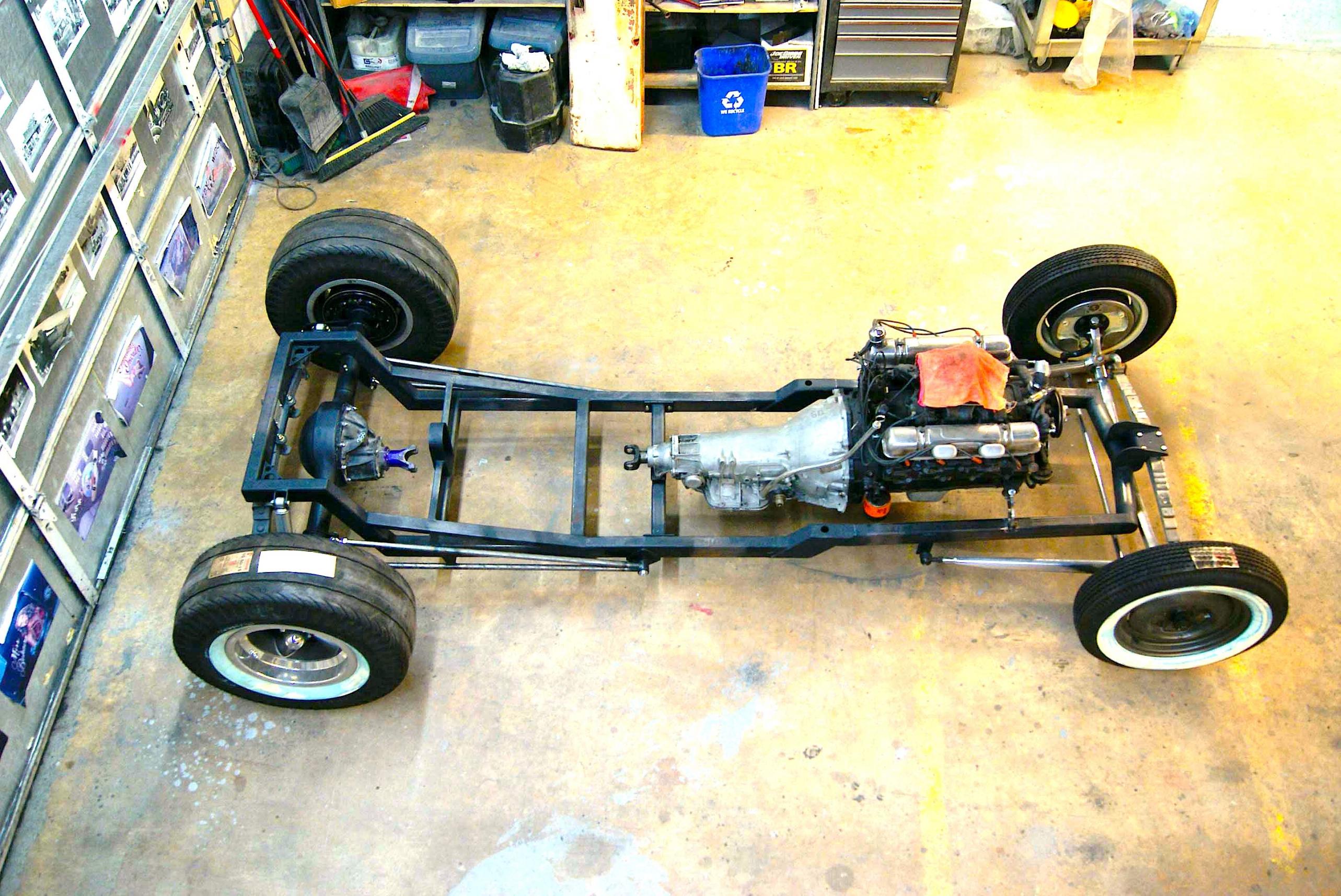

    Here's mine as of this evening...

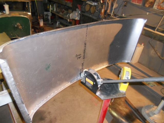

    Just fit the body to night.

    Cam, it looks great.
    How much clearance do you have between the underside of your frame and the tie rod.
    I have concerns about the tie rod hitting the frame on my build if it becomes too low.

    Thanks man. No on the swept rails, I'm not a big fan of them.
