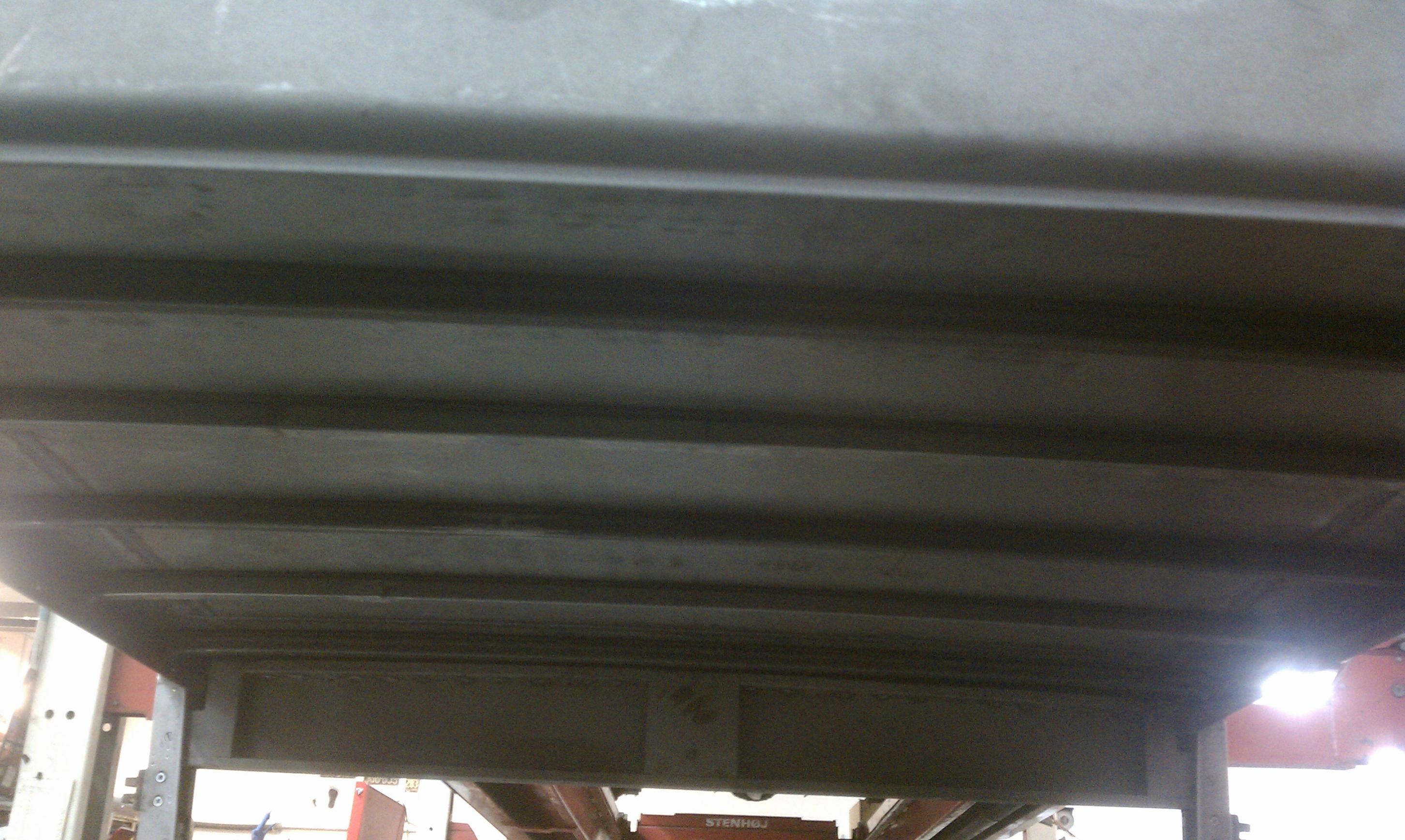

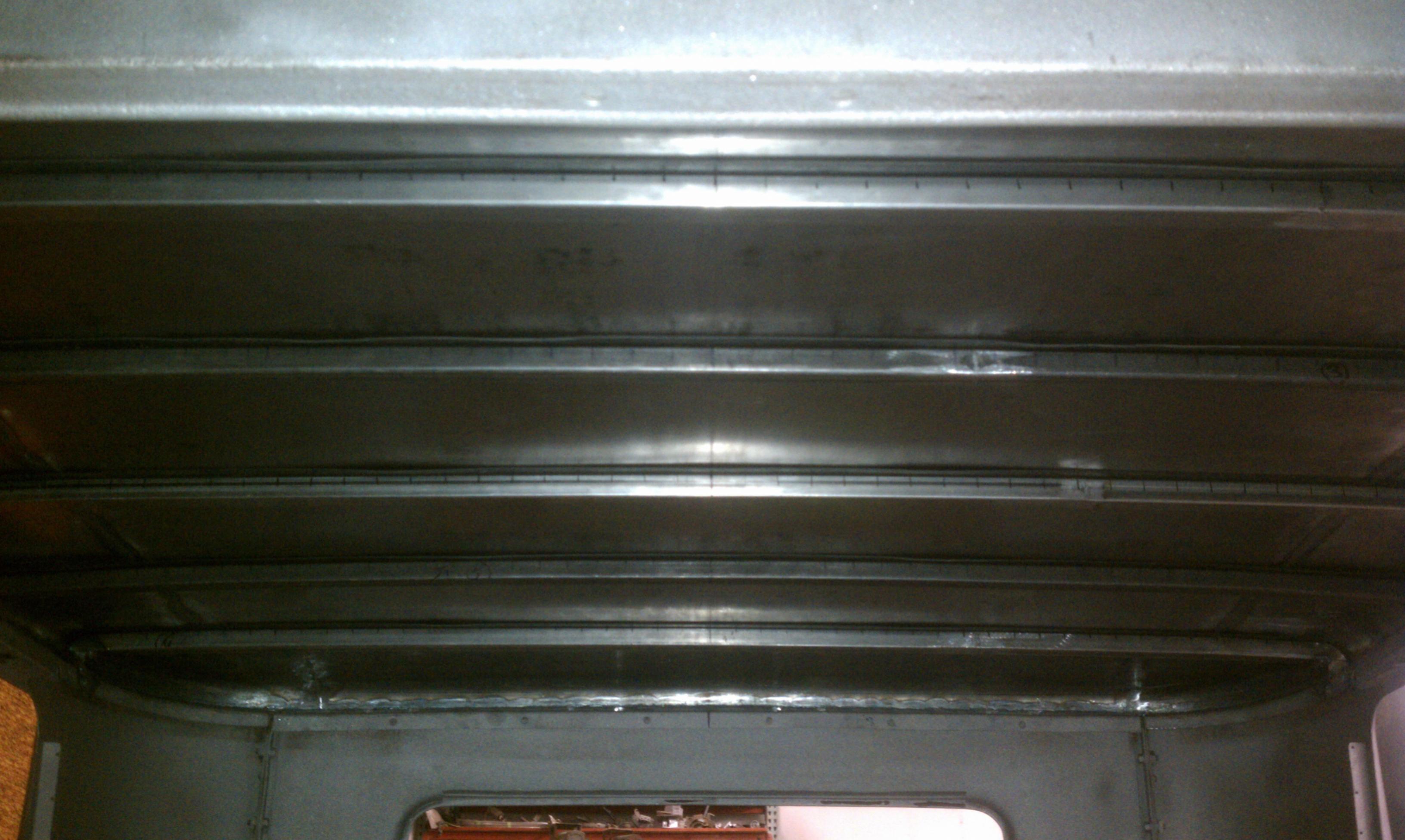

    Mine cost me dearly, but worth the wait and it looks good to me.
    Sure makes the body and door setting stay put.
    I'll post an inside pic of the roof later.

    Here are a couple of pic's of the underside of my metal roof.

    That would certainly be doable, you could have a solid and secure leak free metal top.
    What the all metal top would add to your coupe in structural integrity would make it more than worth the effort.
    Then have it trimmed to look like a soft top.
    The best way to go IMO.

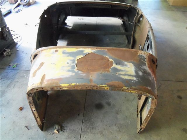

    why, right here Jared. haha I was moving into my house and shop this past month, need more space in the shop and mocked her up quick. The rest of my parts werent there yet, so thats why its like that

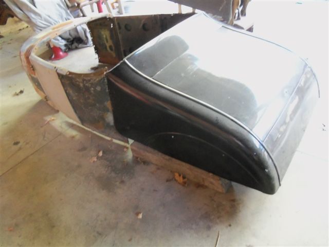

    I made my own 1/4 panel and rear panel under decklid....

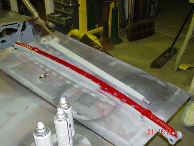

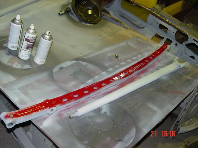

    I cut mine yesterday, primed it and started getting color on it today. Check out my bones, my pride on joy there. I figured how to cut a taper on the lathe and made bungs to go to a model 'a' bone 1 3/8 to male 11/16ths 22thread for the early tierod ends.

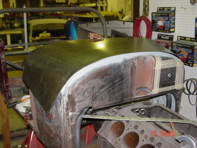

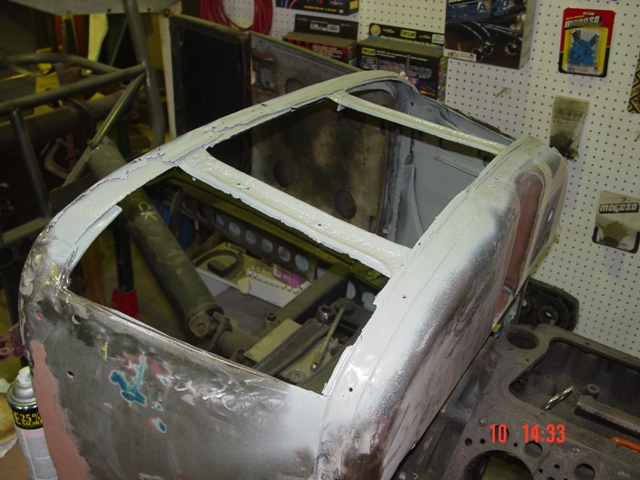

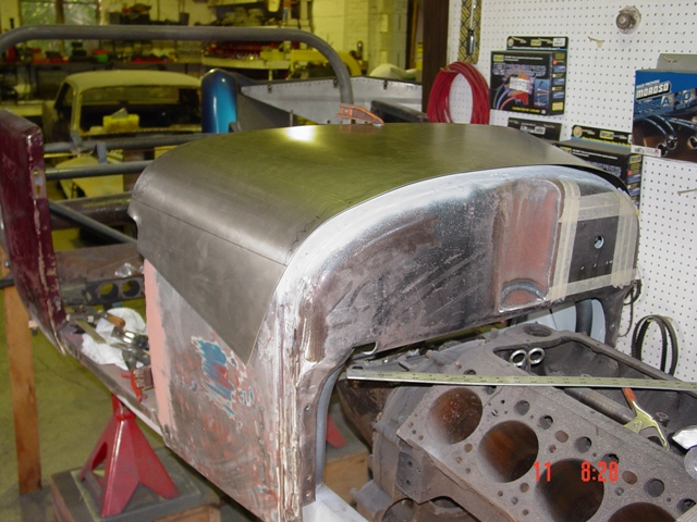

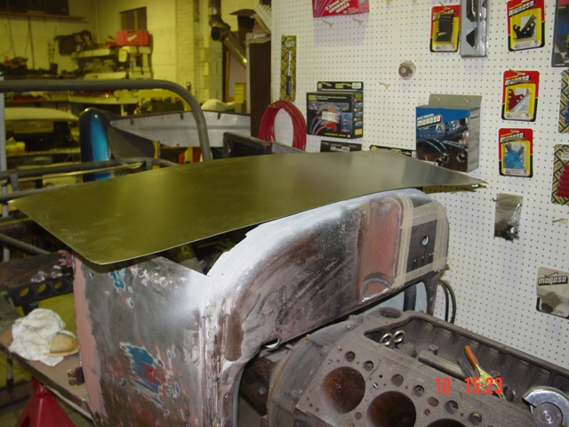

    I've started on the cowl sheetmetal as well. It had 2 layers of sheetmetal and i couldn't metalfinish it. They had 1/2" of mud in some places.
    Anyway i cut the old stuff off the top and have started metalforming the top section. These pics are a few days old and i have come along further - i had to make a tool to form the jigjog along the top where it turns down to the dash. I'll show that part in the next pics.
    This is the blank piece, 18ga, and how i creep up on the shape. I did all this in a slip roller. I started to roll a reverse curve along where the stancheons go but decided to hold off until i got the jigjog bead made along the top for the windshield.
  21. Cshabang
    Joined: Mar 30, 2004
    Posts: 2,458
    Cshabang
    Its only mocked up and had framing spikes for hinge pins, but yeah, they work nice so far..haha When i saw the body, I couldnt say no, knowing I probably wont ever find another one this clean
