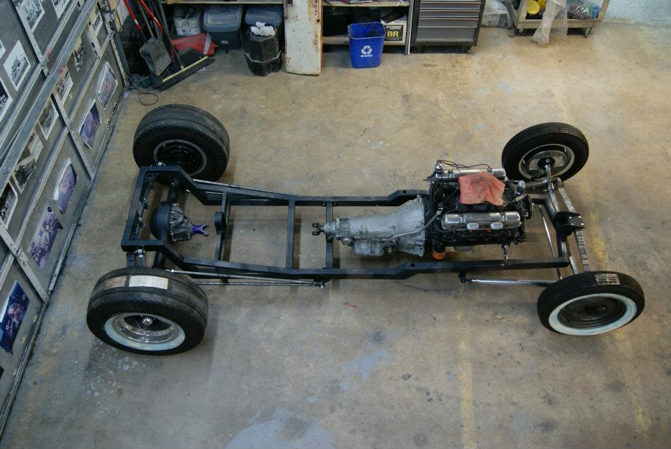

    here's mine. was thinking of doing a build thread since it's at the upholstery shop but didn't think anyone would care for it.

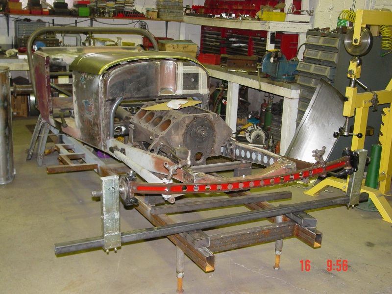

    I'm starting one...27 Touring front half on a bobbed '28 A ch***is. Going to run a '30 A motor, 0.060" over, Winfield SU-1R cam, Winfield 6:1 head, Winfield SR-B carb, Model B distributor. Ch***is will be shortened 12" zee'd 4" with a T rear spring and 32-34 front axle.
    Early mockup to check body fitment:
    Freshly painted head & rebuilt carb:
    Ultimate goal- Banger version of the Megugorac modified:

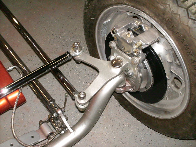

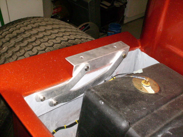

    I made the new tye rod adaptors for the early style ends and got rid of the newer type ends on the bones. I made them a little longer.

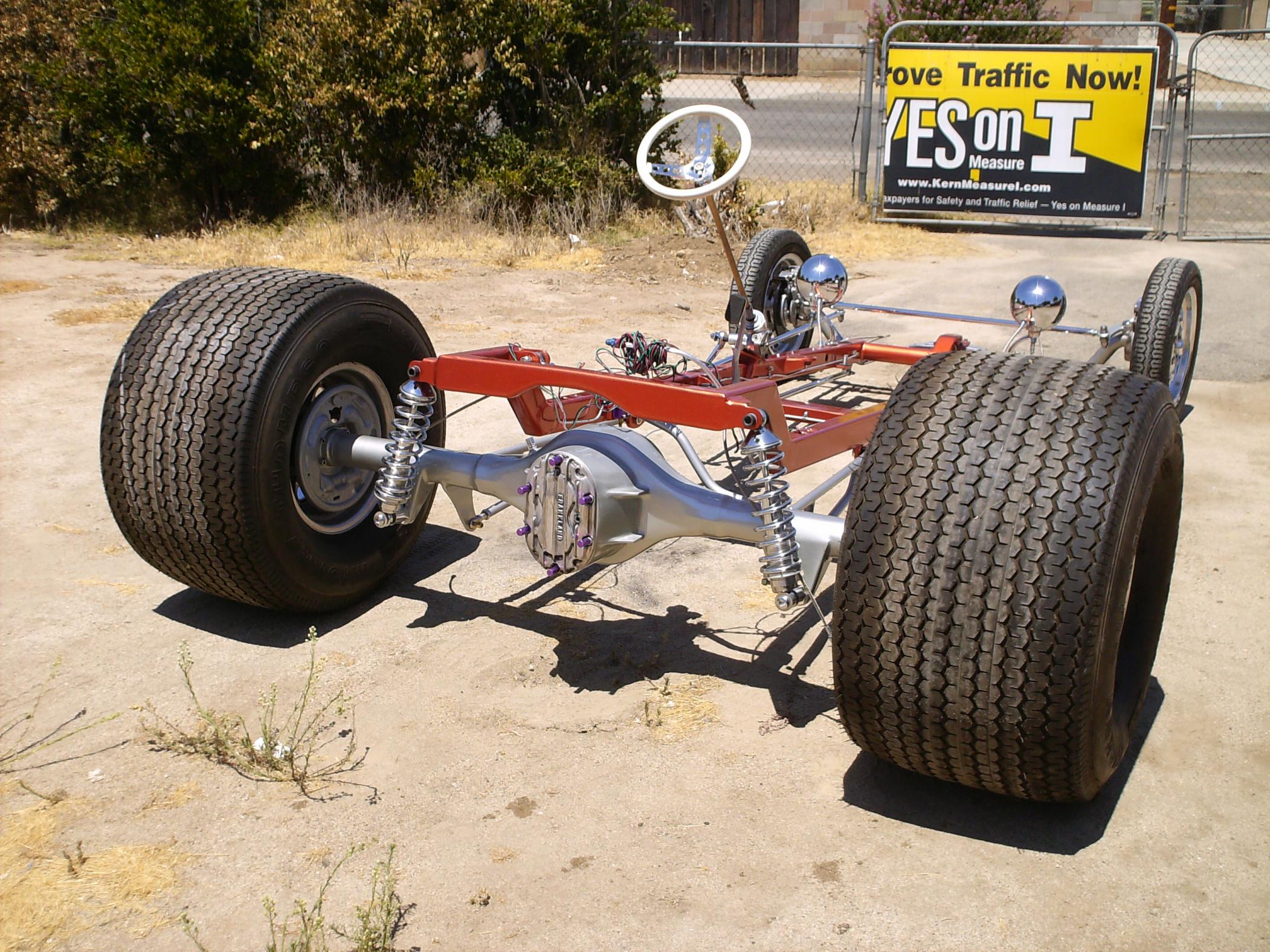

    I build all the ch***is. 2"x3" tubing. Wheelbase on this one is 102"

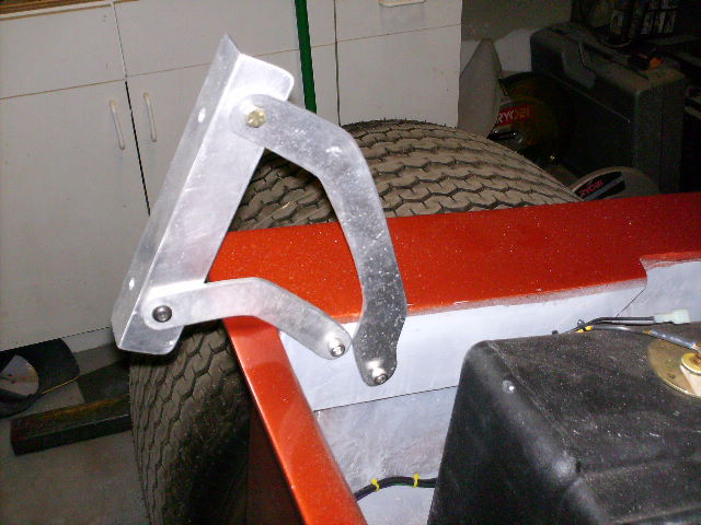

    More photos. This how im fitting bed cover with hinges. Will open like a car hood

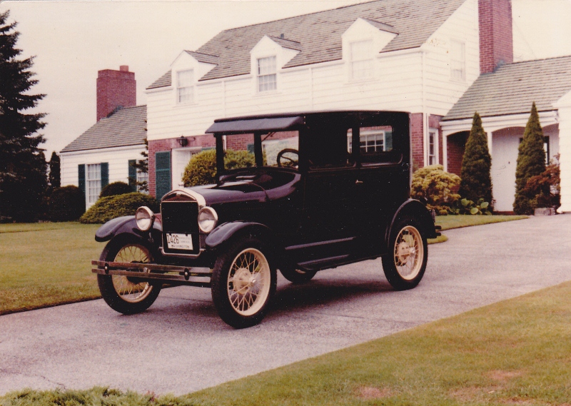

    My brothers 1926 T with a Buick V6

    Heres a pic of the new ends. I don't have taper attachment fixture for the lathe so it took me a while to figure out how to make one. There is a hamb member that makes very nice ones but the bore is different than a model a bone. You can see where where the other attachment point was, i have yet to fill the hole in.
    I also took a pic of the rear shackle, i'll add a zerk fitting to it. I'll use the same fastener/shaft for the rod end of the new lower control arm and add another tab/brace on the other side of the heim so it'll be double shear there as well. I am adding the lower control arm as a result from another thread.
